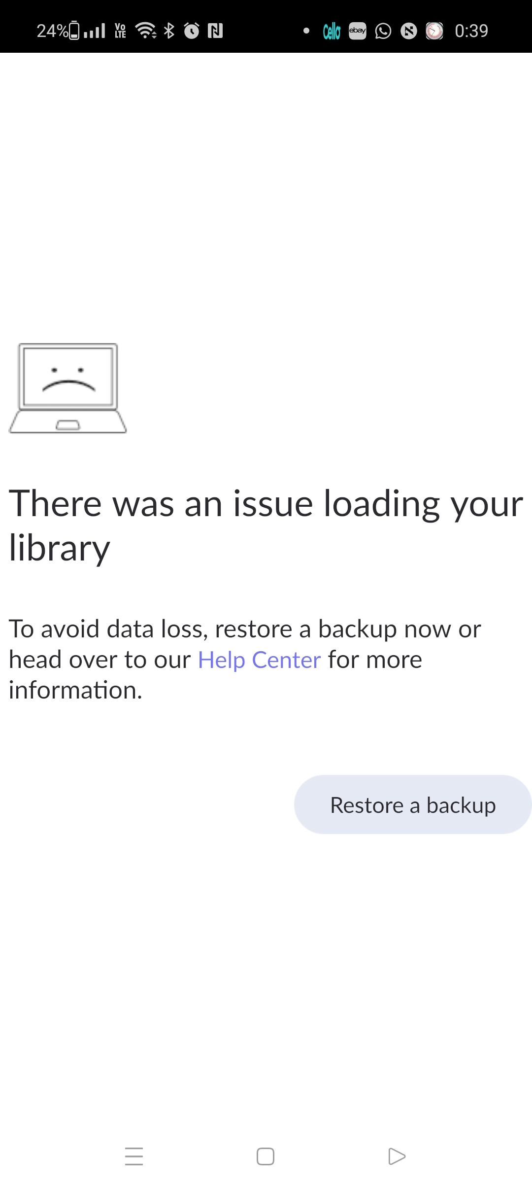

Hello,
I dont understand why roon app cannot work even if it does not find my music library.
After all, I am using only streaming services.
Having said that, I did tried to follow the instruction on yiu site regarding this error which recommended download and reinstall roon.
I am running roon on linux ubuntu.
After downloading the installation file ( I chose to install via the installer),I double clicked the installation file and it only opened for a view.
It seems it did not run.
Anyway, I restarted my linux based server and I still see that roon is active but the music library is inactive.
Roon app still shows the previous message "there was an issue loading your library"
I dont know how to proceed .

Hello @avico238 and welcome to the forum.
This has nothing to do with your music files (library) but with Roon’s application database (here called library too). There is guidance for this error available:

Hi @avico238 ,
I’ve activated diagnostics mode for your account and I can confirm that logs came in properly, I’m looking over the logs and I see that you have database corruption. You’ll need to follow the instructions listed in the endless loading guide or as per @mjw 's instructions, and reinstall Roon by selecting a new database directory, and then restoring from a backup (if available).
