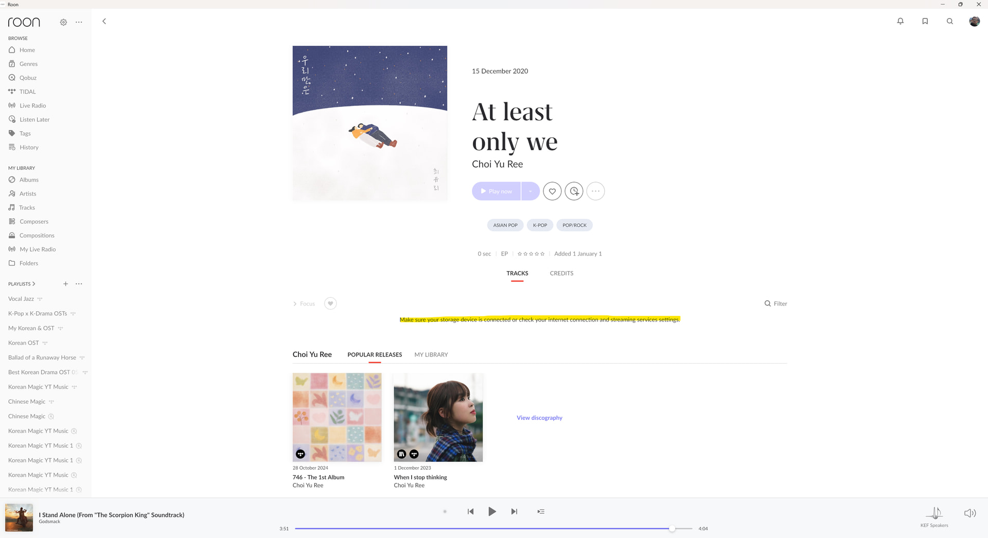

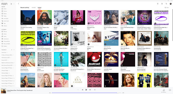

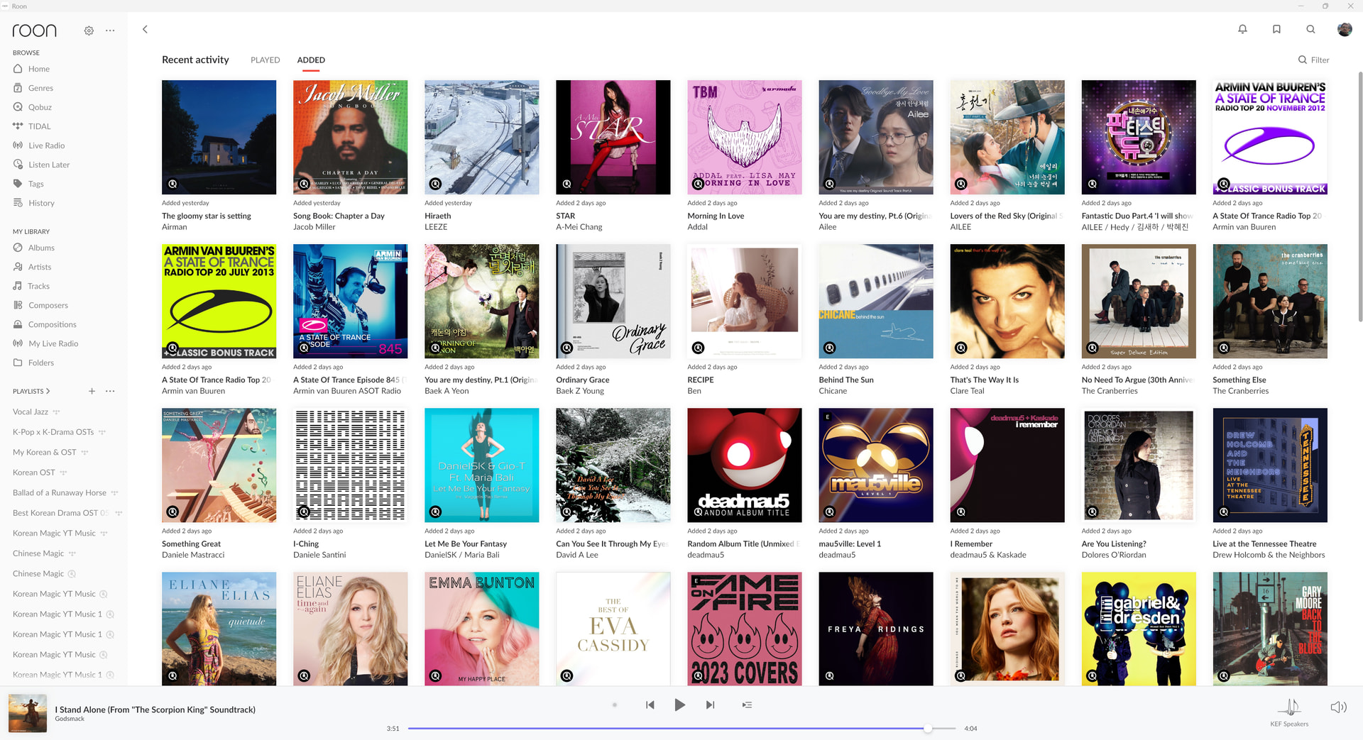

I have already done exactly what you mentioned several time and then some, For example, I actually went into the ROCK file folders and deleted all of them and reinstalled everything in addition to several times wiping off Roon Database & Settings via the Web UI. I am pasting the status
I did all this a few days ago and noticed by “Added” tab got reinstated immediately after i logged into Tidal and Qobuz…but only Qobuz adds appeared as you can see below.

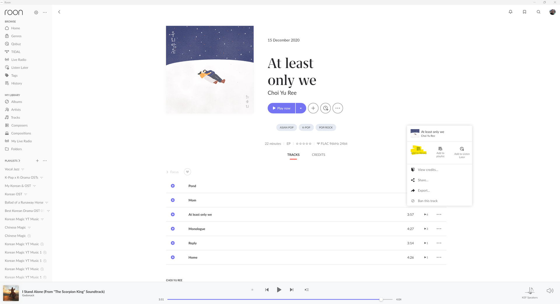

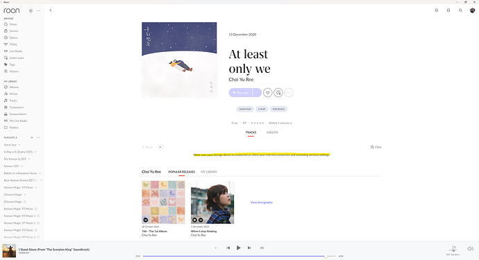

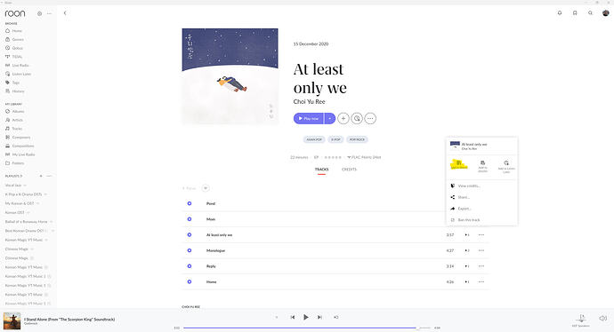

I will now again try to add a Tidal song to demonstrate how I try to add that to the Library and how the system shows its added but does not appear in the Added section and does not appear in my library as well.
This is how i add
This is the message I receive after adding which i think is an error message
By the way, I really need help with the Roon Radio bit as well. It does not show new songs often and keep repeating things from my library or just random stuff that i skip but that still keeps coming back in loop. We can do that in diagnostic mode as well.

Thanks for getting back. My issue was never not being able to play. It was that I cannot add any new Tidal tracks to Library and if you check my above screenshots, the ‘Added’ section on Roon Home only shows Qobuz adds and no Tidal Adds. The next screenshot shows how even though i can play any Tidal song, I cannot add those to my Library and get the error I have highlighted in the middle of the screenshot. Simply put, I cannot add any new Tidal songs to my library in Roon and that is my issue.
