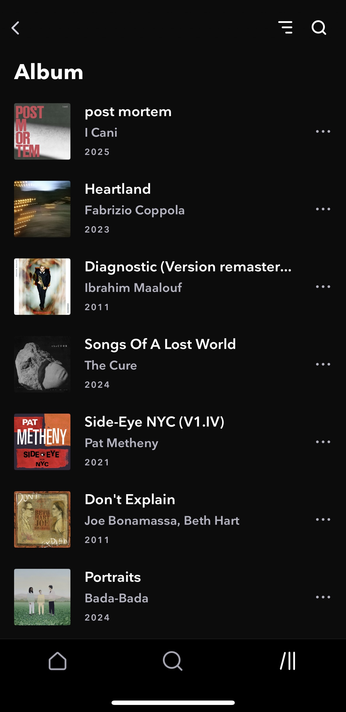

This is the third time I’m reaching out for support over the span of almost two years, but I’d like to point out that the issue has never been fully resolved. Basically, just like the previous times, when I add an album on Tidal, it only appears on Roon in some cases. But in most cases, it doesn’t. Not even after months. Not even with a manual sync.
Is it really possible that Roon is simply unable to sync properly with Tidal? Is the only real solution to give up on Roon and switch to another player?

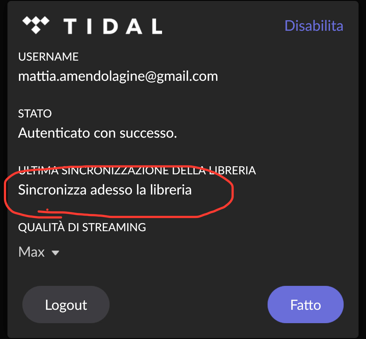

about manually sincing Roon report “Sincronizza adesso libreria” (Sync library now) , buy I cant’t click it or do something to really sync library manually.
