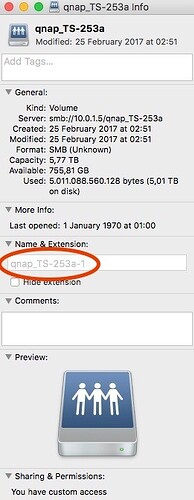

no idea how Roon mounts NAS shares, but happens in Mac OS that a share already mounted via, eg, AFP if mounted again via SMB appears to the OS as a “different” one in which case, using “Get Info”, you’ll see “-1” added at the end of its name

doesn’t matter: it might have been, sometimes in the past, mounted via AFP too (or some system process might do it sometimes without you being aware. Time Machine maybe?)
look the final “-1” in this share’s “system assigned name” (I only see it there: on my Mac’s desktop there’s no trace of it!): it’s mounted via SMB only and I rebooted this Mac a few minutes ago:
and it might revert to just the “plain one” sometimes in the future
this has caused me issues with both iTunes (missing files) and Audirvana (rescan from scratch) in the past: that’s why, on the NAS I only use for music files, I keep only SMB enabled
do a “Get Info” on your NAS’ share and write down what’s in “Name & Extension” then keep using Roon
