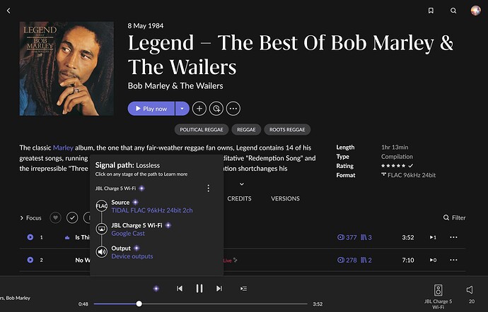

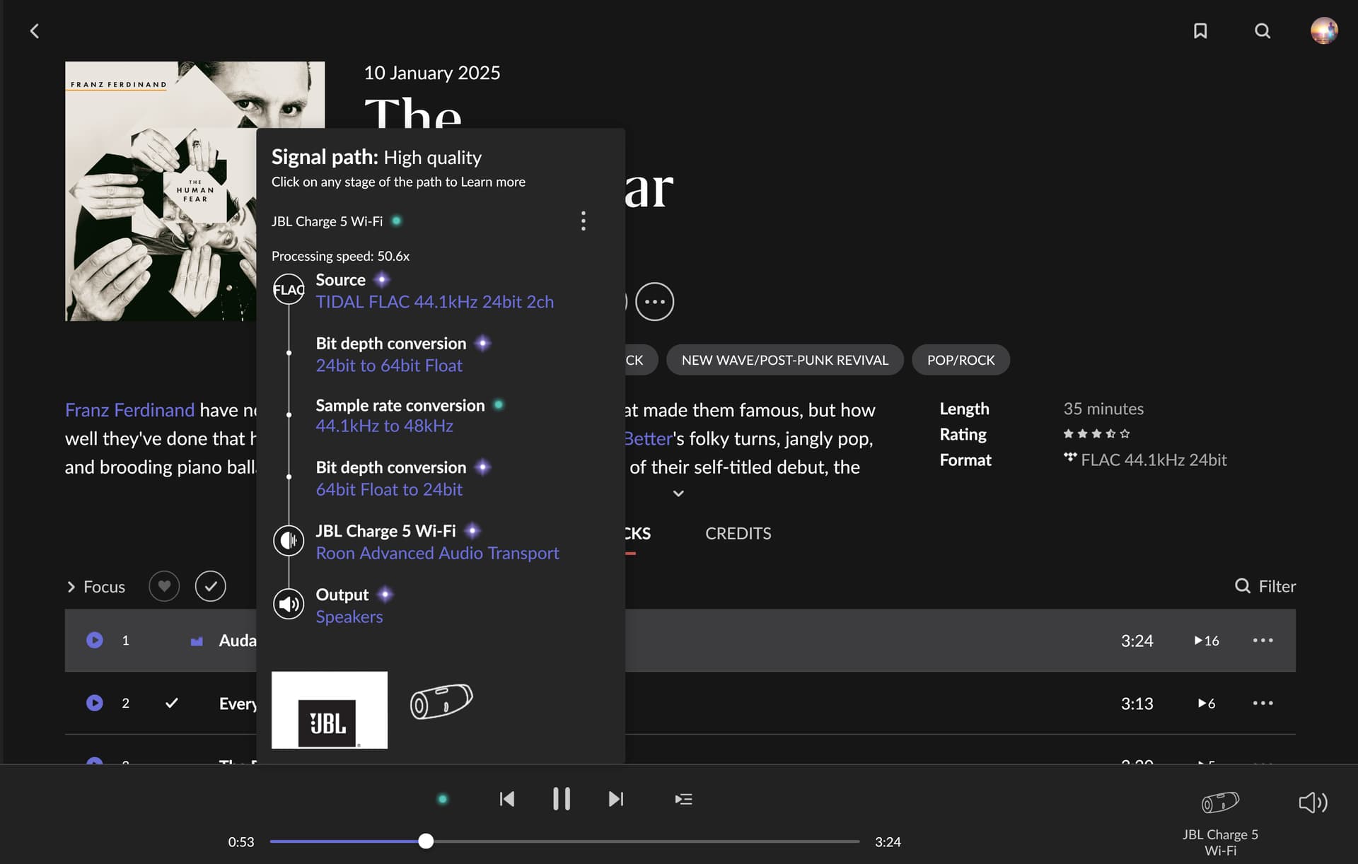

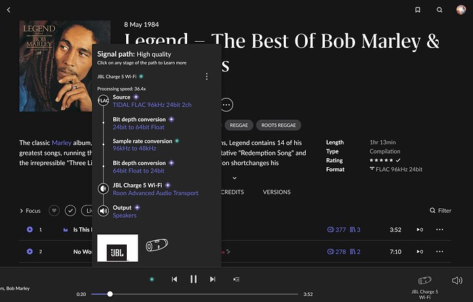

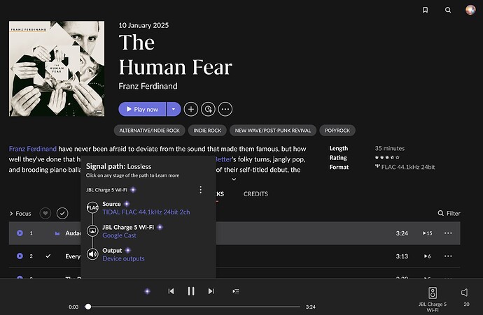

I just got the Roon Ready JBL Charge 5 Wi-Fi. I noticed that when I play though RAAT selecting the Roon Ready device in the Audio settings it down or up samples everything to 48 KHz no matter what. What is strange is that if I play the JBL through Chromecast (so going to audio settings and selecting the chromecast device) it plays lossless without down or up sampling music, and doing it so only if I reach the chromecast limit of 96 KHz.
So my question is: why if through chromecast I can play the JBL over Wi-Fi losslessly, I can't do it through RAAT being it Roon Ready?

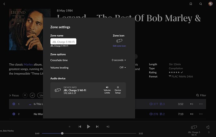

Screenshots in the next comment.

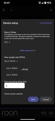

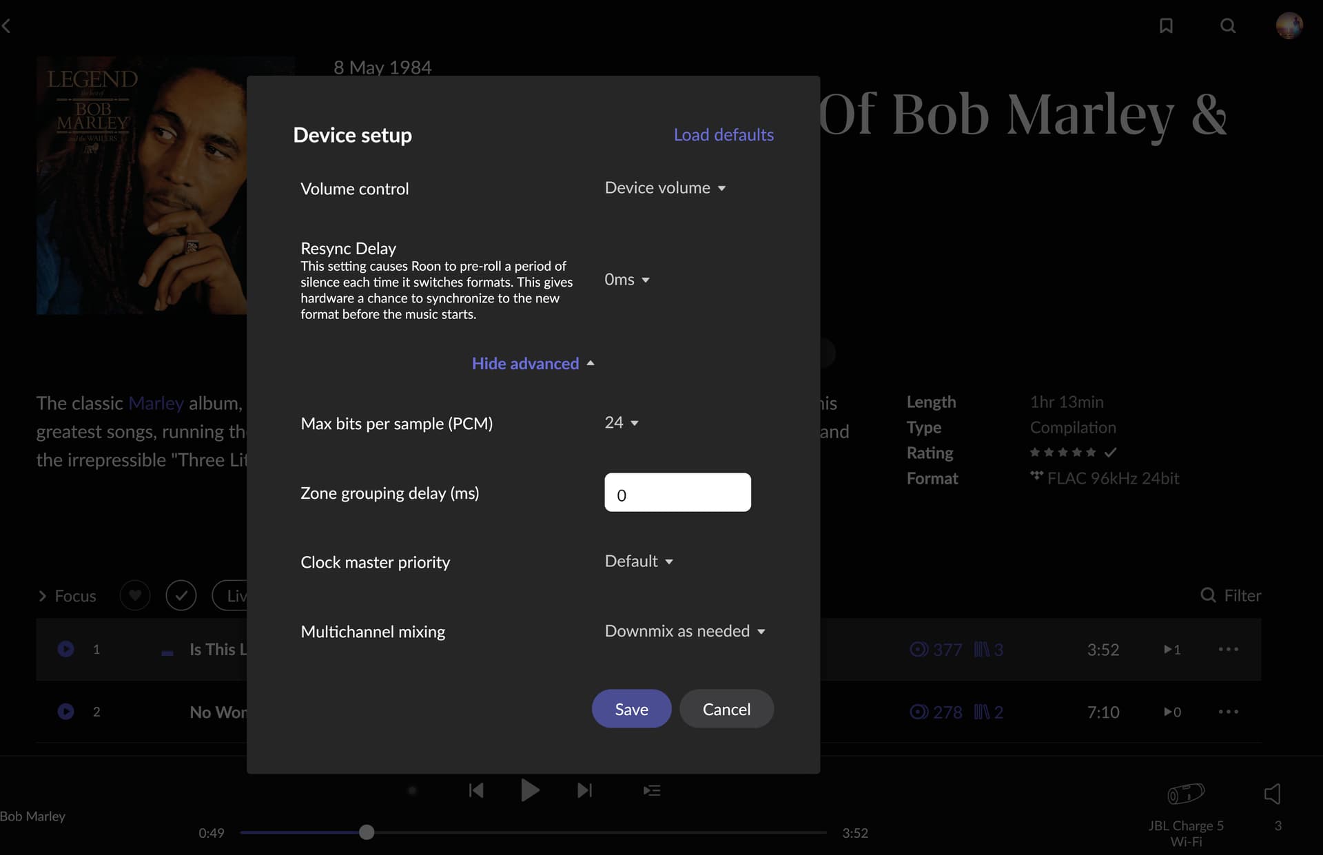

What are your device settings for this zone in Roon? Is it limited there to just 48?
Like here…

That’s because it can support it as an input but the device will downsample it to 48/24 internally. This isn’t visible via Chromecast as only RAAT feedbacks what happens on the device as it’s part of the RAAT SDK. These speakers do not handle anything higher internally. RAAT has a full understanding of its capability and thus downsamples using Roon rather than let the device do it. On a speaker like this what use is hires you will never be able to play it loud enough to warrant it before it’s distorted to hell anyway.
Or lower apparently. Hence the need to upsample 44.1 to 48kHz.
Either way it’s not an issue.
Exactly the same happens when you stream to an Android device running the Roon client. Android only handle 48kHz.
Max PCM rate for the Charge-5 WiFi is 48kHz. I have two of them for the garden and I’m quite happy with them. The sound is great for a box like this, they play perfectly in sync via RAAT and the WiFi reception is excellent, even 50 m from the house everything works fine. No need to complain.
