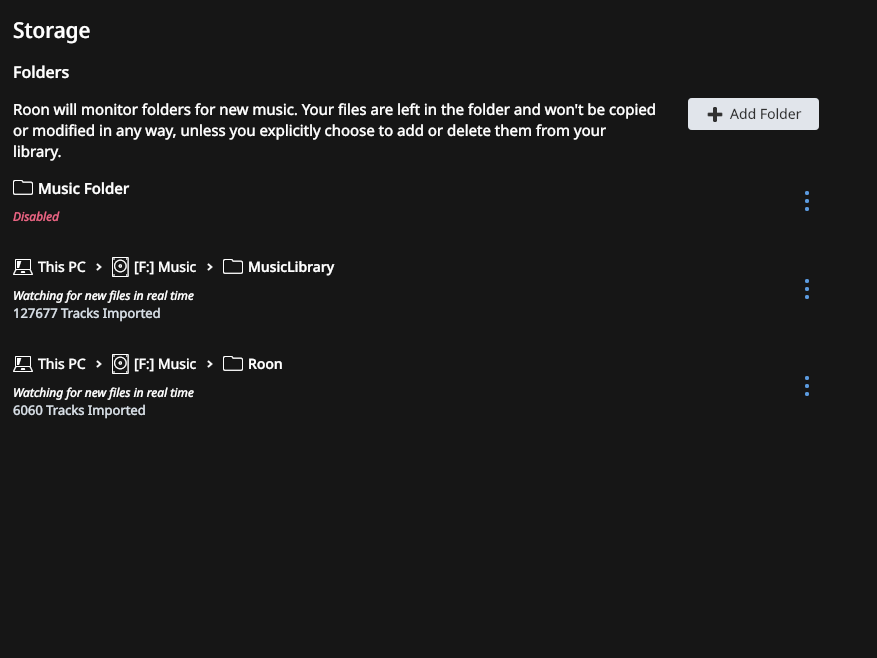

When I go to Storage and look to add a folder to watch, my only choice is the Nucleus. My PC doesn’t show up in the browse.
I don’t think you want to use your PC to host your music files. That means the PC would always have to be up and running, etc. I think you can do it that way, but it’s better to use an internal SSD installed in your Nucleus or a USB drive attached directly to your Nucleus or both. Can you move your USB drives to your Nucleus?

Goto Control panel Network & Sharing Centre and go to Advanced Sharing Options
In your Windows File Explorer, find the USB drive(s) where your music lives. Go properties and select the Sharing tab
Check the “Share This Folder” box
This should make the drive available/visible across the network
Go to Roon> Settings > Storage and add a folder
Navigate to the Drive in question
That should work , whether it allows your existing library to work I am not sure but you can at least see your music through Roon
