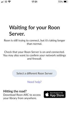

Just Keep getting this error
Hi there
I get this more than I get onto Roon lately and nothing has changed
I have a roon server that is solely that it’s just running the core
Everything is connected/referencing that and some days it’s fine others it’s this all the time
Any ideas please
Are you running your Roon server on WiFi or hard wired Ethernet connection?
Hard wired to the router
I’ve just rebooted the server and it’s a bit more stable , quite a bit more stable but I should t have to do that everyday
It also seems worse after an update, so I’m wondering whether I should reboot after an update?
I would reboot your Roon server anytime you start having problems or it starts seeming slower than normal. An occasional reboot of your router can be a good idea also.
Hi @David_Pullum,
Thanks for writing in to ask us about this issue. Do you have multiple subnets on your home network? This screen means that the Roon app isn’t finding your server where it expects it to be on your network so. So it could be a subnet issue. Roon devices cannot communicate with each other if they’re in different subnets. Its also possible the the LAN IP address of your server has been changing without your knowledge. To test that you can set a static IP address for your server.
Please try the troubleshooting steps and let us know how it goes.
