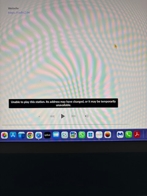

My provider is Telenet in Belgium. I cannot change the DNS of the router or the dhcp. I can only change the DNS on the Roon core. And that is now changed to 1.1.1.1. In the meantime I discovered that it is only a Live Radio problem No problem with Qobuz or local flies. None of the radio stations in “My Live Radio” work. All others do work in Roon. see photo
The stations not working in Roon are working fine with the Kef and Sonos apps.

Thanks for the update! A fresh Roon Server diagnostic report shows us the problem isn’t DNS, it’s a TCP connection block to port 80 on icecast.vrtcdn.be (VRT’s streaming server, which hosts Radio 2, Studio Brussel, etc.).
Telenet is blocking outbound TCP connections on port 80 to icecast.vrtcdn.be. Every radio stream attempt fails with Error Connecting to icecast.vrtcdn.be:8, Roon tries ICY, HTTP, and HTTPS methods, all on port 80, and all are refused.
What you can try:
  1. VPN on the Roon Server machine: A VPN installed on your Server host will route traffic around Telenet's block.
  2. Check if icecast.vrtcdn.be has HTTPS/443 streams VRT has been migrating streams. You could manually add the stations using newer HTTPS URLs (e.g. https://icecast.vrtcdn.be/stubru.aac) in Roon's "Add Station" dialog.
  3. Contact Telenet: Ask them why outbound TCP to icecast.vrtcdn.be:80 is being blocked. It may be unintentional and fixable on their end.
  4. Test from another device on the same network: Open http://icecast.vrtcdn.be/stubru.aac in a browser on the same machine as Roon. If it also fails, this confirms the Telenet block definitively.
