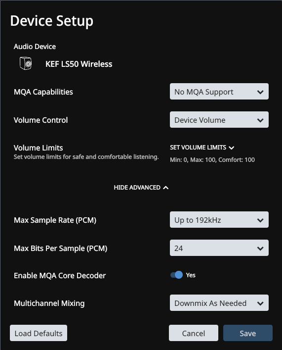

Oh no! it appears that I have the mk i’s with that wifi streaming issue. When I stream at 192kHz through wifi I just get garbled popping sounds. That was part of my confusion about how these speakers stream from different inputs. Thanks so much for all the very helpful info! It was all very informative and has given me much food for thought. I am very less concerned about the mk ii’s and I have already reached out to Kef about my issue with my mk i’s. I should have come here months ago!
Sorry to hear about your streaming issues, that’s unfortunate. You could still stream to your Kef’s via Wi-Fi if you set up Roon to Down-Convert any resolution higher than 96/24 to 96/24. You can do it by clicking on the Speaker symbol bottom right, then Cogs,
Screen Shot 2021-02-01 at 20.06.59
Then ‘Device Setup’, then ‘Show Advanced’, You should get this page -
Then… where it says 'Max Sample Rate (PCM), select ‘Up to 96KHz’, that should work.
Personally… I defy anyone to hear the difference between 96KHz and 192KHz on LS50W anyway… but that’s the subject for a long and boring discussion!!! :slight_smile:
