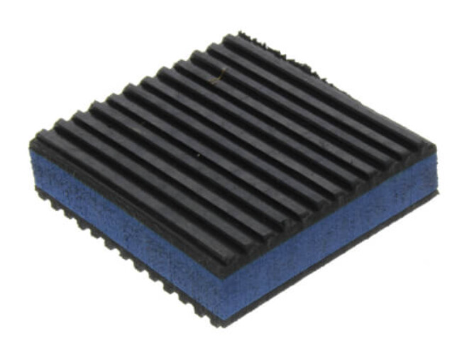

Good point. I suggest these: https://www.supplyhouse.com/Bluefin-VPE-300-E-V-A-Anti-Vibration-Pad-3-x-3-x-7-8. Used them with my previous speakers.
I have these now, not bad but IĘĽm looking for something better.
In what way are they inadequate (other than in appearance)?
Wanted something to make speakers sit higher off floor
