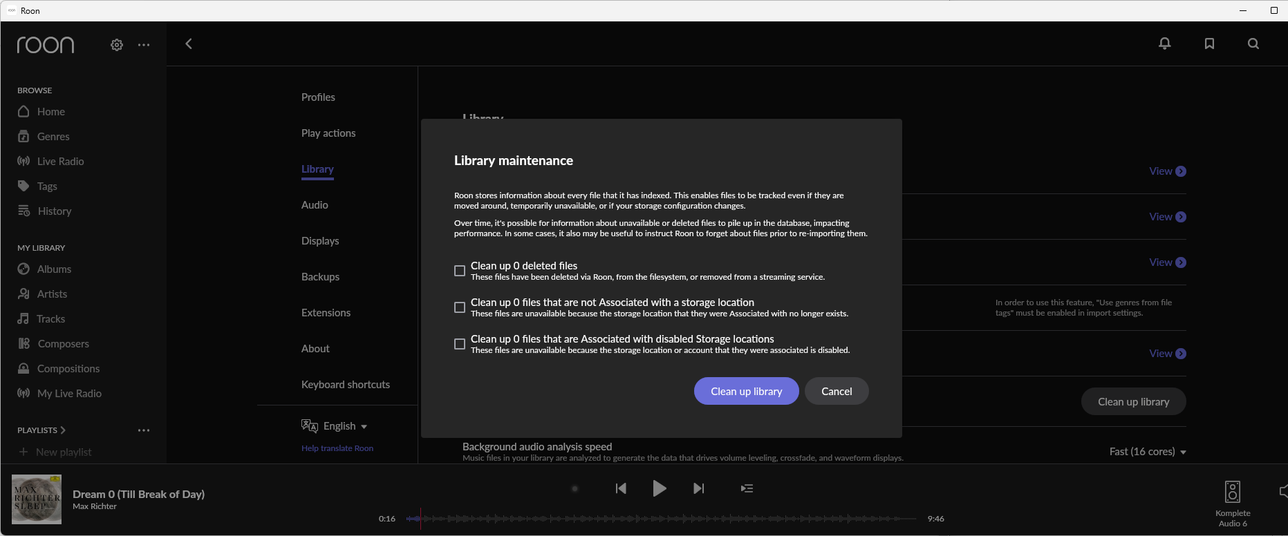

380,094 Local tracks with 329,579 Tracks identified. This indicates you may be holding ~50k unidentified tracks within your library. Can you share a screenshot of your Roon Settings>Library>Clean up Library (Do not perform a library clean up, we’d just like to see the stats on the clean-up page)
My immediate guess would be if you cleaned up these numbers, you’d likely experience less performance issues. Before doing anything, I would also suggest creating a fresh backup of your current database for safekeeping. :pray:

It’s actually a PC and I usually do clean up the library every so often. I am starting the backup now. Let me know if you need anything else. Thanks,
