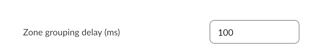

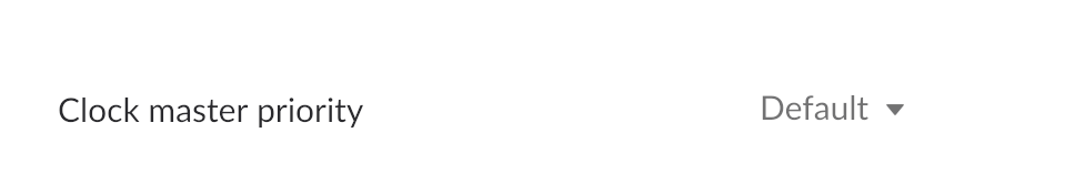

Hello @Armin_Hoh !
We’re sorry to see you are having a problem with syncing your devices in group.
Grouping of the devices using different protocols (USB/HDMI & RAAT) can bring noticeable delays.
However, we’d recommend you to take a look at the setting in device set up called “Clock master priority”, it will allow you to manage which device’s timings should be observed as a main device.
Also, the option to delay the device playback in zone is not gone, it’s there and called now “Zone grouping delay”.
If you want to deal with it manually, just enter the setup page of your StormAudio device and set it to start playback with desired delay.
let us know please if you have any questions or problems with setting it up.
