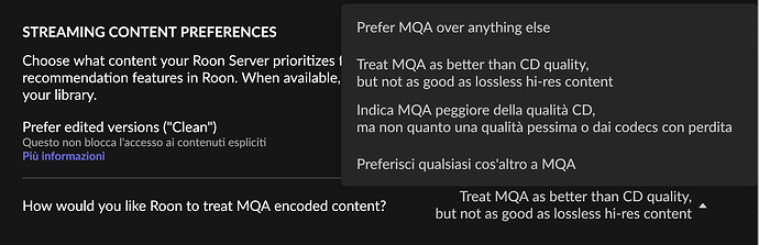

  1. A setting, mirroring the existing MQA options, controlling how 24/44.1 and 24/48 content is classified: as Hi-Res, as a separate intermediate tier, or as Lossless / CD quality.

The MQA option:

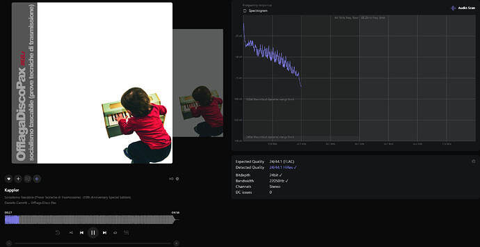

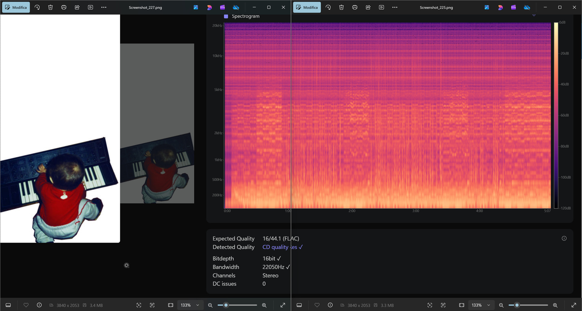

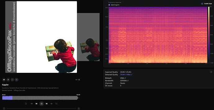

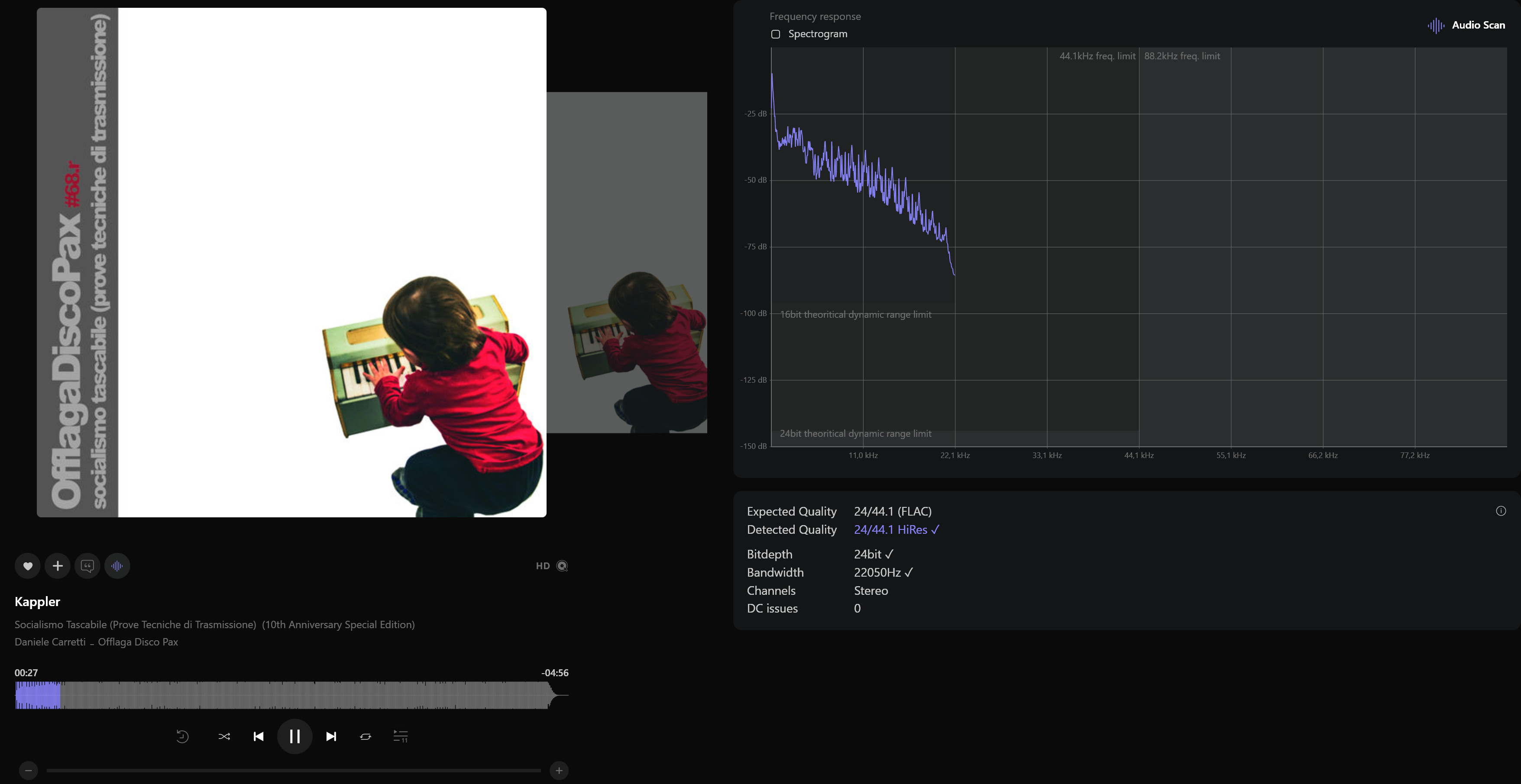

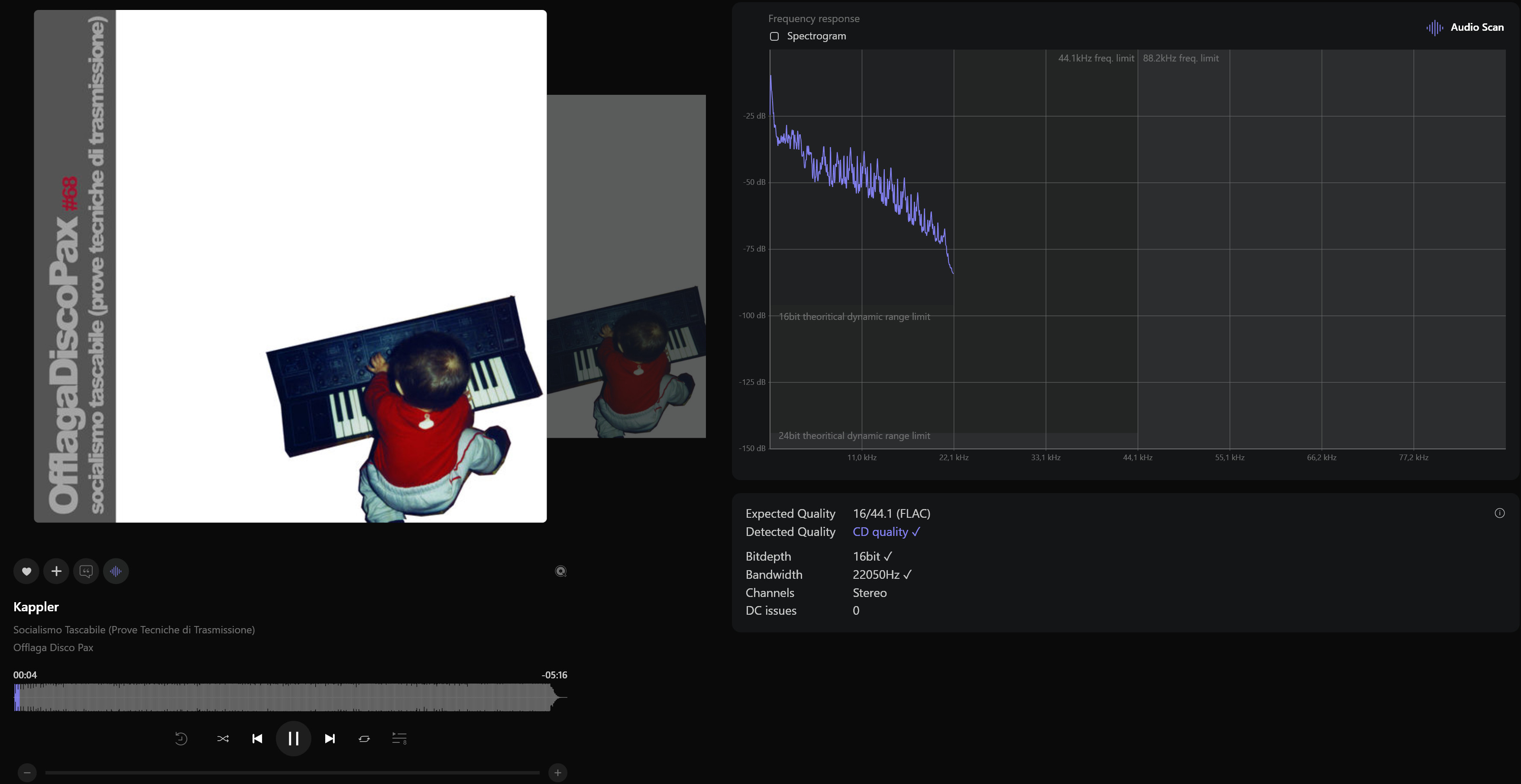

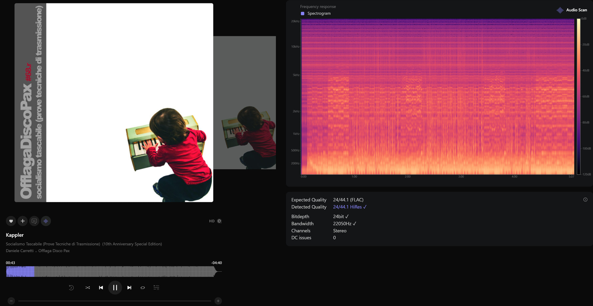

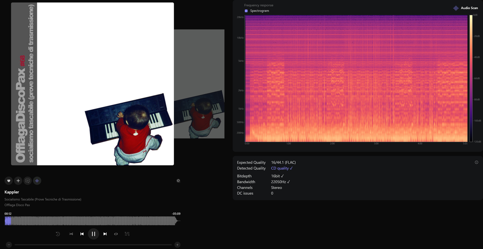

Some screenshots of the “problem”, i apologize for the source.

You’re right, forgive the approximation. For “spectrograms” on local files, I usually use MusicScope, which also provides dynamic range and several other parameters. I used the term “spectrogram” incorrectly and didn’t show the MusicScope screenshots because I wanted to provide examples that took a local file (in this case taken from the CD) and its 44/24 counterpart taken directly from the Qobuz stream via a client that allows real-time visual analysis. As you can see from the screenshots, the dynamic range is the same.
