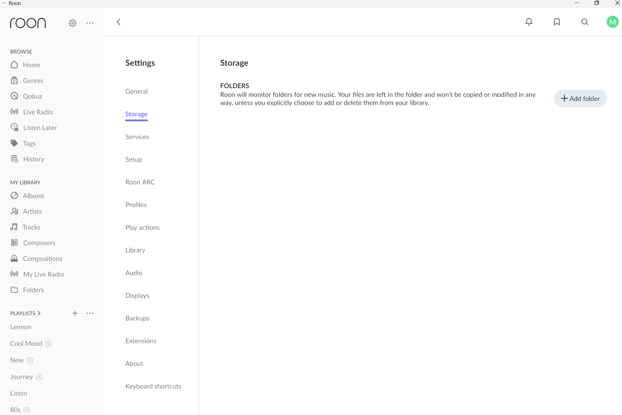

Yes, library only contains streaming content.
I don’t believe I have Watched Folders. See screenshot.

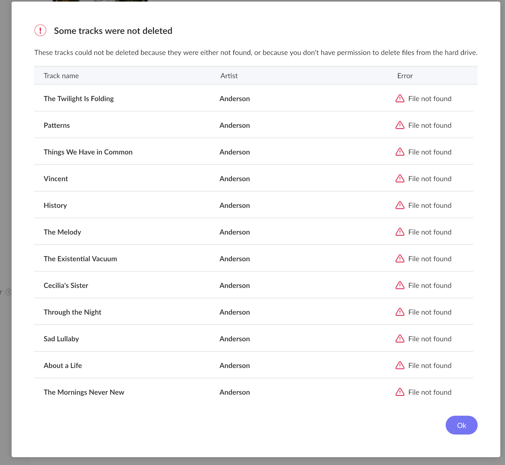

FYI, here is a screenshot of what I see when trying to delete albums:
