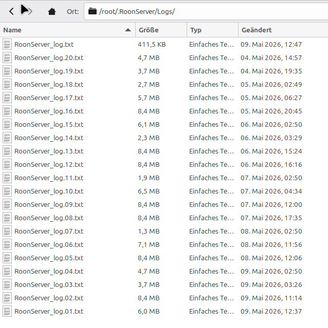

Hi @Stefanshine,
Thanks for the detailed notes. Can you please send us the RoonServer/Logs folder for review and let us know once uploaded?
https://workdrive.zohoexternal.com/collection/nocvrfc5b2ddab55140af8640f1d7ce13291e/external
“roon_logs_support_upload.tar.gz” uploaded successfully
Hi @Stefanshine,
Thanks for uploading those! Unforatunly, they didn’t capture any events surrounding the upgrade process and the database failures.
Could you please reproduce the issue in full, grab a fresh set of logs, and re-send them over?
Thank you!
“roon_logs_support_2026-05-09_12-40-44.tar.gz” uploaded successfully. => Forget this please, I’m uploading newer logs at the moment, takes about an hour till it’s finished.

Hello Benjamin,
I’ve uploaded the following files again, this time without compression as seperate files:
And in the log files you can see that I have also tried V2.66 and it’s the same issue.

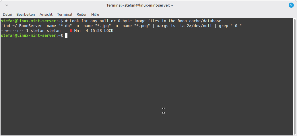

We’ll bring this to our development team, but it may also be helpful to try to identify the problematic performer image.
The crash happens while loading a specific performer whose image has a null/broken URI. You could try:
# Look for any null or 0-byte image files in the Roon cache/database
find ~/.RoonServer -name "*.db" -o -name "*.jpg" -o -name "*.png" | xargs ls -la 2>/dev/null | grep " 0 "
If you find corrupted/zero-byte image files in the Roon image cache, clearing them (with 2.64 stopped) might let 2.65/2.66 proceed past the crash.
