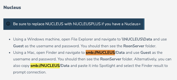

Hi @cbcomp1,
It sounds like you’re refreshing the Roon Server database on your Mac, not your Nucleus. Per the instructions I’ve listed above:
  1. Using a Mac, open Finder and navigate to smb://NUCLEUSPLUS/Data and use Guest as the username and password. You should then see the RoonServer folder. Alternatively, you can also copy smb://NUCLEUSPLUS/Data and paste it into Spotlight and select the Finder result to prompt connection.
This is great news!
Yes, by renaming your Roon Server folder as mentioned above - but you’ll need to rename the Nucleus database folder, not your Mac database folder.
Navigate to Roon Settings> x Disconnect > This will take you to your list of optional Roon Servers, where you should be able to see your Nucleus listed as an option.
I hope this helps!

I have fixed everything. Could I make a suggestion that you change the instructions on how to fix this problem to include the “smb://NUCLEUSPLUS/Data” path. the current instructions send you to the Roon server folder on your computer, and of course this doesn’t work. If it was clear of how to access the folder on the nucleus, as per your instructions above, I would have saved hours in mucking around and having to set up a new server on my mac just to get Roon working again.
Anyway, thanks for your help, I now have everything working properly again

Hey @cbcomp1,
Sorry for any confusion here - these instructions are listed in the KB article linked above. :+1:
