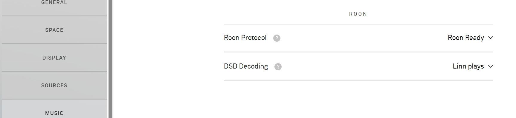

Did you activate this setup:
Torben
Yes, thanks. Those are set - Just not seeing LINN as an output option in Roon, as I used to with Lumin. Gotta be user error… but I’m baffled. Thanks in advance for any other suggestions.
I should add more on the step up -
Roon server running on iMac Pro with external drive of music.
Linn is set up for both ethernet and Wifi - confirmed wifi config.

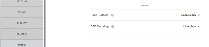

Hi Ricard. Without this activated you will have no Roon Ready
Torben
Both of those are set, yes.
