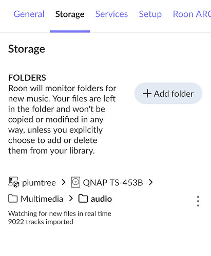

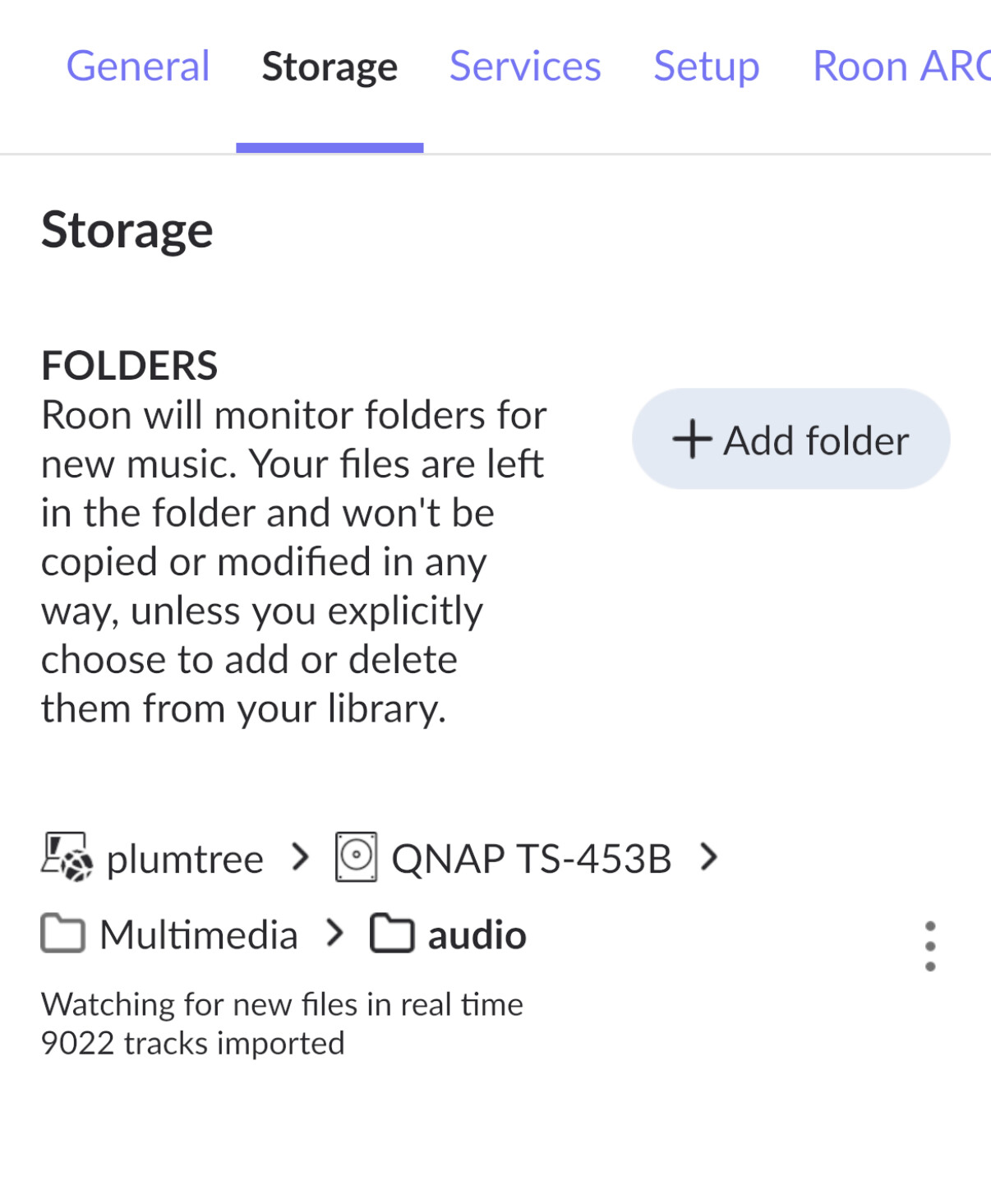

Can you snap a screenshot of your Roon Settings>Storage to confirm you still have a proper shared connection to your local library?

Re: storage path
It’s local on the same qnap the core runs. Also see image.
