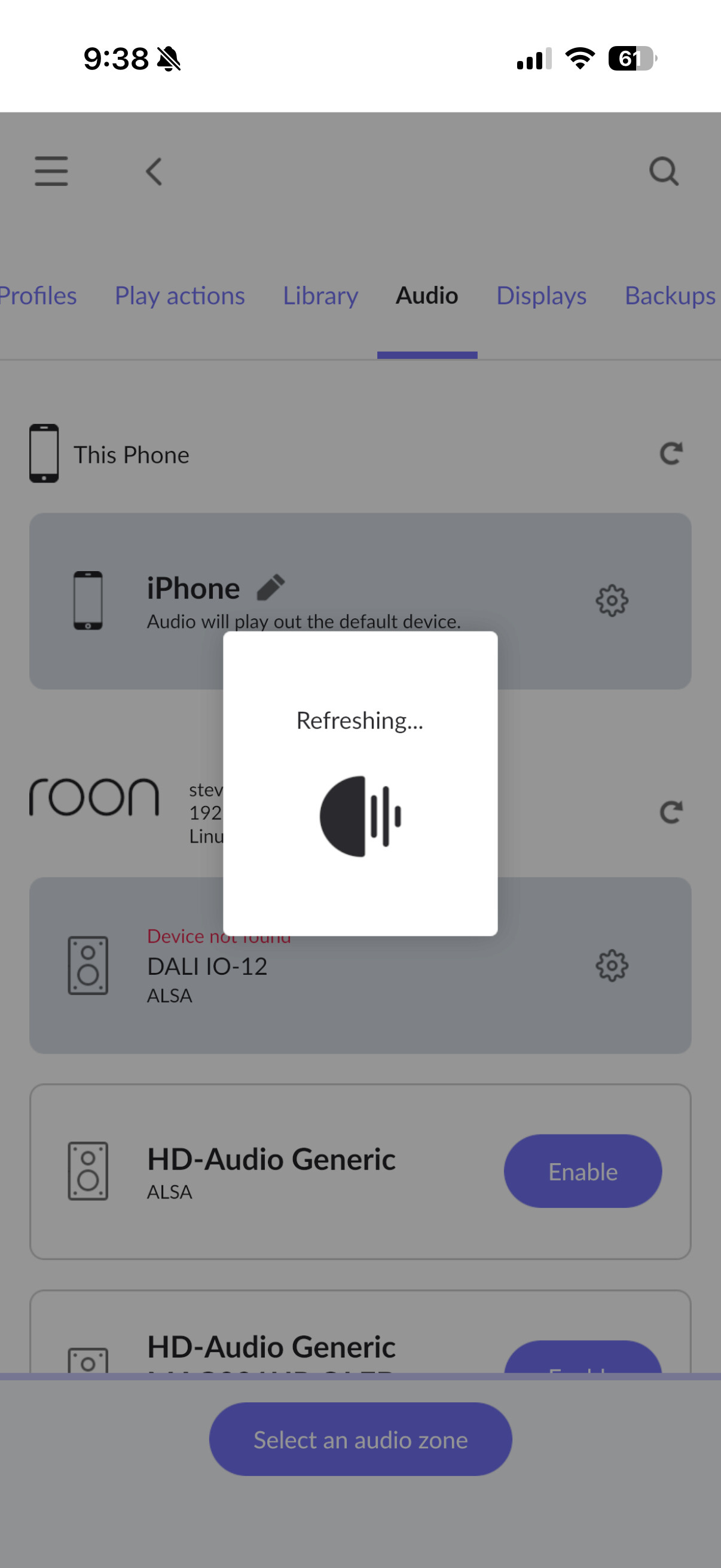

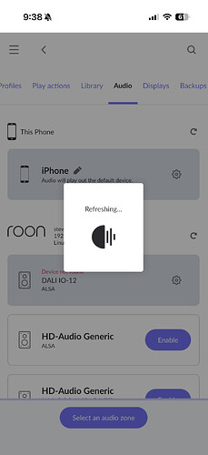

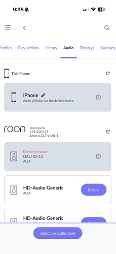

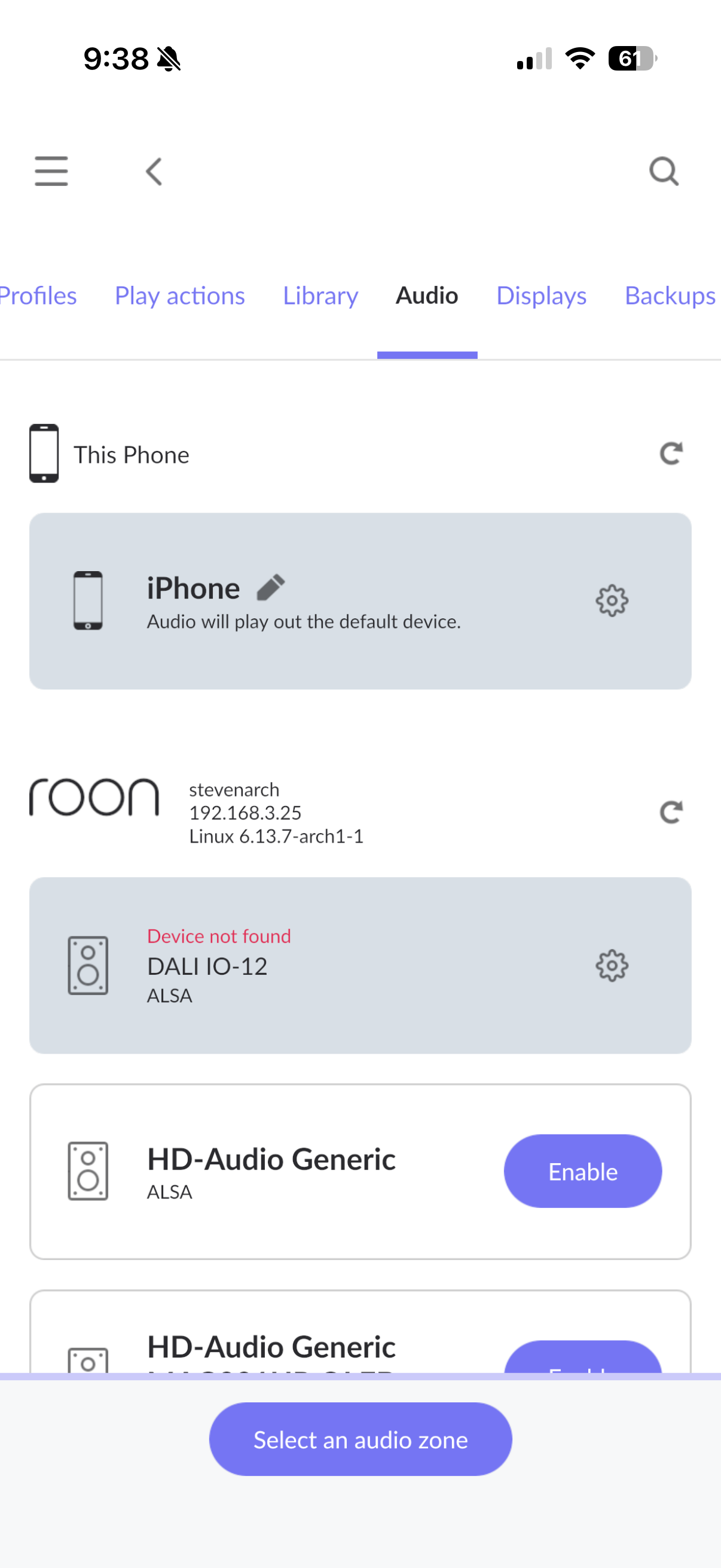

Hi, just trying to utilize roon bridge or roon server on a Linux host (Arch Linux), the service is fully operational until
a) Dali IO 12 headphones is installed
b) attempt to enable Dali IO 12 headphones via roon interface (ipad or iphone)
The roon service crashes and various USB devices stop functioning until logout/reboot or you re-attach them. Note USB headphone audio works without issues in general.
There is nothing obvious in the roon logs to suggest issues, but they are not very verbose. dmesg does show the disconnect of the other devices
Running roon service app as a standard user does work, so issues is specific to when roon is run as a system level service.
Enabling standard audio interfaces on the same device works without issue.
Would be great if you could advise/look into this.
Have tried disconnecting all other USB devices and changing ports around to no-avail.

Can confirm this does not occur on Windows for the desktop App.
Device hostname is “stevenarch”
Started 17:25
Stopped working 17:26:37

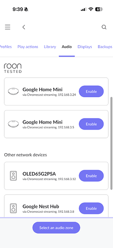

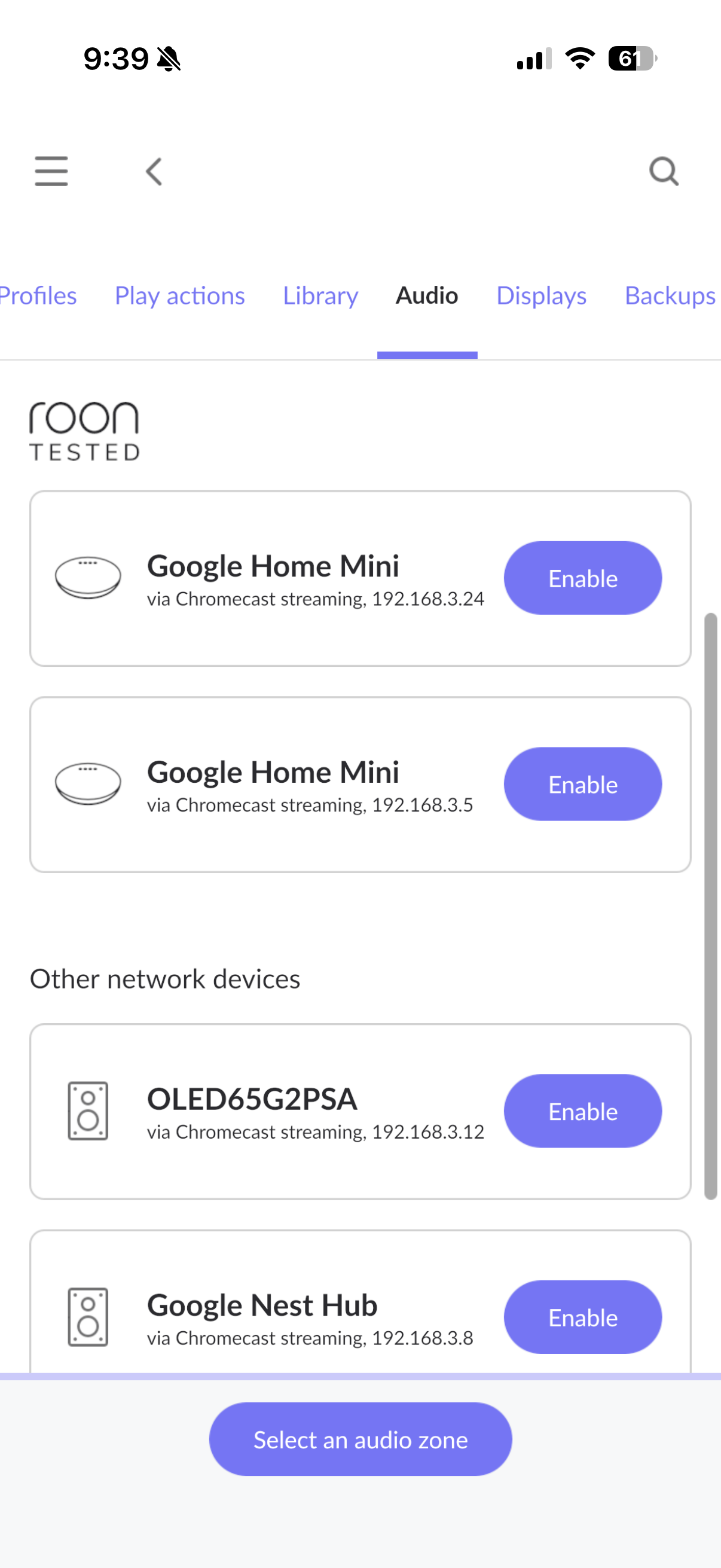

When this occurs all roon audio services on the linux box dissapear on the iPad display.
I do use the headphones via usb-c on the ipad and iphone without issue.

Hi Conner, I tried using both the Roon Server and Roon Bridge on the same Linux Arch OS (just for playing music and controlled via iphone or ipad). The main roon server is hosted on a Synology NAS.
The other audio zones remain present, while the Arch Linux box freezes
on the IOS app which I use to control the service, you can see the visual changes below (occurs over about 15-20 seconds)
I’ve tested using the headpones via bluetooth and USBC on iphone with the Roon App, and it has no issues.
