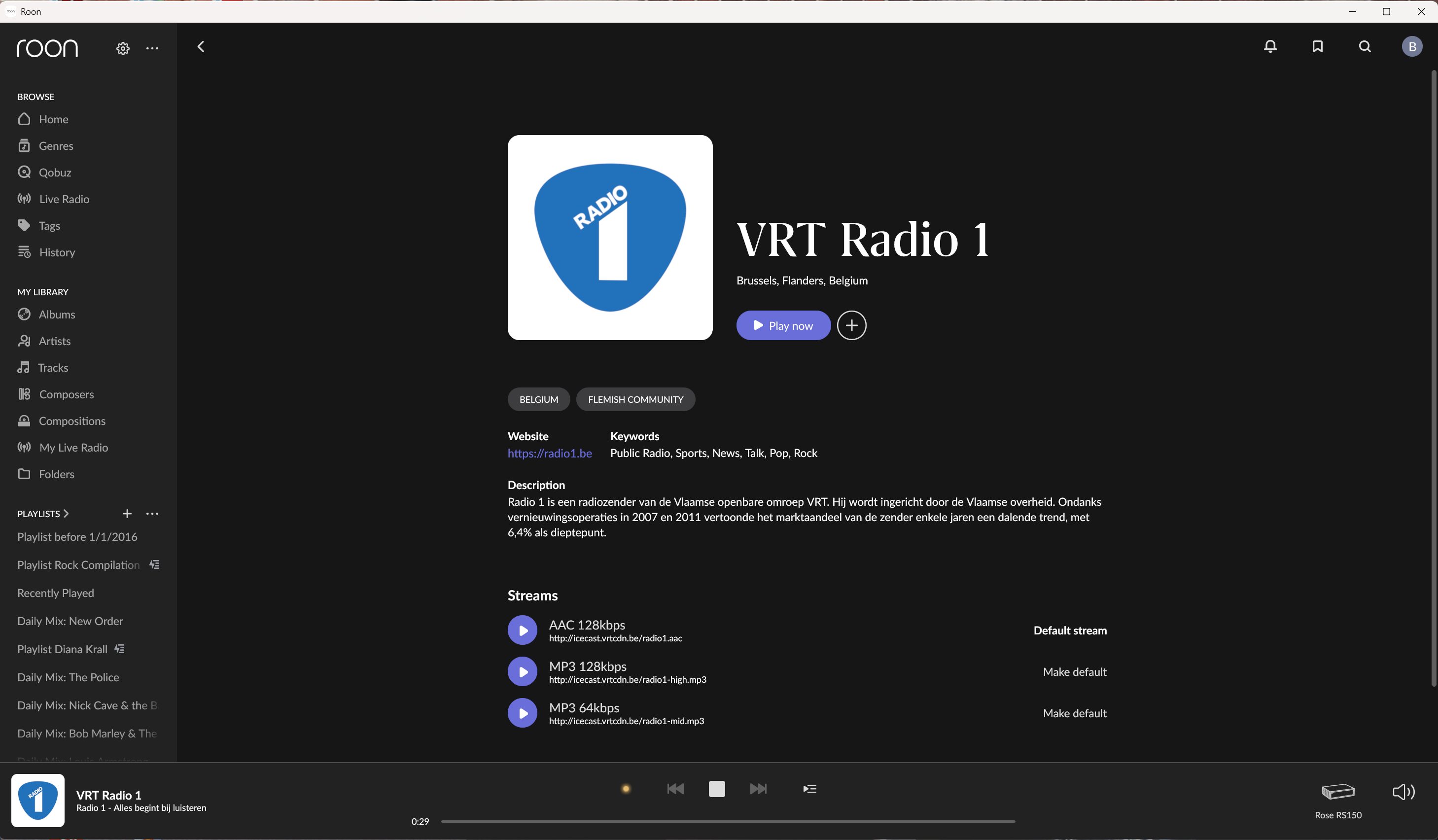

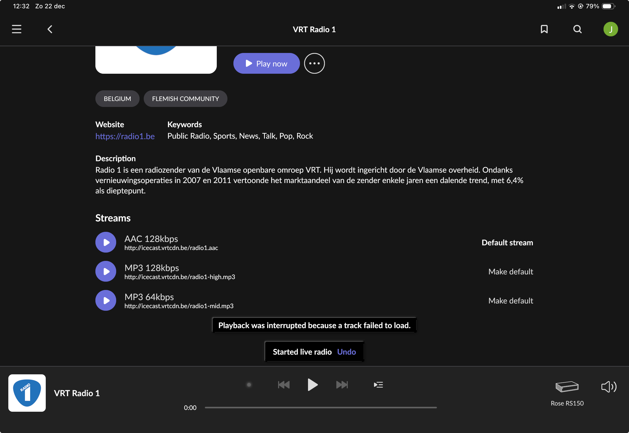

* Roon works perfectly for music playback from NAS and Qobuz but Roon Live Radio does not work for streams which are working fine for me (see attached example)
I tried some links at my friend’s place working fine for me but not playing at his place eg VRT Radio 1 is playing fine for me (we both use the same internet provider) :
Some streams do play but more like a rarity.
My streamer is the Rose 150A model (so very similar set-up like mine).
Your friend is likely missing the codecs to play the streams. See also:
Thanks! I checked and we have both the same version of that codec… We’re both using a NUC running Roon Rock. The QNAP Nas is used as a music library.
Hey @Benedikt_Gruyaert,
Thanks for writing in!
Unfortunately, without any of your friends information, we’re not able to provide much assistance here. Are they able to create their own support request?
From there we’d be able to enable diagnostics on their Roon Server for additional investigation.
One thing they can try in the meantime is changing their DNS server from their host machine. We have seen users have a better experience in the past if they change their Router’s DNS servers from the ISP provided ones to Cloudflare DNS, Quad9 or Google DNS. Can you please give this a try and let me know if it helps?
Thanks. I’ll check his DNS settings.
Issue solved with a new copy of the ffmpeg file to the Rock codec folder.
