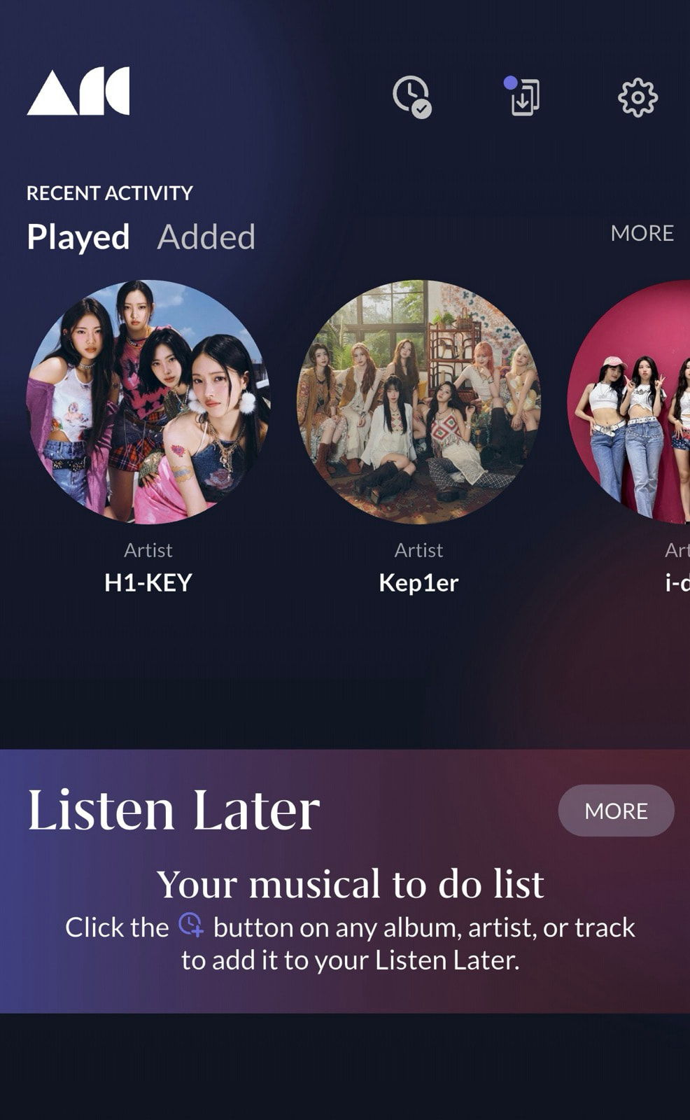

I did not take a screenshot, but my memory is it looked mainly like this:
there were round images for Artists I had either played or searched recently, but no square album cards for albums I’d been playing. I don’t think the recent activity title was there, but I am not 100% sure.
