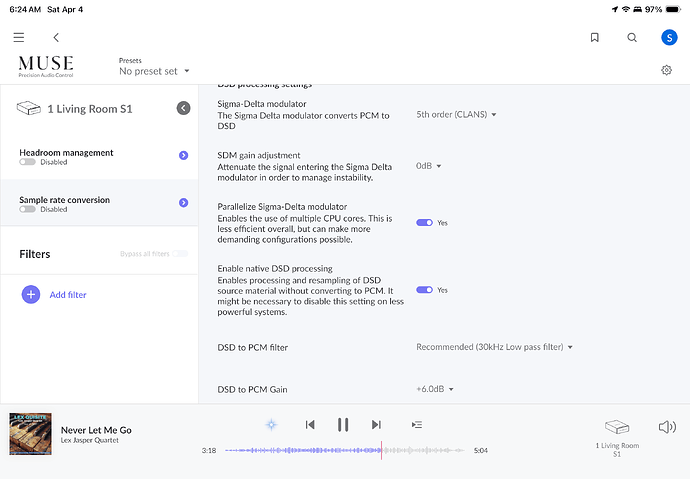

I have a nucleus b with internal storage and a Auralic s1 streamer. Any local DSD files 256 or above hang up and skip. All wired. I also have a Silent Angel Ethernet switch. What would cause content to load slow? PCM works fine.

Did you enable multicore support for DSD Processing? I think DSD is single core otherwise and the nucleus B might be to weak for DSD256
I’ve enabled multi-core. It plays 64 and 128 just fine. I also suspect that the processor in the Nucleus is the problem. I was hoping that I had missed something in setting up my system.
I’d rather doubt that your nucleus is not capable of playing DSD >128. You even have disabled any DSP.
But check you signal path in roon while trying to play >128. Is processing >>1.0? Then, it’s not the nucleus.

Play a problem file. Look at the signal path on Roon. If it does not indicate any processing speed or any speed < about 1.2 then this isn’t a Roon issue.
