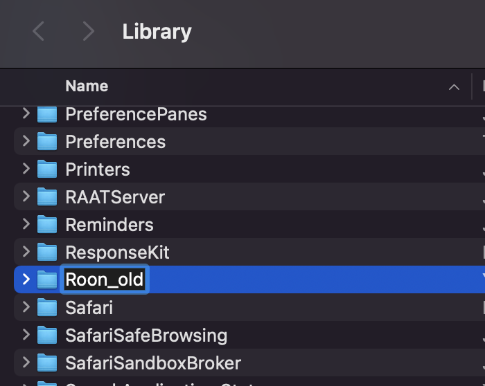

Hey @Dan_Clark,
Thanks for the update. Our records show that you may have not set aside your old database properly. Here are a few more detailed steps on how to find your Roon database on your mac:
  1. Head into your library by clicking ‘Go’ from the top bar on your Mac, and then hold down the option key:
  1. From there find your Roon folder, and rename it to Roon_old:
After that, reinstall Roon and it will properly reinstall a fresh version. As always, make sure Roon is not running during this process, and that you have a recent backup saved.

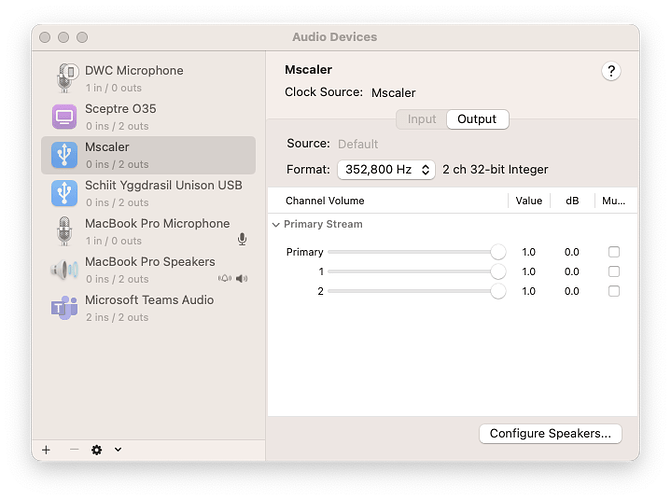

Apologies for the delay in following up! We were able to view a fresh set of your Mac core diagnostics, and have a few questions:
  • Can you play audio to the system output on the Mac?
  • If possible, could you share a screenshot of your audio MIDI screenshot from the Mac, with your USB DACs connected and enabled?
  • Could you temporarily disable HD tracks, and let me know if you’re able to stream audio properly?

Hi Benjamin, alas none of this worked.
  1. Audio output on Mac same problem.
  2. HD off no effect

You are correct here - I had misread which mac was running RoonServer and which was the remote device. We’ll need a copy of the Roon logs from M1 MacBook to better scan for errors, if you could please use the directions found here and send over a set of logs to our File Uploader?
Lastly, we have seen odd situations when Microsoft teams is included in the audio MIDI settings, where it would reassign the OS audio drivers unknowingly. If possible, could you test out removing or temporarily disabling ‘Microsoft Teams Audio’, see if you’re able to get proper output?
Teams uninstalled, no change. Logs uploaded.
