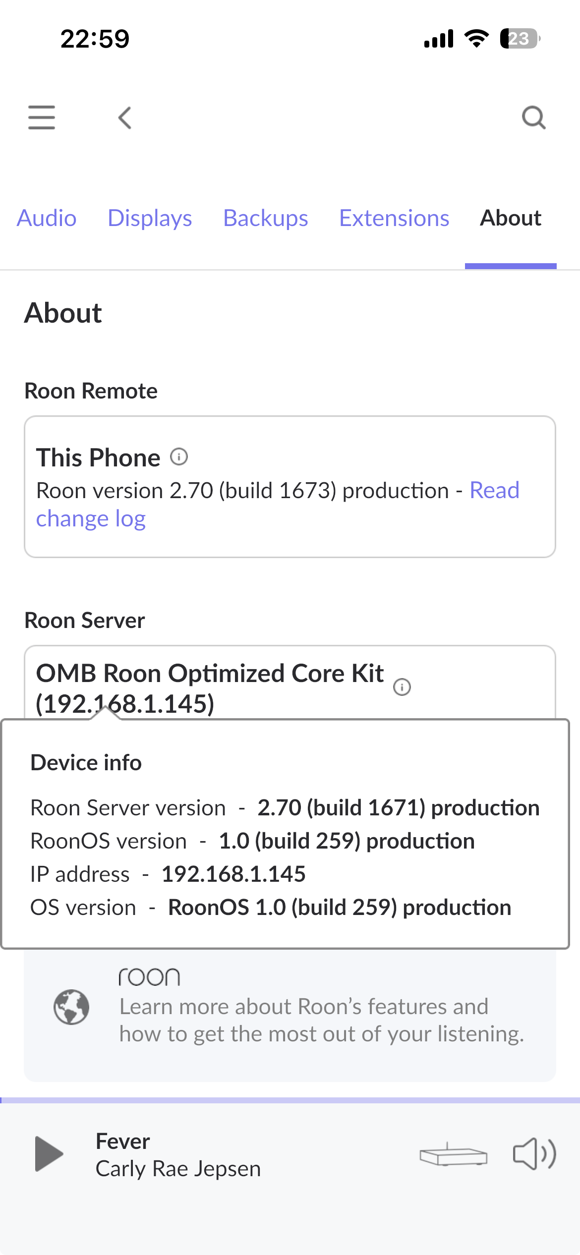

· Had a power cut the other night and ever since, local files won’t show up in ROCK. I have repowered and rebooted several times but with no luck. It is only seeing the free space on the internal drive, not the whole thing.
· Hyperoptic router. NUC with Rock on plugged directly into it.

What about the webUI itself? You should be able to access this from a browser on the phone you used in your initial screenshot.
