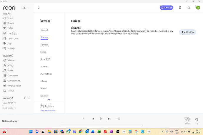

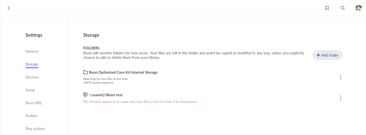

Could you please share a screenshot of Settings → Storage in Roon?
This will help us confirm whether your local folders are properly added and accessible to the Nucleus.
Once we see that screen, we can advise on the next steps.

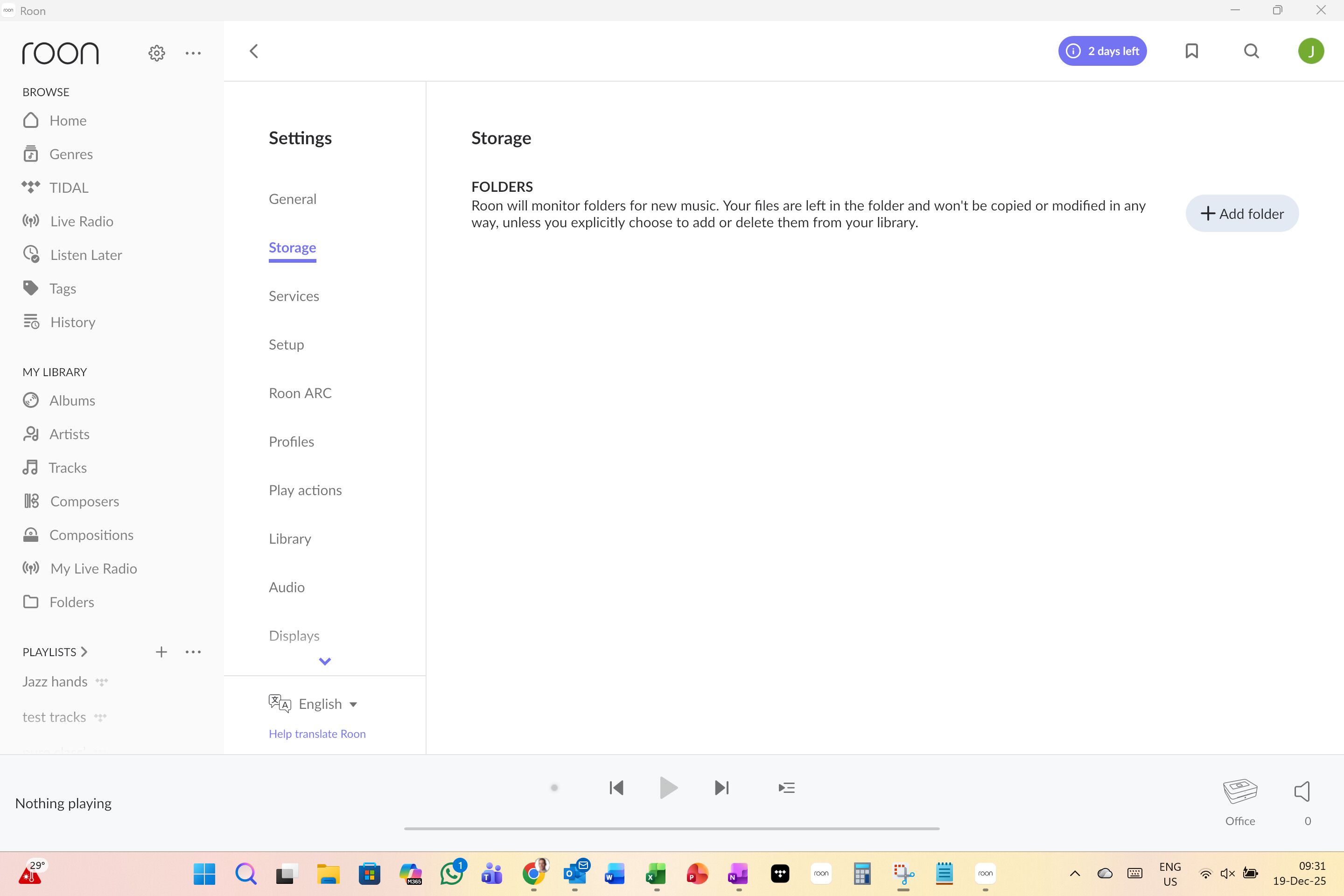

Hello @Jon_Post,
Thank you for sharing the screenshot — that clarifies the situation.
At the moment, no local storage locations are configured in Roon at all, which is why you’re only seeing TIDAL content and no local files. The Storage page you shared is completely empty, meaning Roon has nothing to scan for local music.

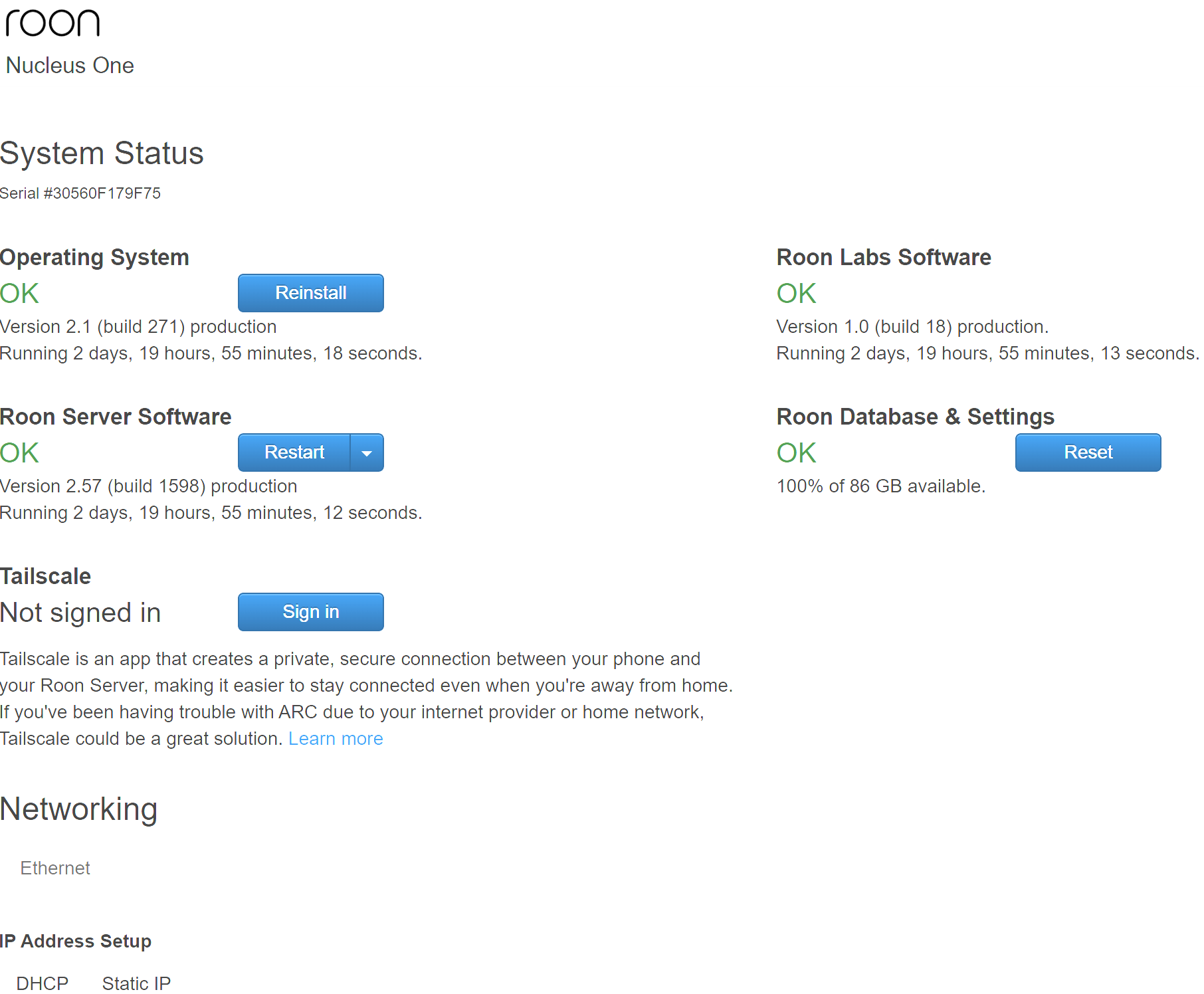

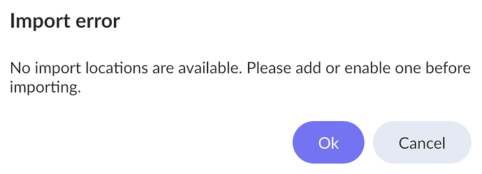

Ah my bad, it turns out that I cannot actually drag and drop - the operation looked feasible in the UI when I dragged a file across to the app - but then I got the “Import error” as per dialogue box below.
The web admin interface is as follows:
OK, so you haven’t got the optional drive for music storage installed in your Nucleus. So then we’re back to diagnosing why you can’t add the shared folder on your PC as a Watched Folder.

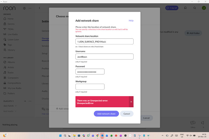

Can you try replacing the PC’s Hostname (JON_SURFACE_PRO) with its IP address in the Network share location field of the Add network share screen?
That “Unexpected error” message usually signifies that the network share location can’t be found, perhaps because the hostname can’t be resolved to an IP address.
Hiya, I have the IP address in XXX.XXX.X.XXX format… do I need to prefix it with http:// or https:// or (?)
Nope, the format of the Network share location is
\\XXX.XXX.X.XXX\Music
BTW, you don’t have to obfuscate your internal IP addresses for the forum, you can show the actual IP address inside your home network without fear - it’s your external (public) IP address that you shouldn’t reveal in a public forum…
Nope . . . it didn’t like that either.
Still the same error message - “UnexpectedError”? And you did use the IP address of your Surface Pro?
Yes, that’s correct… I think that’s the only error message I’ve ever seen (?)

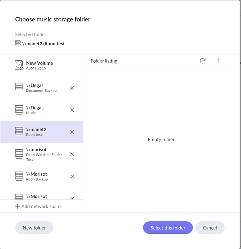

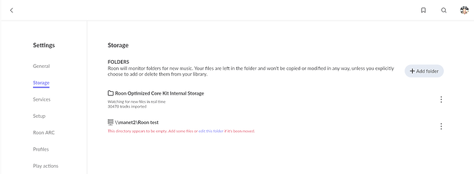

I’ve just added a local account (called roon) to my Surface Pro and tested adding a Watched Folder to my ROCK/NUC system, and that worked as expected…
I’ll also install a new SSD tomorrow and see if that can be formatted and available, in case the issue is with the native storage…
