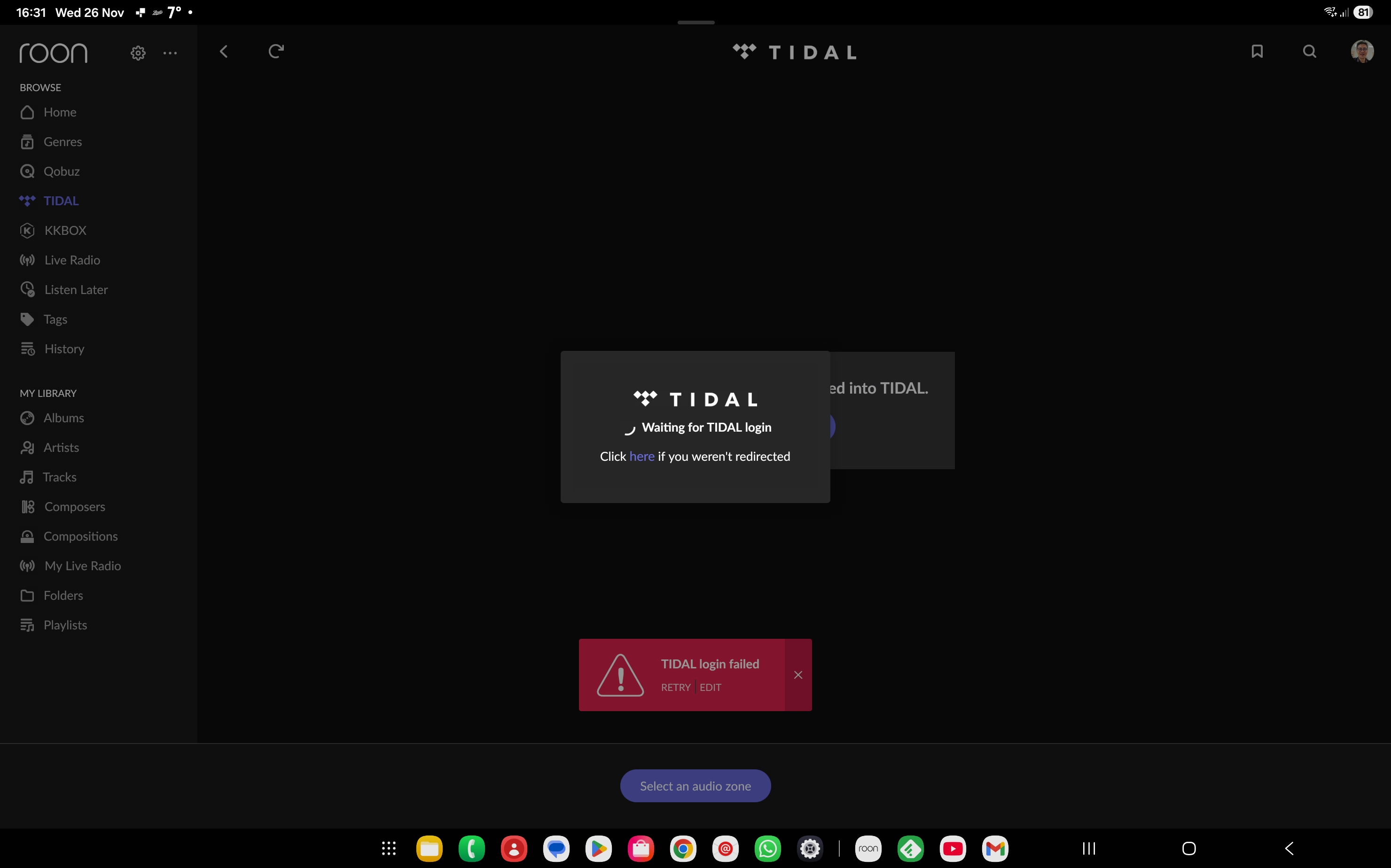

Cannot login to Tidal, Qobuz and KKBox successfully. Also Roon ARC cannot connect to my server.

  1. All machines (Windows. Android phones, tablets) cannot access the streaming services.
  2. I can use the streaming services via their own apps directly.
  3. The Roon server is currently online and trying to login the steaming services
Regards
Also, Roon ARC app cannot connect to the server. It occurs when the streaming services are disconnected.
