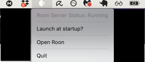

Since Tailscale is working well with Plex, it doesn’t sound like the issue lies with Tailscale itself. Just to be thorough, could you double-check that Roon Server is set to launch on startup? You can verify this by clicking the Roon Server icon in the macOS menu bar—make sure there’s a checkmark next to “Launch at startup?”
Can you share a picture of the screen that says that?
Hi there. I will have to check that when I get back from overseas in order to get the screenshot. I know it was set up like that and I wondered if the issue might be that the server IP address is not the same as the tailscale IP address. They are both configured to start on login, but roon starts first.
Hi @Simon_Tetley,
I don’t believe the IP address is the issue here—your Tailscale setup sounds similar to mine, and it works fine on my end. Since you’re currently away from your server, it’s possible that your computer ran into a hiccup that could be resolved with a simple restart. If you have a way to remotely restart it, that might be worth trying. Let us know how it goes!
