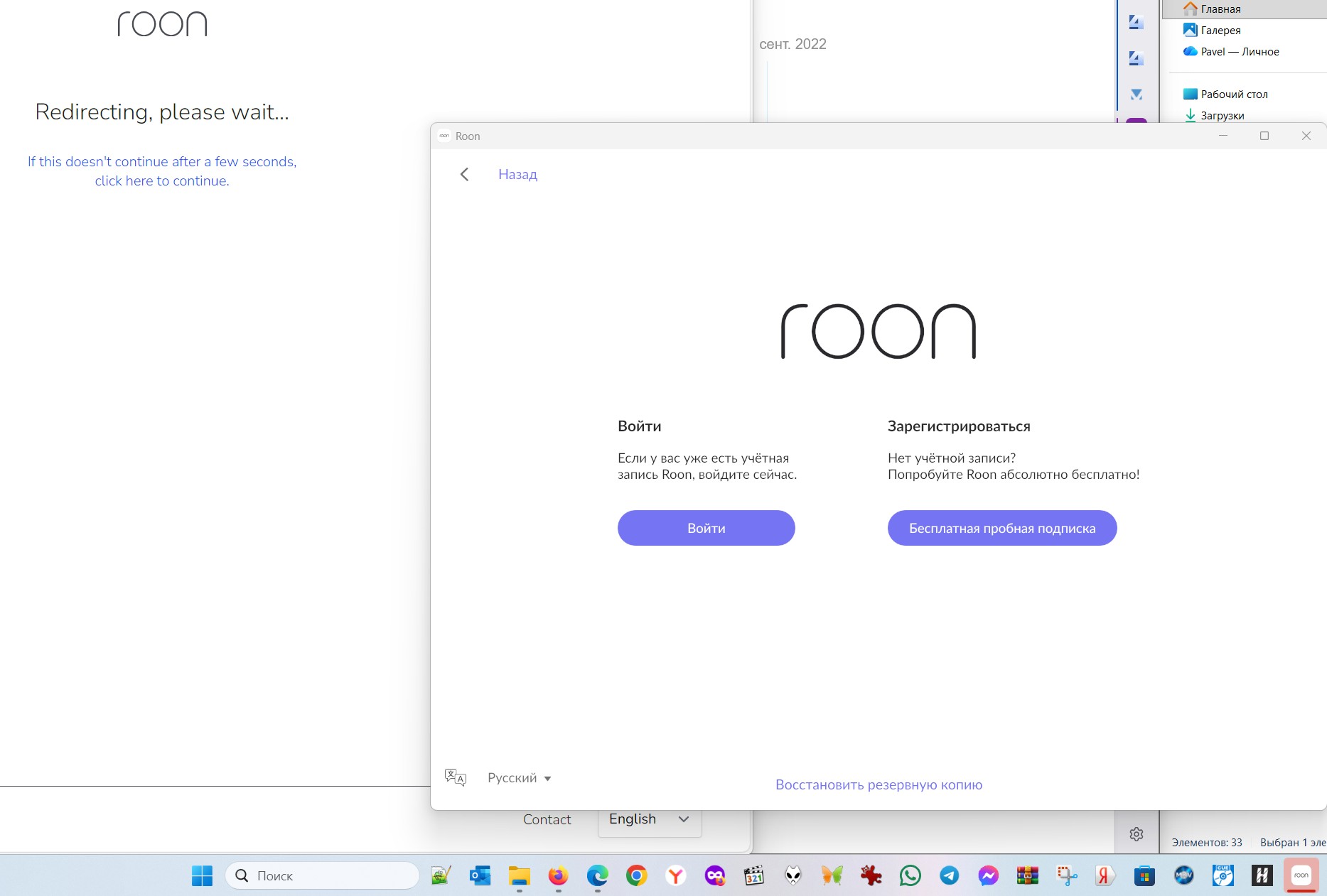

· Roon is newly installed on Windows PC. After the first launch and selection of the server (on the same PC), you are prompted to log in to your account.
I click the LogIn button. I enter my Username and Password and see the page "Redirecting, please wait..."

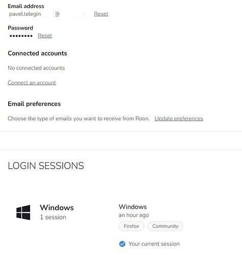

Nothing else happens after that. Clicking "click here to continue" does not help. At the same time, the Account Profile shows that I am successfully registered.

Yes, of course. And the Account Profile shows that I am registered in my Roon Account.
Registration on the external Roon server is going well - this is also evident by the fact that, after entering the registration data, the Roon window blinks and the Roon icon in the Taskbar also blinks red (see the screenshot below (bottom right corner)).
