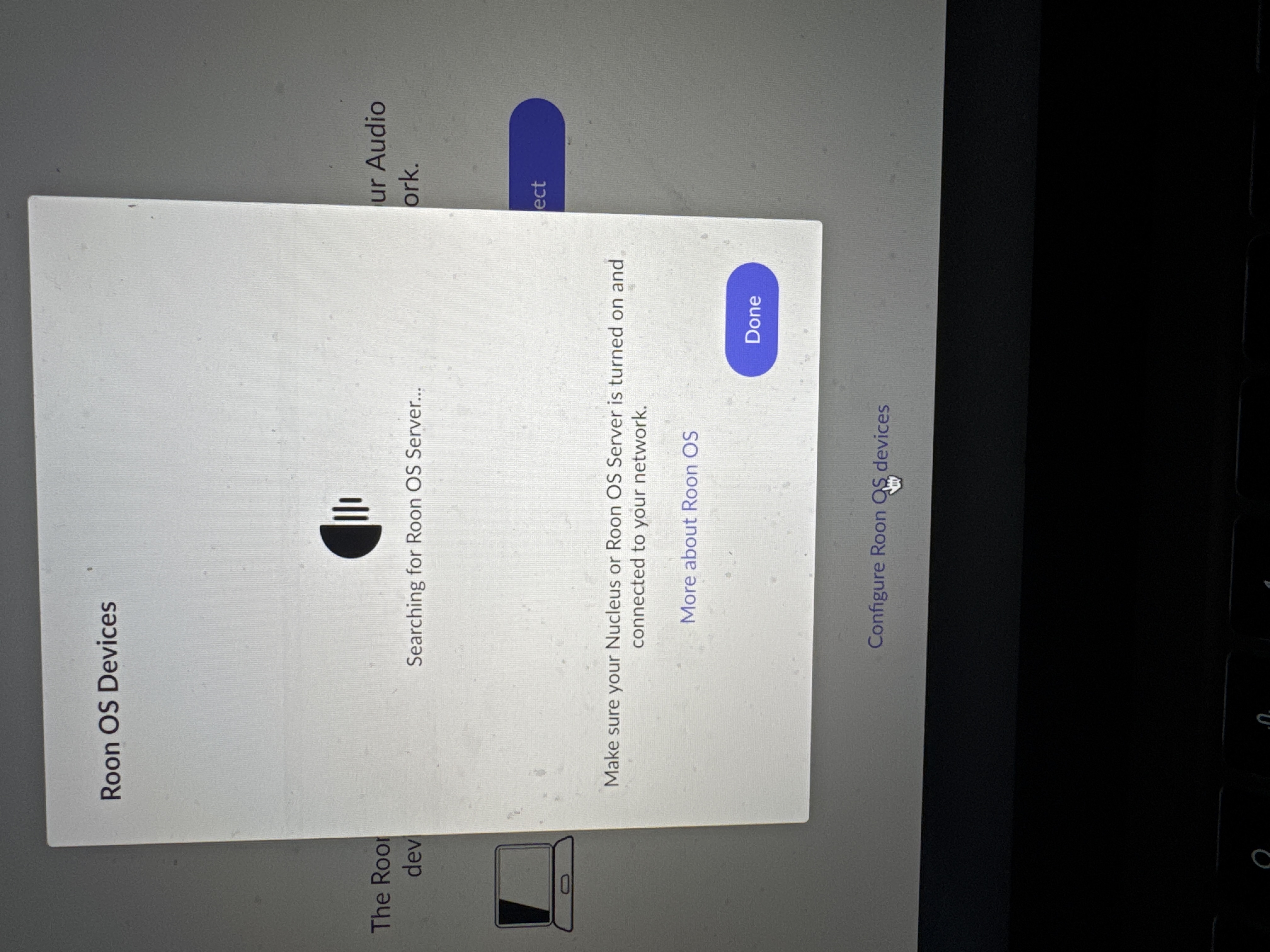

Hi,
I have problems logging in and it looks like my core does not work on my server. The log in problem is probably because of the two-factor login process, which I have not initiated but still is needed. When I look at the Core that is installed on my Qnap-server, it says that it is not logged in. Results in that I can not find the Roon server from my iPhone…..
Lots of strange problems. Can you please help me.

Then it is useless to search for Roon OS servers as you obviously run a different OS (QTS or QuTS hero).
You need to be able to find your Roon Sever from a client (PC, phone or tablet) running Roon to be able to login (activate the license for the Server).
So this probably leaves you with the 2FA as source for your trouble. Please check your account to see if it is activated and if you can do something that help you overcome the issue right there.
Hi @Lars_Granbom ,
Welcome to the forum! As @BlackJack mentioned, it is normal to not see any RoonOS devices in that screenshot since you are using a QNAP server. I noticed in the background the QNAP server shows, you are saying that if you try to connect to it it doesn’t work? Are there any specific error messages that are displayed? I would also double check that you have allowed Local Network Access on your iPhone in iOS Settings → Apps → Roon → Local Network Access is turned to On.

It looks to me like your NAS model isn’t even available long enough for that.
How did you login again if you have issues with 2FA?
Please post screenshots of what you see on your end (NAS and Roon client).
