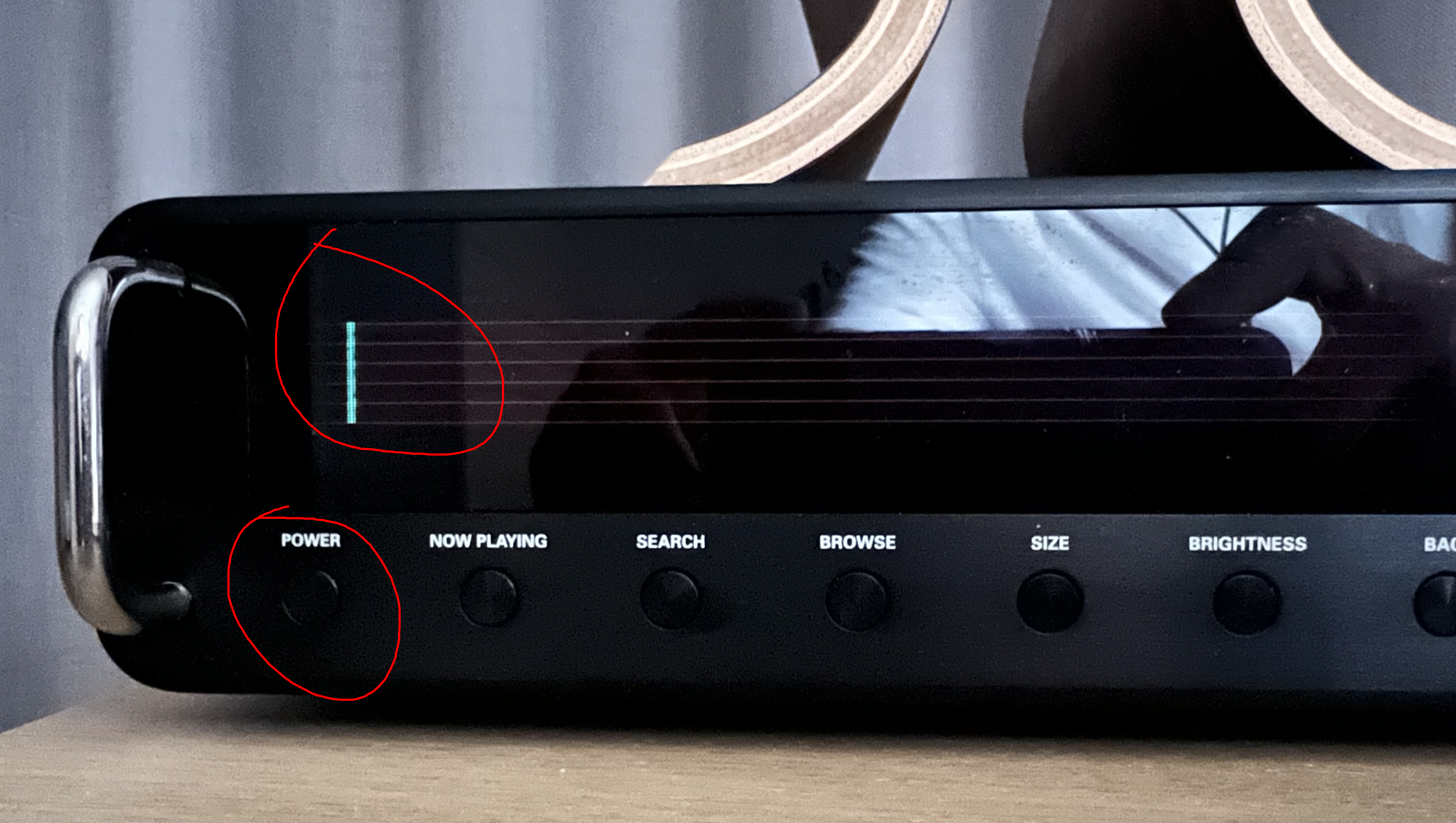

Power button directly on Transporter does not work with Roon. However power on/off works properly with IR remote ( with Roon server ). Any possibility to fix the button behaviour?

Displays standby function can be set to a blank screen in Roon, unfortunately it's not the same as display off, the displays are still on and show some pixels ( line at the display edge ). However displays can be manually switched off by the Brightness button on the remote or by Brighteness button directly on the device ( with Roon server ). Any possibility to either change the behaviour of the 'blank screen' or add a choice 'display off'?
