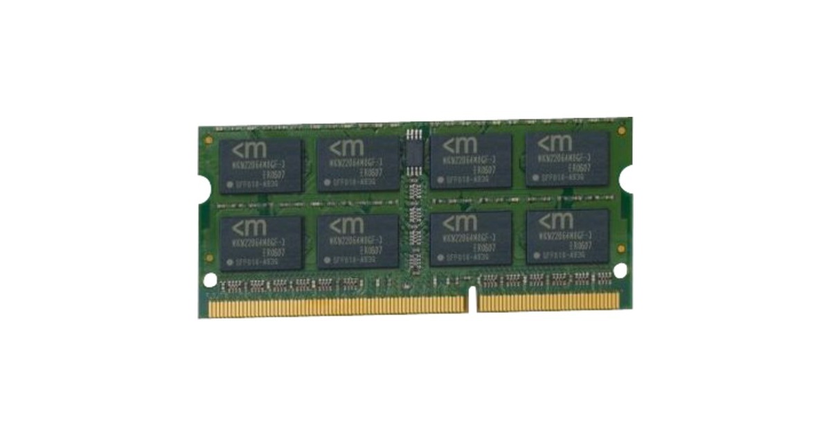

Hi Alfred,
This one works for me:
Mushkin 4 GB DDR3-1066 werkgeheugen
(991644, Essentials-Serie, Lite retail)
4 GB DDR3-1066
Capaciteit: 4 GB
Timings: CL7 7-7-20
ordered at: www.alternate.nl
Succes and thanks for your advice

@J_de_Hond
Today I received the Mushkin module and I placed it in the DS713+. The DiskStation got terrible, terrible slow and is unusable. The CPU is constantly working on 100%. It is so slow that I do not get any output on the Task Manager tab in the Resource Monitor app.
Do you recognize this behaviour on your DS713+ with this memory module?
