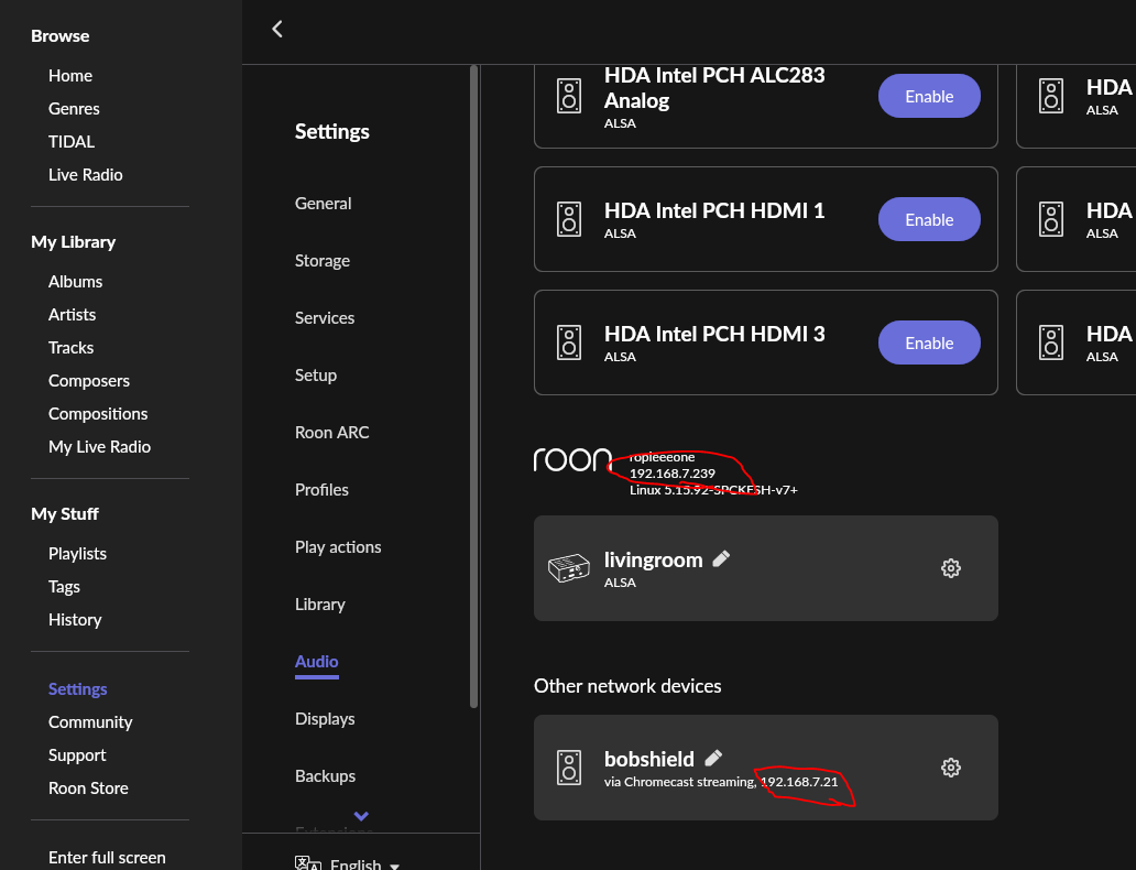

Another place to look is in your router “clients” page to verify what IP the router has given to the wired and wireless connections for the Sonos. Then look in Roon under Settings/audio and see what IP Roon is using for the device.
Here’s a screenshot from my system (I do not have a Sonos but Roon should show it the same way):
If you can’t access you router (or don’t know how to) you could look in Roon under settings/audio the see the IP, then unplug the ethernet cable and see what happens. If the sonos goes away (or changes to a different IP) then it was using ethernet.
