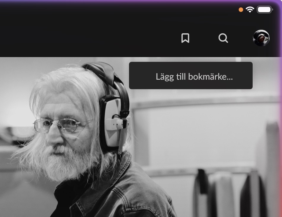

· This will be a difficult one; I have lost all of my bookmarks in Roon... I had about 20-ish bookmarks to directly view albums by a particular artist, of sampler albums etc. They are gone.
I suspect this might have happened due to a restore a few months back, but might as well be later. (I rarely use the bookmark menu, focus and tags are more in use)
