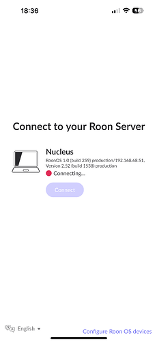

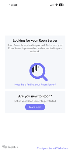

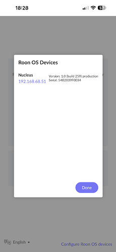

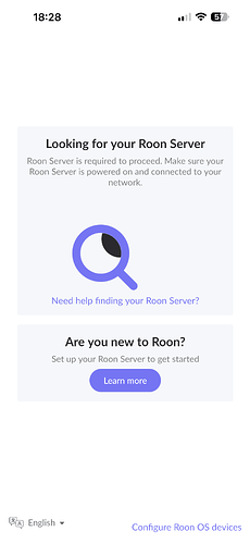

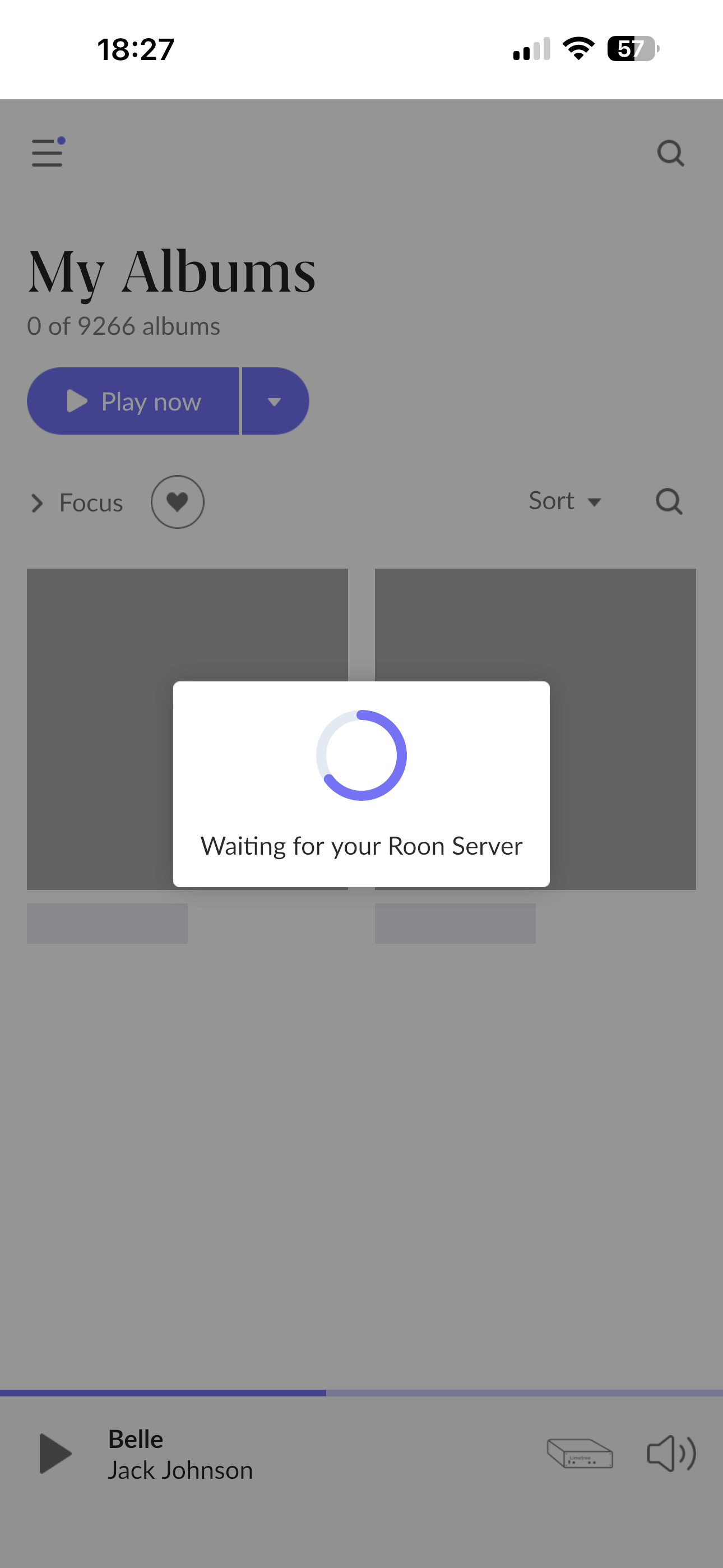

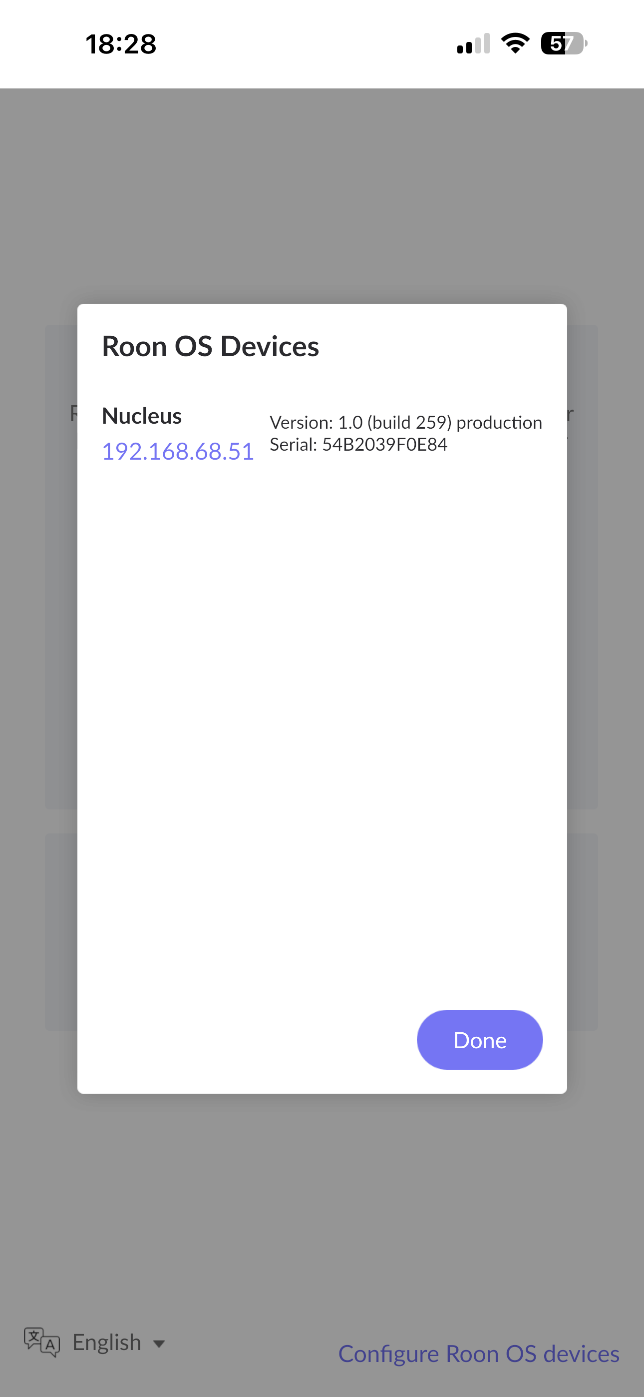

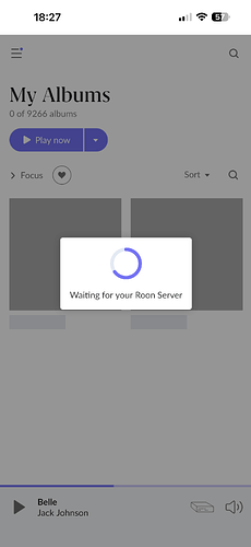

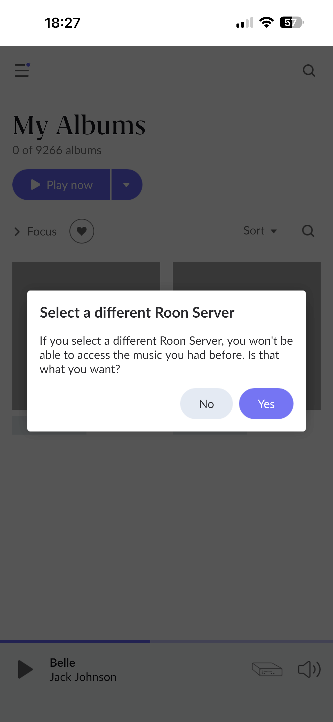

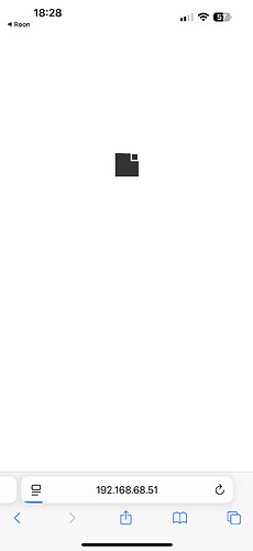

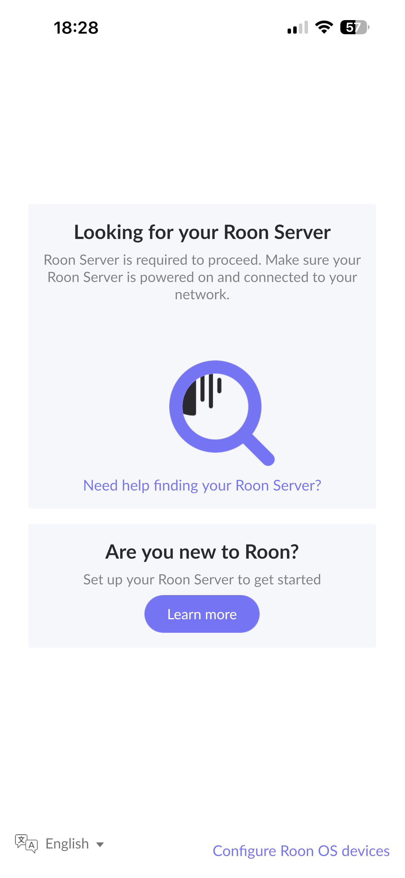

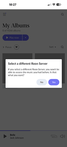

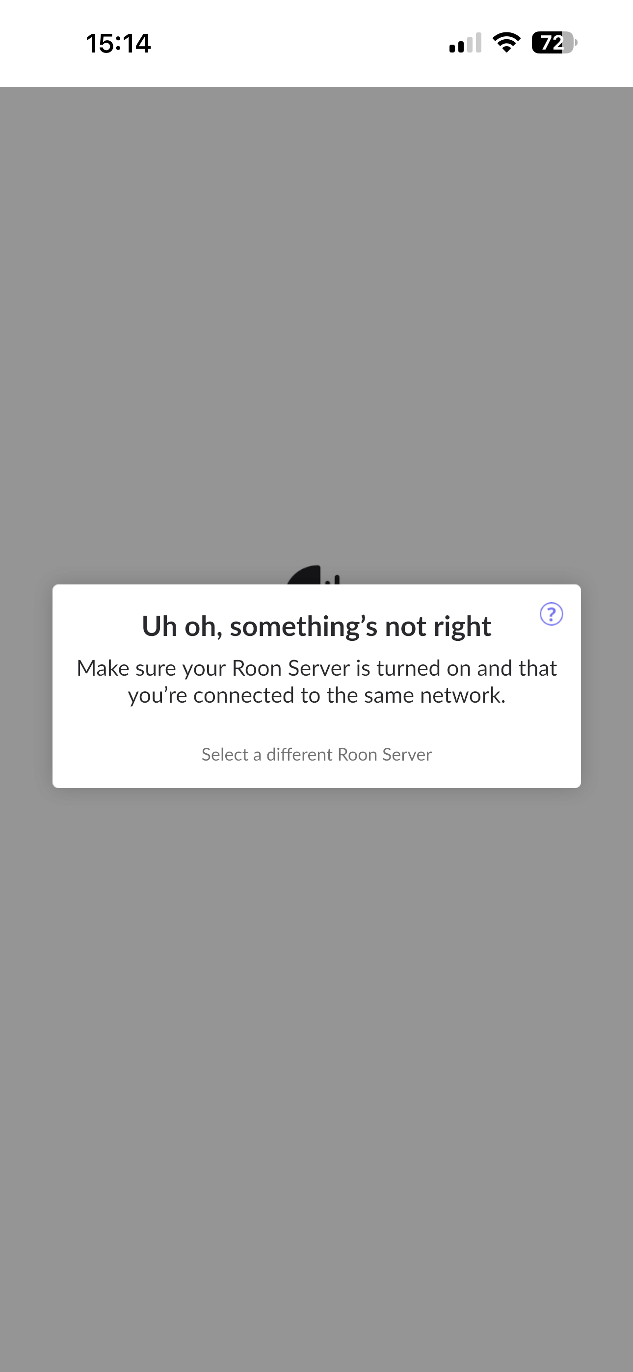

I lost contact with my Nucleus. The iOS app sees it occasionally, tells me to sign in and tells me I’m already signed in! Then it goes to the loading icon, after which I sometimes get a message saying something’s not right or it tells me the server cannot be found. This goes on in a continuous cycle.
I have wireless broadband connected to a TP-Link mesh node directly. In turn, the node is hard-wired to the Nucleus.

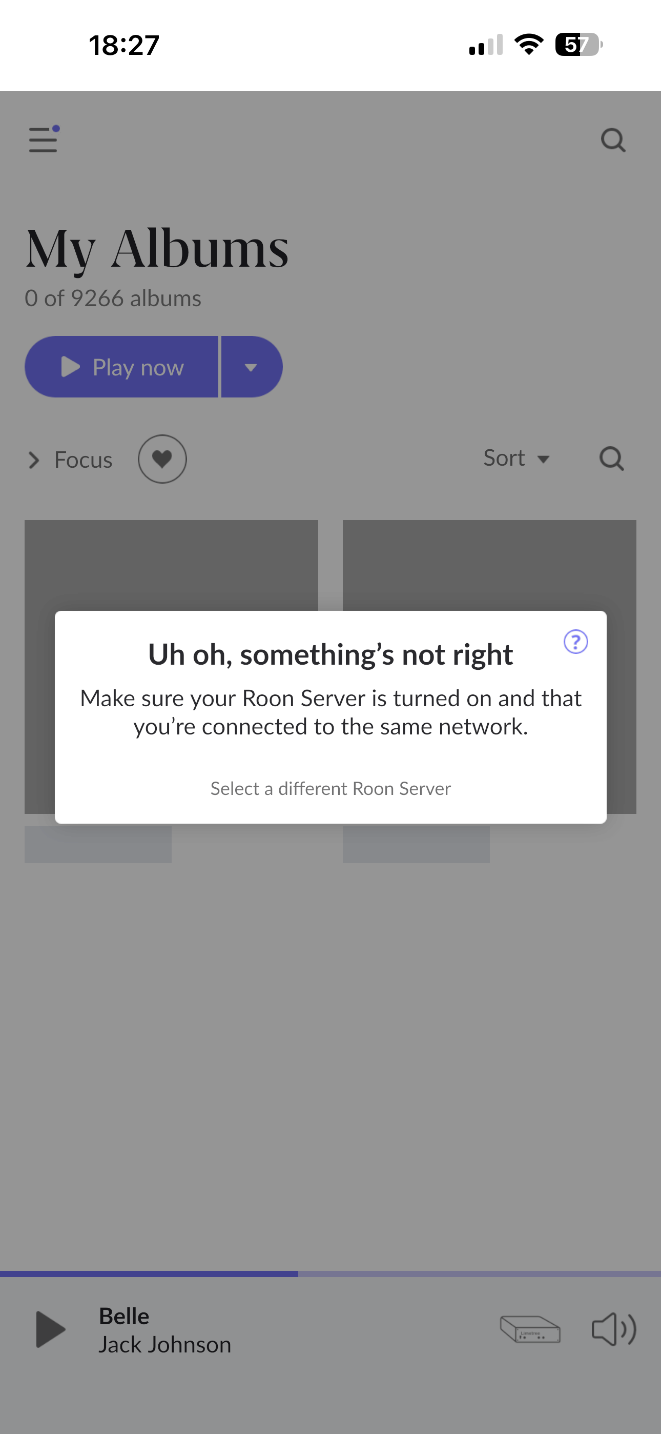

This was in the course of two minutes, taken, well, two minutes ago.
I have a feeling that part of the problem possibly lies in that it saw two Roon cores, the other being my MacBook. Having said that, I unauthorised the MacBook (which has never been designated as a core) and the problem continues.

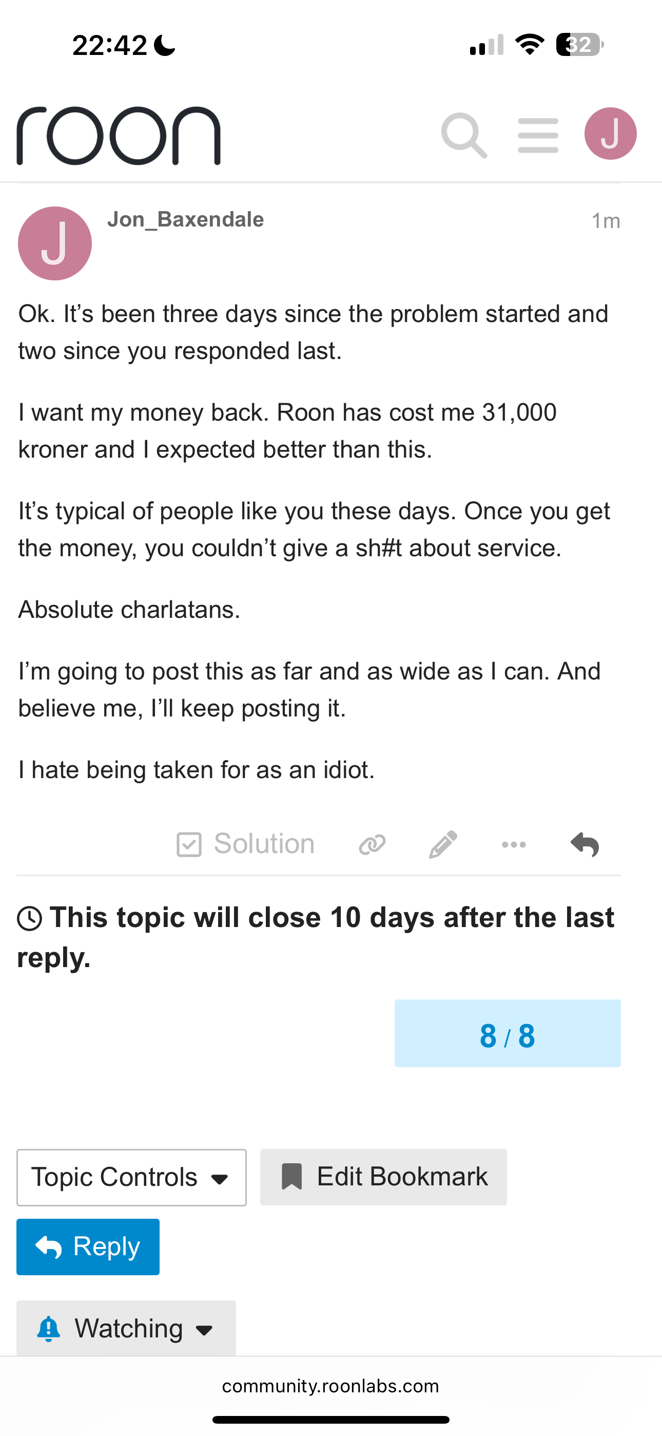

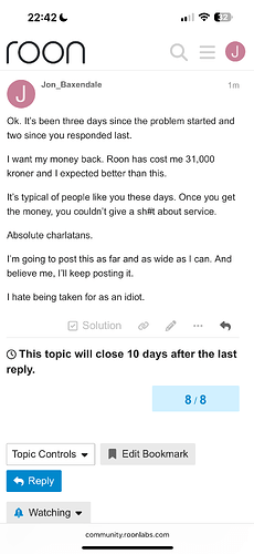

Ok. It’s been three days since the problem started and two since you responded last.
I want my money back. Roon has cost me 31,000 kroner and I expected better than this.
It’s typical of people like you these days. Once you get the money, you couldn’t give a sh#t about service.
Absolute charlatans.
I’m going to post this as far and as wide as I can. And believe me, I’ll keep posting it.
I hate being taken for as an idiot.

You mention you have a mesh network - we’re seeing some network-related errors from a recent Nucleus diagnostic report. Could you temporarily set up your Nucleus via ethernet to your primary router?
We’re also seeing a potential for your remote devices connected to different subnets within your local network, can you review your router settings > devices list and confirm you don’t have two active subnets?

When I am able to get to choose my core, for some reason it gives both my MacBook and the Nucleus. However, the MacBook has never been used as a core.
I have found the problem. Is this a glitch in the software? When I try to upload to the server files stored on my MacBook, Roon seems to think that the MacBook is the core and gets confused. I found that I had to unauthorise the MacBook and then everything goes according to plan.
