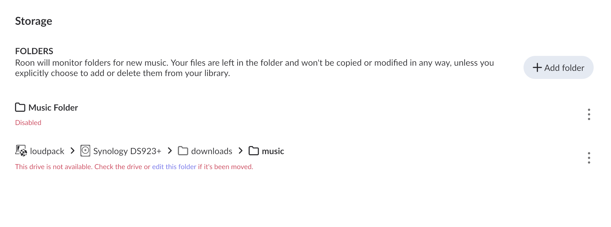

When I restored from backup, the Music Folder was disabled, and there was another folder below that had some error on it, which I removed. I had Music Folder then route to where the folder is in my Synology’s file system (hasn’t moved since last backup or ever), and that the docker compose mapped to

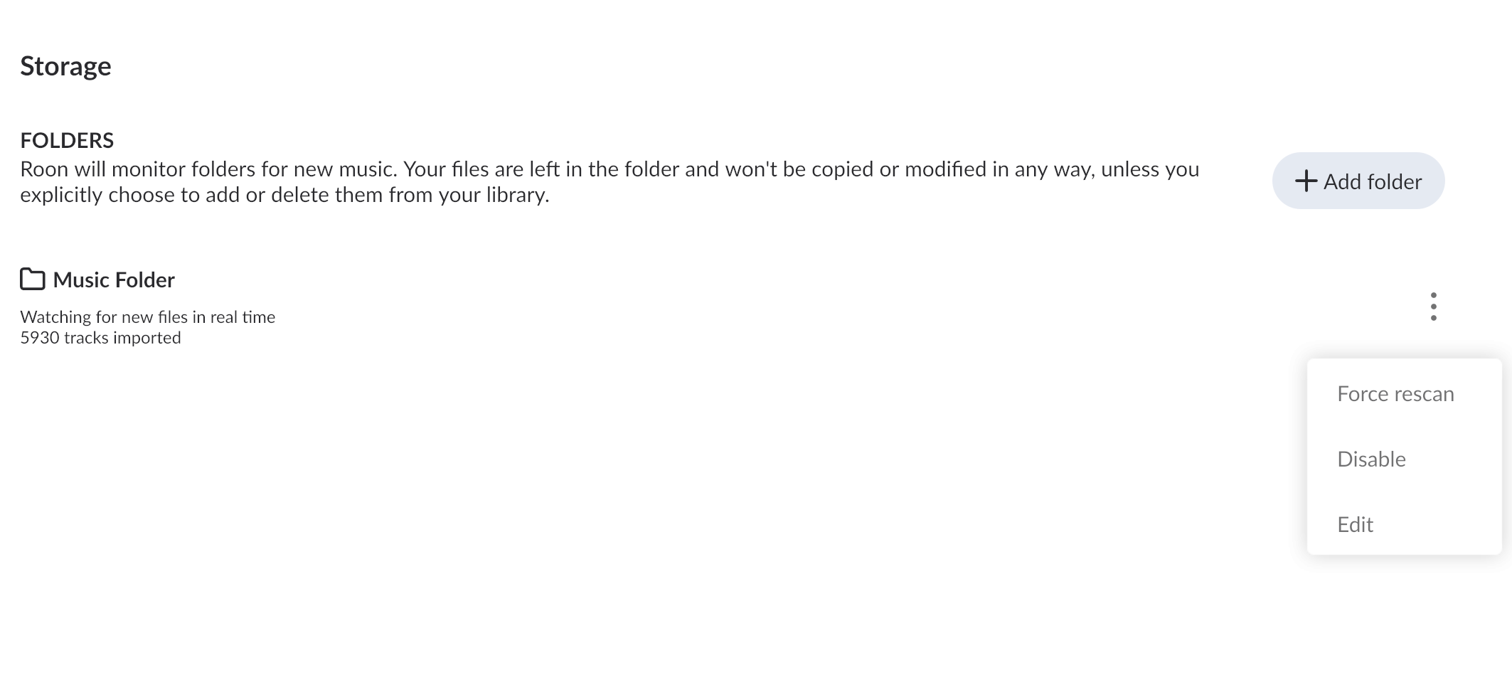

This is what I got, and what I got earlier. I made the Music Folder point to the downloads/music shown below (which is also what the docker compose maps to), and deleted the bottom folder, which is when I made the ticket. Let me know what to do next to solve. Thanks
I followed your instructions a couple days ago and posted what I see. Can I continue to get support here? I need the old folder to be Music Folder and have my album groupings carry over.

Step 2: After restoring, edit the folder path, don't re-add it
After restoring from backup:
  1. Let Roon start up with the folder still showing as disabled/unavailable (do NOT delete it)
  2. Click the three-dot menu → Edit on that old folder entry
  3. Navigate it to your current Docker music path (/downloads/music or wherever it's mounted inside the container)
  4. This lets Roon re-associate the existing backend ID with the correct path — your edits stay intact

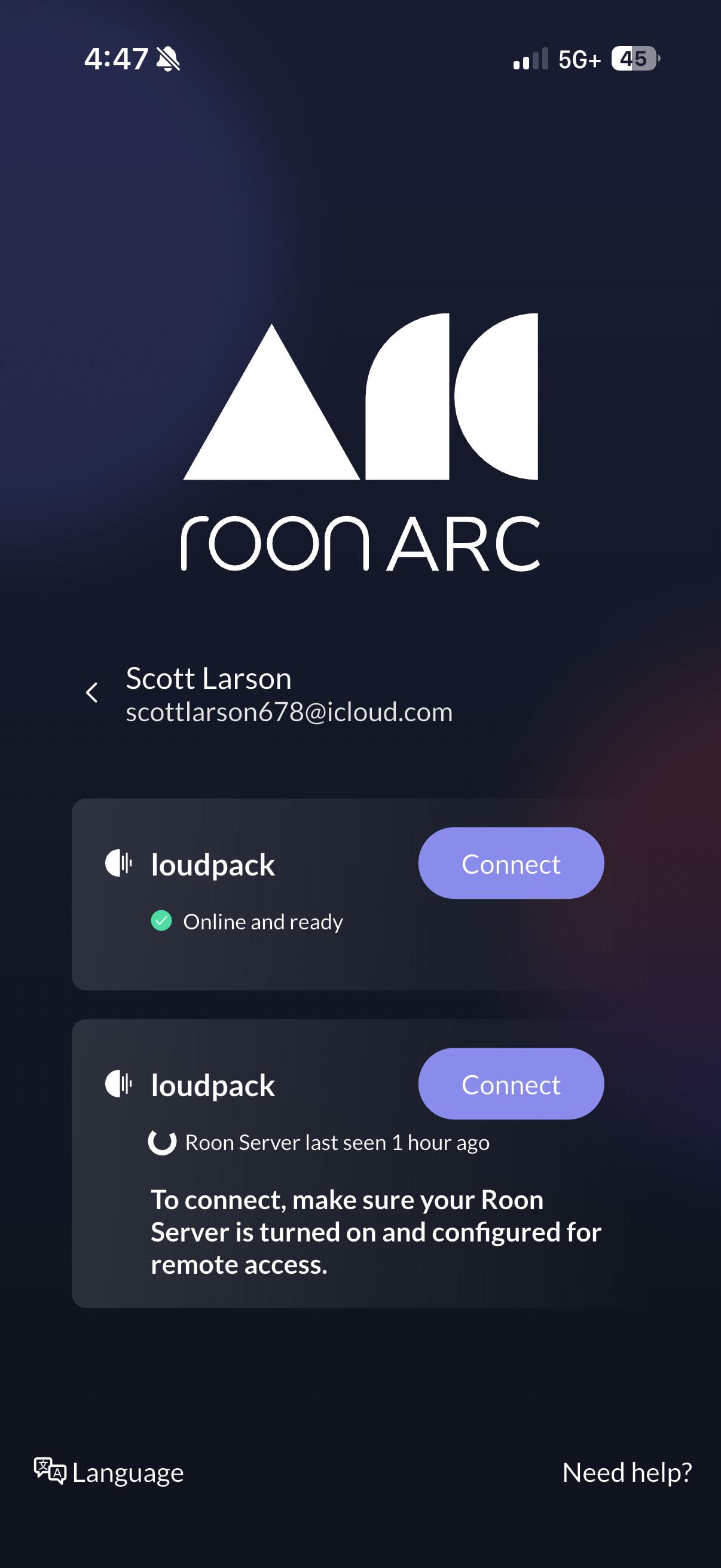

So far so good. Will old entries of my server that technically do not exist anymore be removed from the selection screen eventually like here on ARC?
Yep, old servers appear for a while but this will time out on its own
