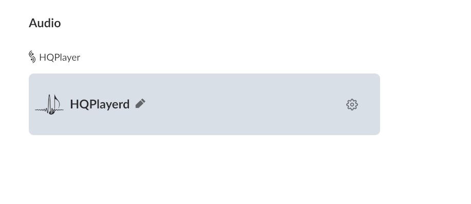

Every 12 seconds it appears for 1 second:

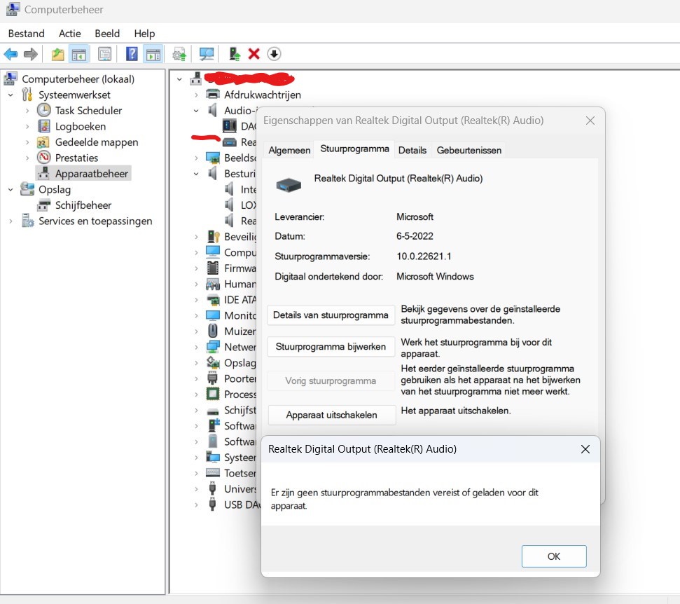

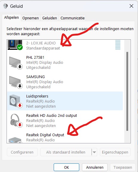

but devices linked to my PC sees it once every 12 seconds. Via my PC I can listen to Qobuz via my Loxjie DAC. That connection works. The Loxjie can also be seen in the Windows sound program and is set as default. You can also see the new optical output there:

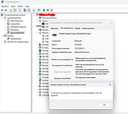

Unfortunately, updating by Realtek’s drivers didn’t fix anything. No drivers would be needed and installed for the Digital Output:
Very strange: The device manager window of my PC disappears every time one second after 12 seconds and that only if I have activated Roon. That must have something to do with each other. I just don’t know what. Someone who knows?

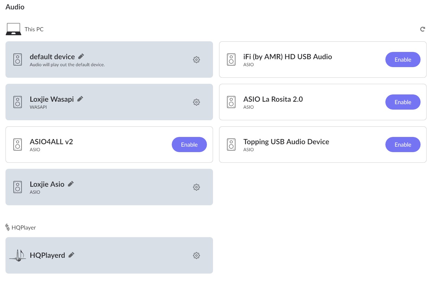

The PC Zone I’m missing is the Zone with the Loxjie DAC (the default didn’t work anyway) Wasapi and Asio (2 grey bars).

The Loxjie doesn’t have problems with the PC while it functions with Qobuz and all other programs with audio on my PC.

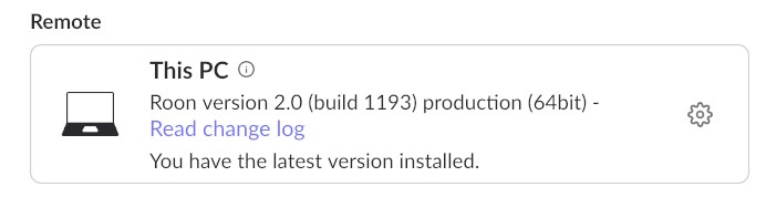

My PC audio devices are nowhere to be seen in Roon. Not on the laptop, not even on the PC itself and not on my iPhone/Pad. But in Roon> Settings> About the PC can be seen:
I have now also connected the PC directly to the router, but that doesn’t matter, the devices connected to my PC remain invisible in Roon> Settings> Audio.
I find it striking that Device Manager in Windows disappears every 12 seconds (search/scan?) and only does that as soon as Roon is started and Roon also shows the same behavior but in reverse: every 12 seconds the connected devices appear for 1 second .

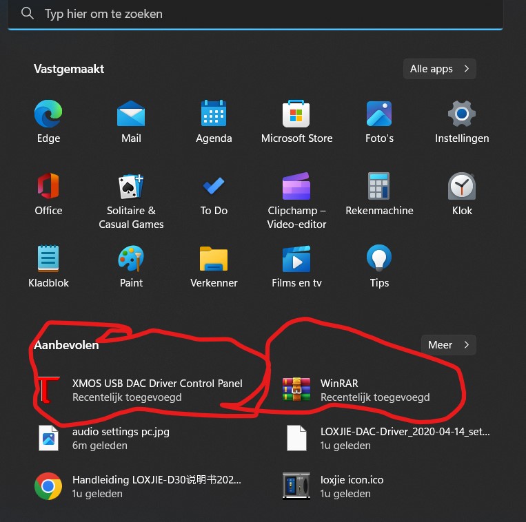

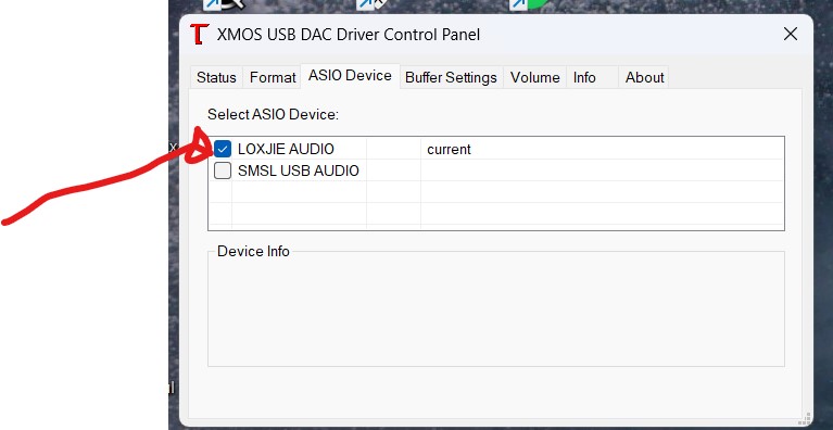

My PC help helped me a lot. He suspected that there was a problem with the drivers of my Loxjie D30 DAC. Roon was apparently always looking for that, but was not allowed access, hence the on/off situation both in Roon and in the device manager of my PC. I don’t understand how and why the old drivers stopped working because I hadn’t done anything about it (installed a year earlier) and it concerns the same drivers from 2020. In any case, removing and reinstalling these drivers was the solution. Roon again showed my PC with the connected devices in Settings> Audio. However, a number of settings in the sound program of my PC had to be adjusted before sound came out of the speakers. This first succeeded with Qobuz, although the speaker icon in the taskbar was muted, but there was sound. Also in Roon > Settings > Audio I had to set something like the volume control. Unfortunately still no sound although it was playing. In the Thesycon XMOS USB Driver Control Panel, the check mark had to be checked for Loxjie Audio.
Yes and then sound also came via Roon > PC > Loxjie ASIO. Qobuz> PC> Loxjie Wasapi already did it and the speaker icon is no longer muted. I used to be able to play them right away, but that is no longer possible and that is of course not necessary.
