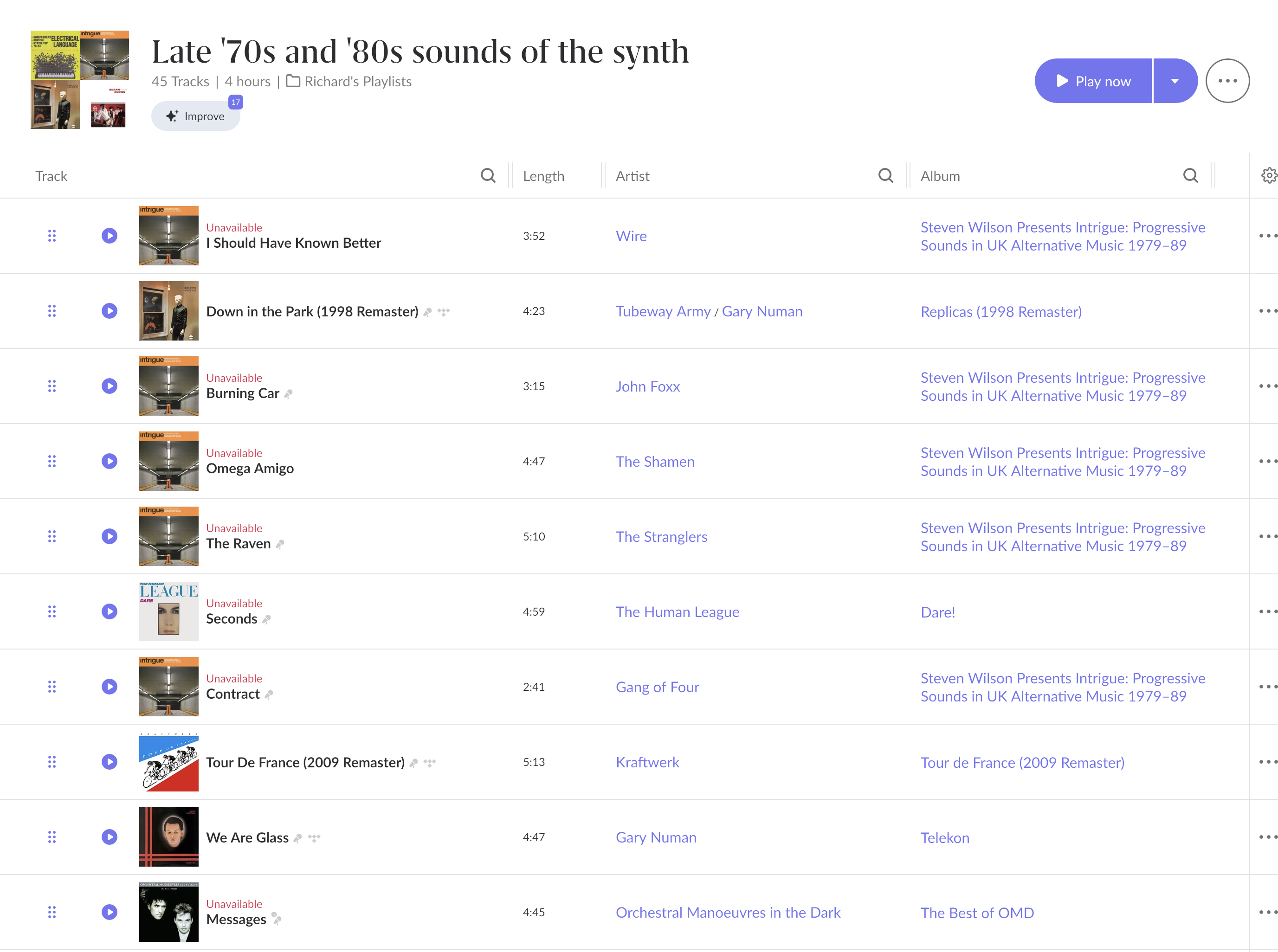

I can access all my local files but much of the organisation of these files within Roon has been lost e.g. all of the albums I classified as ‘favourites’ are no longer classified as such; also lost are all of the changes I have made to album artwork and display; grouping together separated discs within albums. Previously set-up playlists still exist but all the local files cannot be located from the play list itself saying the tracks are ‘unavailable’. But when I search separately on the local disk to which these playlist tracks refer, I can find them and play them from the album, therefore, they are not missing from the SSD.

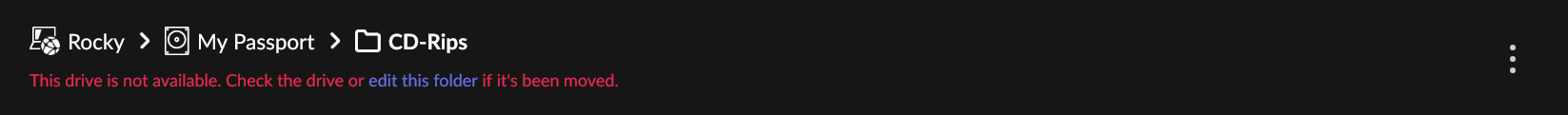

If the server is seeing two different storage locations then under storage you should see the working New location and a storage location that has the a message about not being available. In that message you should see a text option (which is clickable) to “edit this folder”, like below…
If this is the case, you want to disable the current new storage location and then edit the path of the old location to new location. This should after Roon is done re-syncing, remove the info from the duplicated drive and restore the data associated with the original storage location.

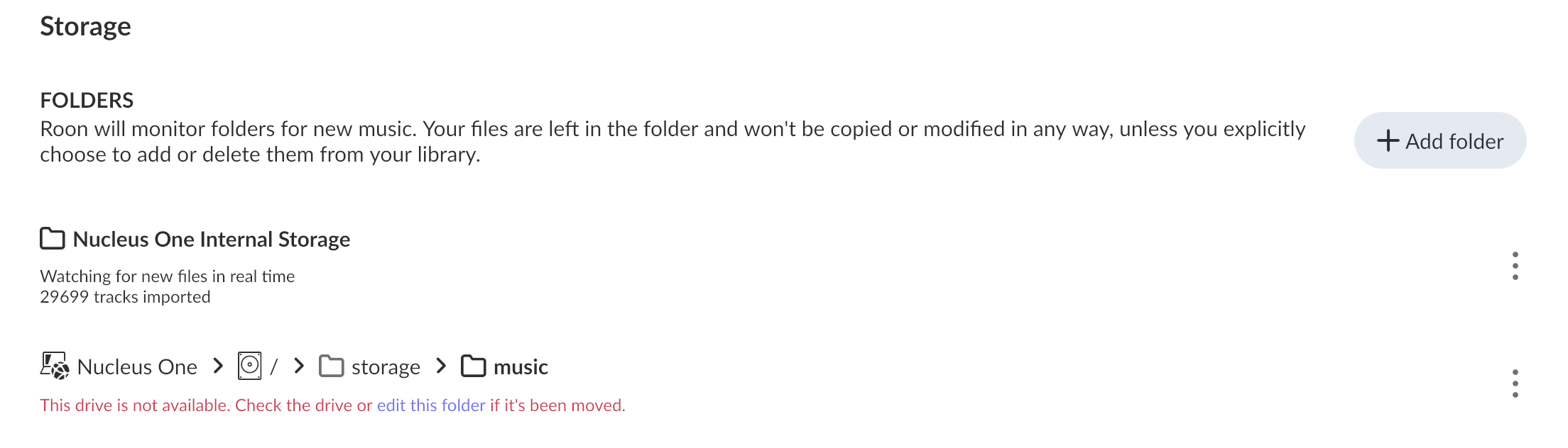

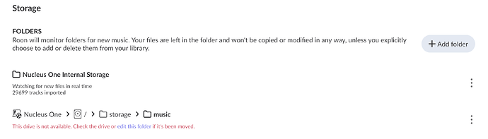

It might help to post a picture of storage (assuming you did not delete any locations).
OK thanks, seems like this is the case as per this screen grab, will try as instructed

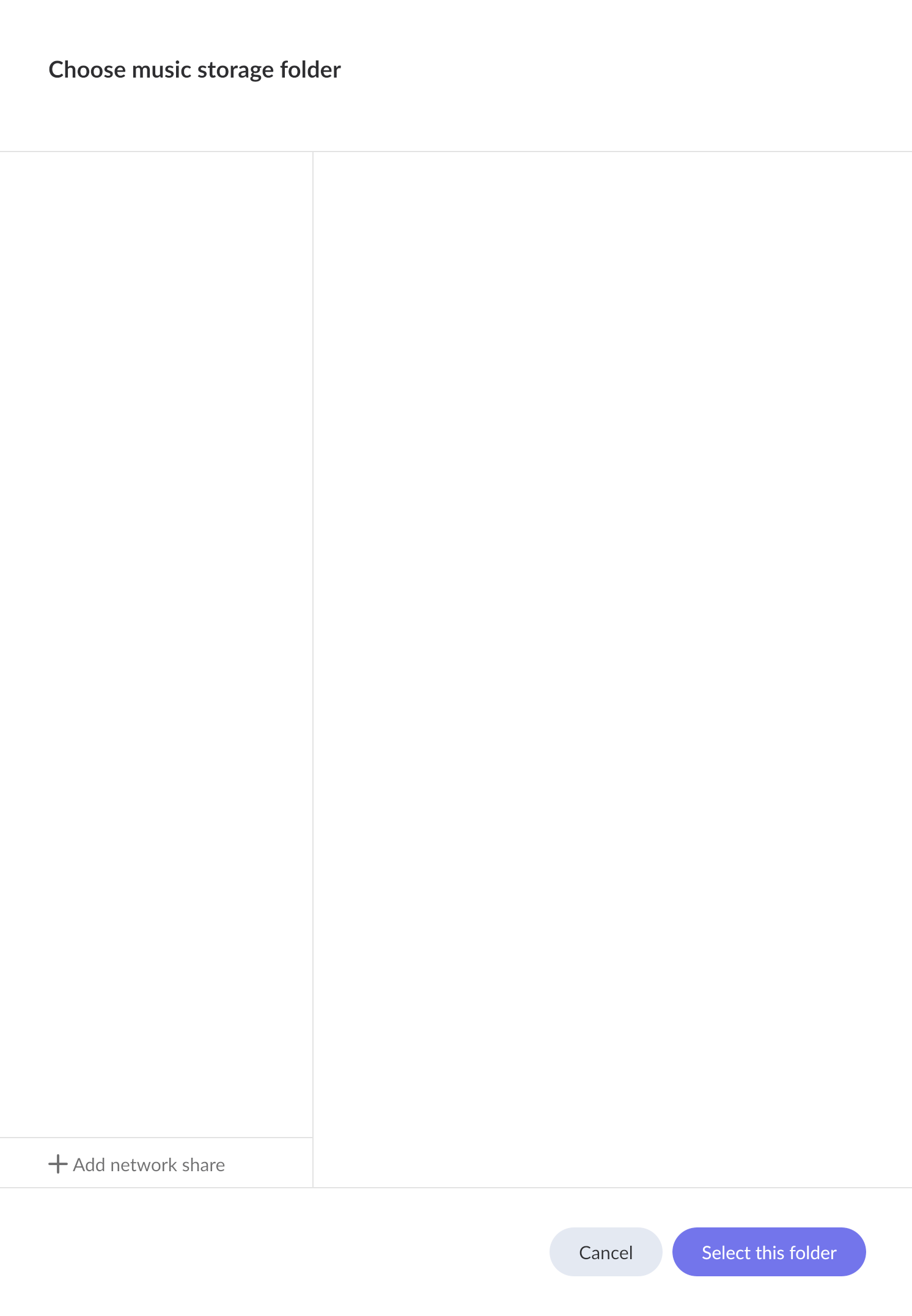

I click on ‘edit this folder’ but no music folder options appear for me to navigate to

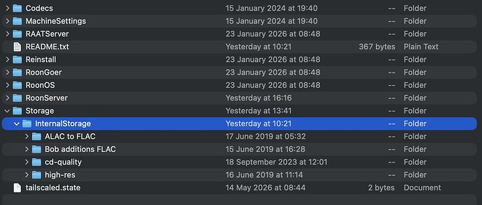

Looking at the Nucleus from my Mac, all the music is in ‘Internal Storage’
