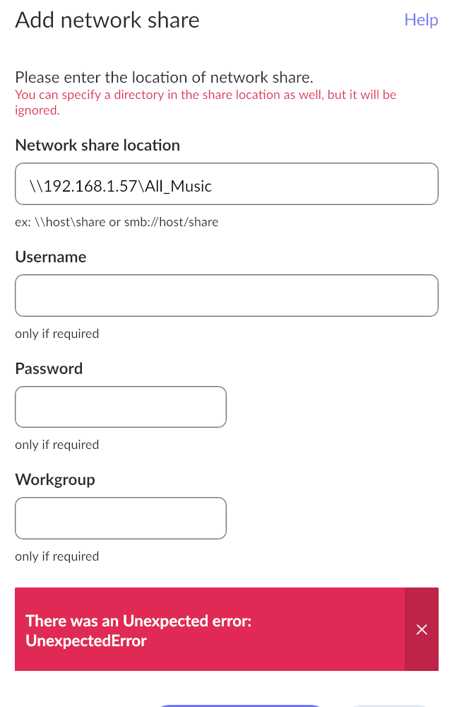

This has been a rock-solid system for me. I recently upgraded my LUMIN D2 to a LUMIN T2 and with it, I upgraded my ethernet cables to Wireworld Chormas/Starlight. My first step was to replace the cables and then connect the T2. I believe, something I did caused the IP address to update and now I can not add the NAS location. I can access the location via Windows explorer and both the LUMIN App and JRiver can access and play the files as they always could. Just not Roon. I’ve tried EVERYTHING I can think of, including going back to the old cables. I’ve tried Rebooting, reinstalling, I’ve followed suggestions from support at SonicTransporter all to no avail. Any thoughts?

Thanks again. I’ve checked those out as well. When I finally figure this out, it’s likely going to be something simple and it’s really going to make me mad. The weird thing is, this set up has been working flawlessly for 1.5 years. I made no setting changes of any kind. I merely hot-swapped the ethernet cables. I think that caused an IP refresh. But I’ve carefully typed in the new IP to no avail. I even tried going back to the old cables. But windows can access the NAS, all my mapping is fine and even the KEF and LUMIN apps can find the NAS directory…same as they always have. Just not Roon. Weird and frustrating.

In upgrading my D2 for a T2, as well as a cable upgrade, my NAS IP address changed. I have since made it a static IP address but I CAN NOT get Roon to add music share folder. I’ve tried every nomenclature available. I’ve made no other changes to the settings.
I can see the drive and share everywhere else. I’ve changed nothing. I can access the file with Windows and JRiver continues to find the files. All network backups work. The only thing broken is Roon.

Hey @Thomas_Eviston, thanks for your patience – I’m sorry we couldn’t get back to you sooner! In one of your screenshots, I noticed you added the network share like this: \\Ev_Media.local\All_Music
Can you try with \\Ev_Media\All_Music?
Another thing I noticed:
As a troubleshooting step, can you enable this setting and try again? After that, try adding the admin credentials in Roon instead of leaving them blank.
