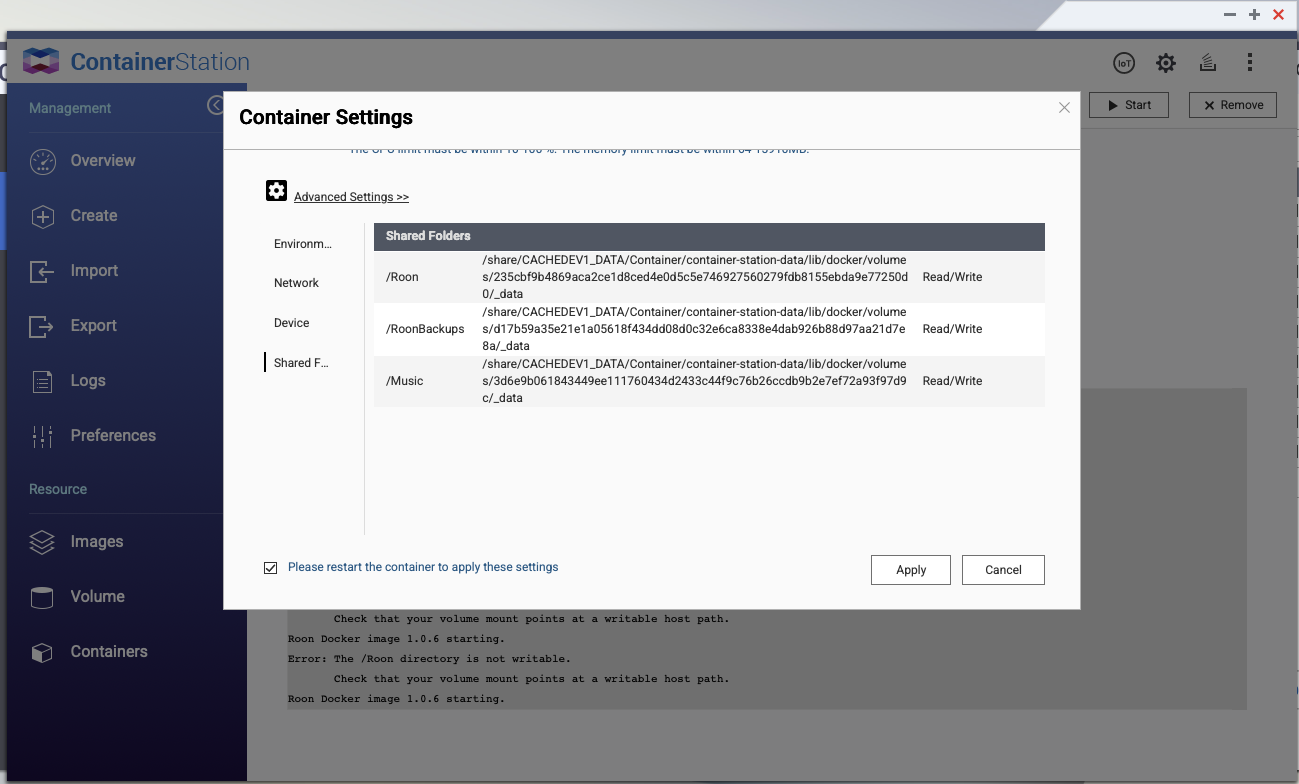

Hi Connor - thank you for your kind assistance. So have managed to create a roonserver App within Container Manager. I could not see where to execute the docker compose down && docker compose up -d but there was an option to restart which I clicked on.
I also looked under the Container Manager / Resource / Images tab and see 2 docker images: (“latest” and “latest-data-1” which has the newer Image Created date. Under Actions I tried to create a new container using latest-data-1. I can create the Container but again I think my file paths are an issue. I deleted the first attempt I tried again (container name: roonserverdocker) but this time I looked into the Create Container - Advanced Settings>> where I am presented with 4 tabs: Environment / Network / Device / Shared Folders. It offers 3 further options: New Volume-Mount Point / Volume from host-Mount Point and Volume from container. Each section has an “Add” option but only the first option is repopulated with:
[Blank editable field] Mount Point= /Roon
[Blank editable field] Mount Point= /RoonBackups
[Blank editable field] Mount Point= /Music
I populated each respective blank editable fields with each of the following:
/share/RoonSysDrive/Container/roon:/Roon
/share/Volume1/RoonMusic:/Music
/share/Volume1/Backups/RoonDB_backups:/RoonBackups
I then hit Create. The Summary screen appears and at the bottom of it is “New Volume” with 2 columns Name and Mount Point. Nothing is populated under Name and under Mount Point /Roon /RoonBackups and /Music are populated in each of 3 rows.
I then hit “Ok”. It shows some activity. I then move to Container Station Resource Containers tab and click on roonserverdocker docker item. By this time the activity has stopped. I hit “start” for that Container and receive the following error message:

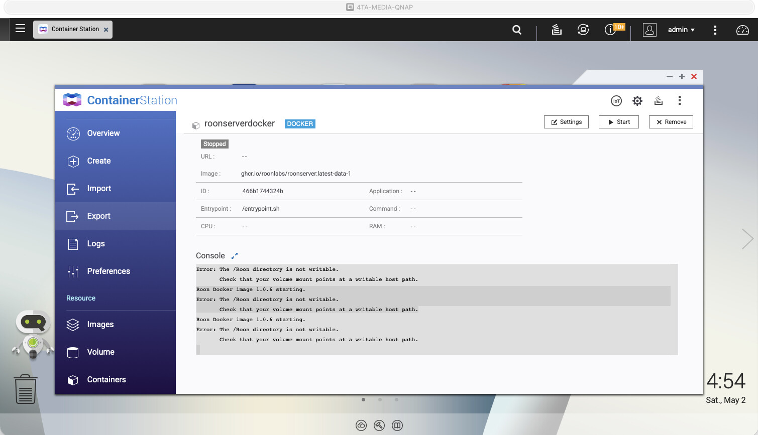

Roon Docker image 1.0.6 starting. Error: The /Roon directory is not writable. Check that your volume mount points at a writable host path.

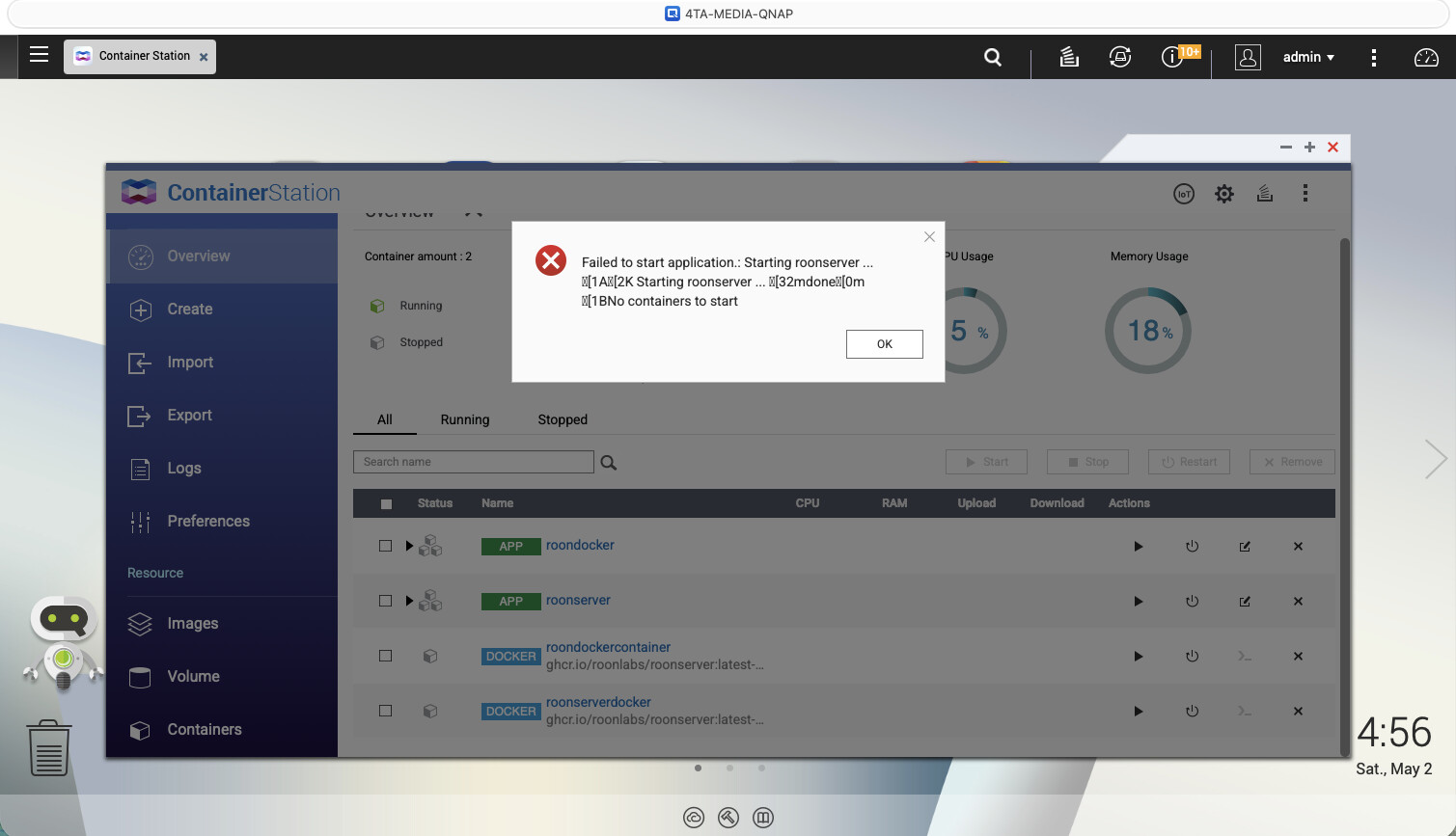

When I try to start the roonserver application I also get an error message (see screenshots attached) but basically reads that there are “No containers to start”.
Your further assistance would be greatly appreciated.

Hello @Ado,
Apologies for the delay in getting back to you! Thank you for the detailed breakdown and the screenshots—it makes it very easy to see exactly where things got tangled up.
First, let’s address your question about the docker compose down && docker compose up -d command. Please completely ignore that! Those instructions are for users running Docker via a command-line interface (SSH). Because you are using the QNAP Container Station graphical interface, you do not need to run any code commands. Clicking the “Restart” or “Recreate” buttons in the UI accomplishes the exact same thing.
Why the “Not Writable” Error Happened: I see exactly what went wrong in your “Advanced Settings” attempt. When using the manual Container Station creation screen, the system expects you to split the path into two distinct boxes. You cannot paste the entire string (e.g., /share/RoonSysDrive/Container/roon:/Roon) into a single field.
That string actually represents two halves separated by a colon:
  • Host Path (The left side): The physical location on your QNAP (e.g., /share/RoonSysDrive/Container/roon).
  • Mount Point (The right side): The location inside the Docker container (e.g., /Roon).
By pasting the whole string with the colon into one blank field, QNAP created a malformed folder name, which triggered the permissions error.
The Easiest Way to Fix This: You do not need to manually map these boxes one by one. The absolute easiest way to set this up is to use the Applications feature in Container Station, which allows you to just paste Connor’s code directly.

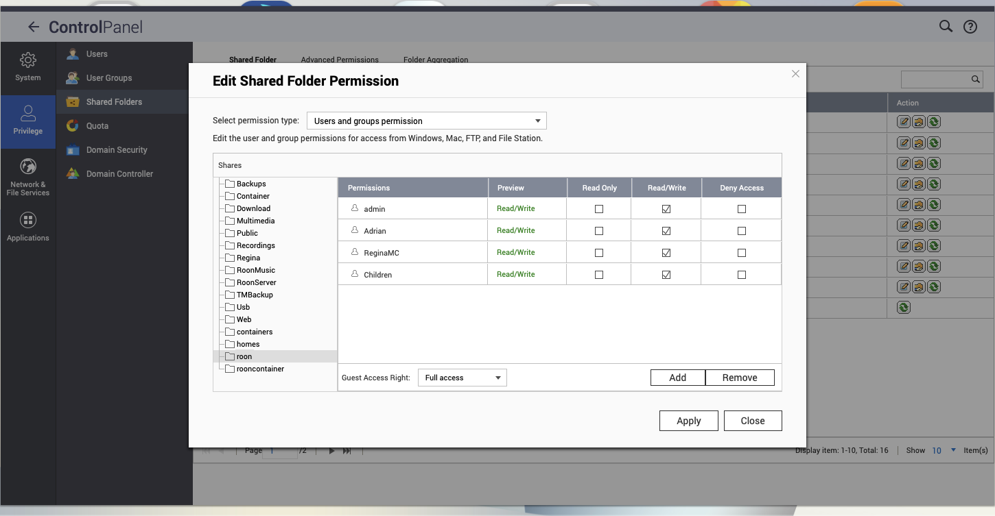

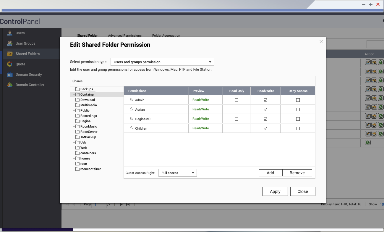

2. Check Read/Write Permissions
Even if the folder is in the right place, Container Station will fail to create the database if your user account doesn’t have explicit permission to write data into it.
  1. Open your QNAP Control Panel.
  2. Navigate to Privilege > Shared Folders.
  3. Locate the Container folder in the list.
  4. Click the Edit Shared Folder Permission icon (it usually looks like a folder with a person or a lock) under the Action column.
  5. Ensure that your admin user account (and the account you use to log into QNAP) has the RW (Read/Write) box explicitly checked.
Once you have confirmed the folder is on the SSD and that your account has full Read/Write permissions, try creating the application again using the YAML code in the Applications tab of Container Station.

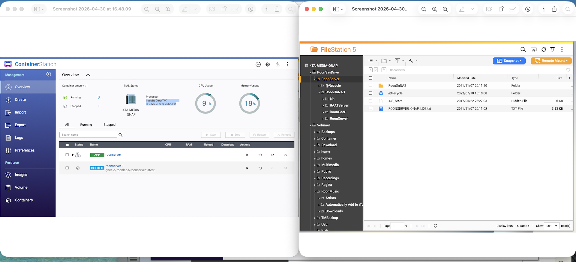

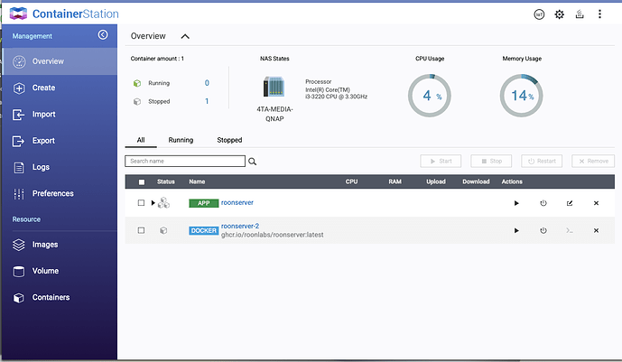

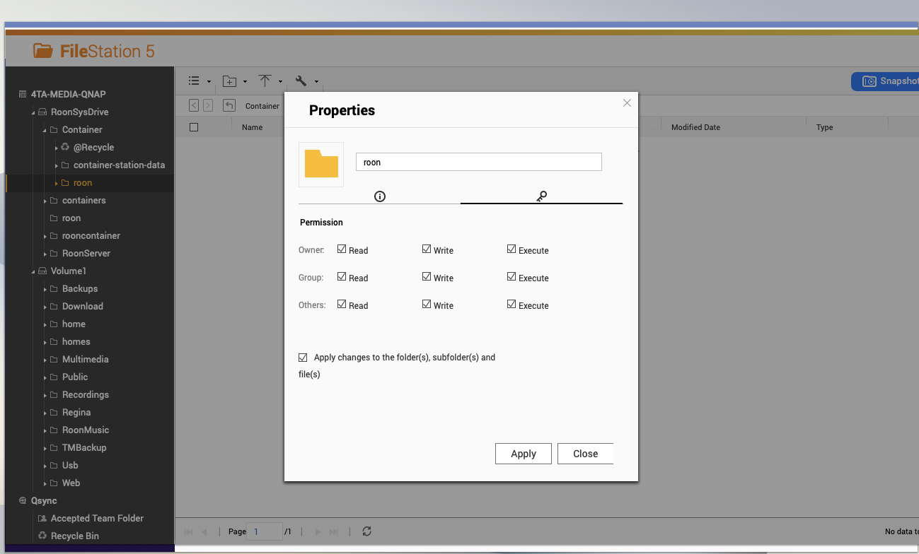

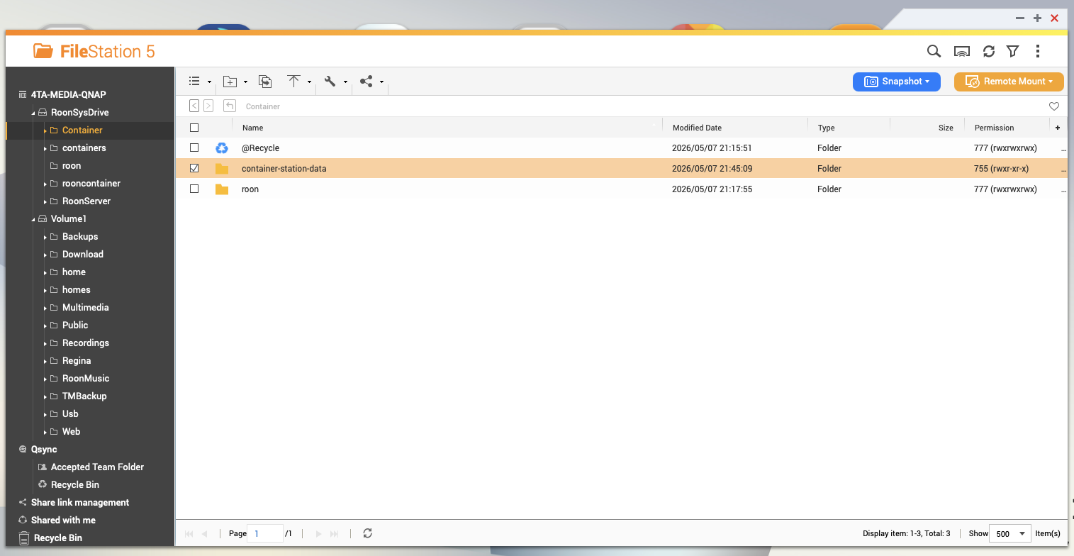

Hi - thank you for re-opening this thread. I have attached a series of ScreenShots which I hope are helpful. I now have an App and Container Docker created. I checked on Control Panel for Shared Folder permissions (see shots attached). They all appear correct to me. When I start Roon Server - I get an error message stating “Failed to start application, Starting roonserver. No containers to start”.

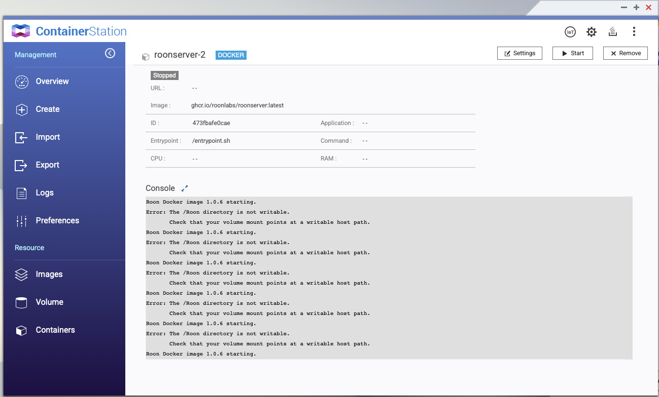

When I look in Container Station for roonserver-2 DOCKER, the Console shows the message " Roon Docker image 1.0.6 starting. Error: The /Roon directory is not writable. Check that your volume mount points at a writable host path.
When I look in File Manager - under my SSD named RoonSysDrive, the Container folder exists and has 3 folders, (@RecycleRecycle, container-station-data, roon). The folder container-station-data shows permission 755 (rwxr-xr-x) but the other two are (rwxrwxrwx).

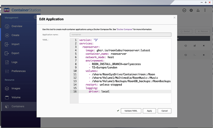

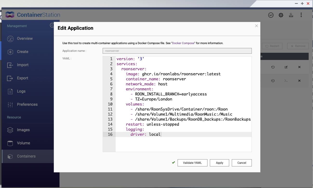

The script used to create the Container was as follows:
version: ‘3’ services:
roonserver:
image: Package roonserver · GitHub
container_name: roonserver
network_mode: host environment:
  • ROON_INSTALL_BRANCH=earlyaccess
  • TZ=Europe/London volumes:
  • /share/RoonSysDrive/Container/roon:/Roon
  • /share/Volume1/Multimedia/RoonMusic:/Music
  • /share/Volume1/Backups/RoonDB_backups:/RoonBackups
restart: unless-stopped logging:
driver: local
Your continued support is greatly appreciated. Best, Adrian

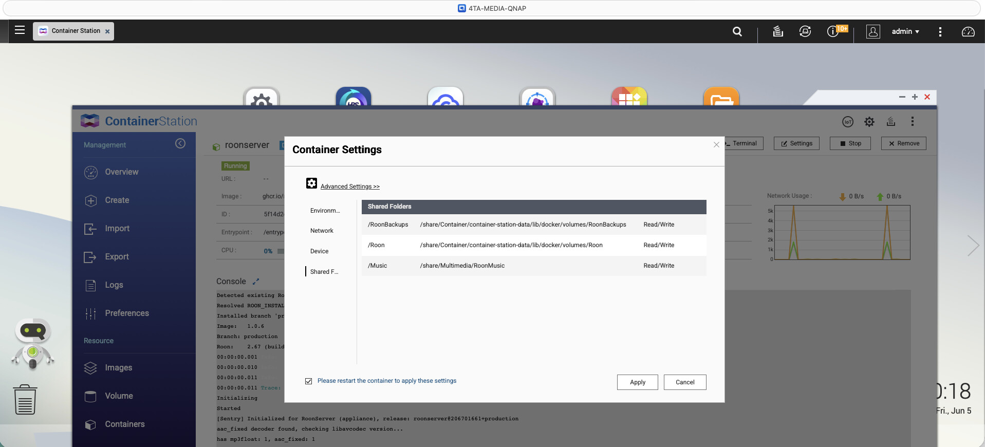

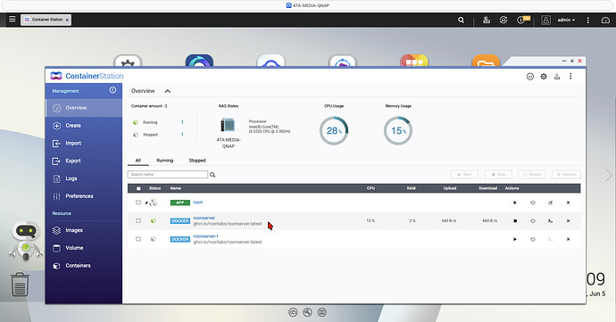

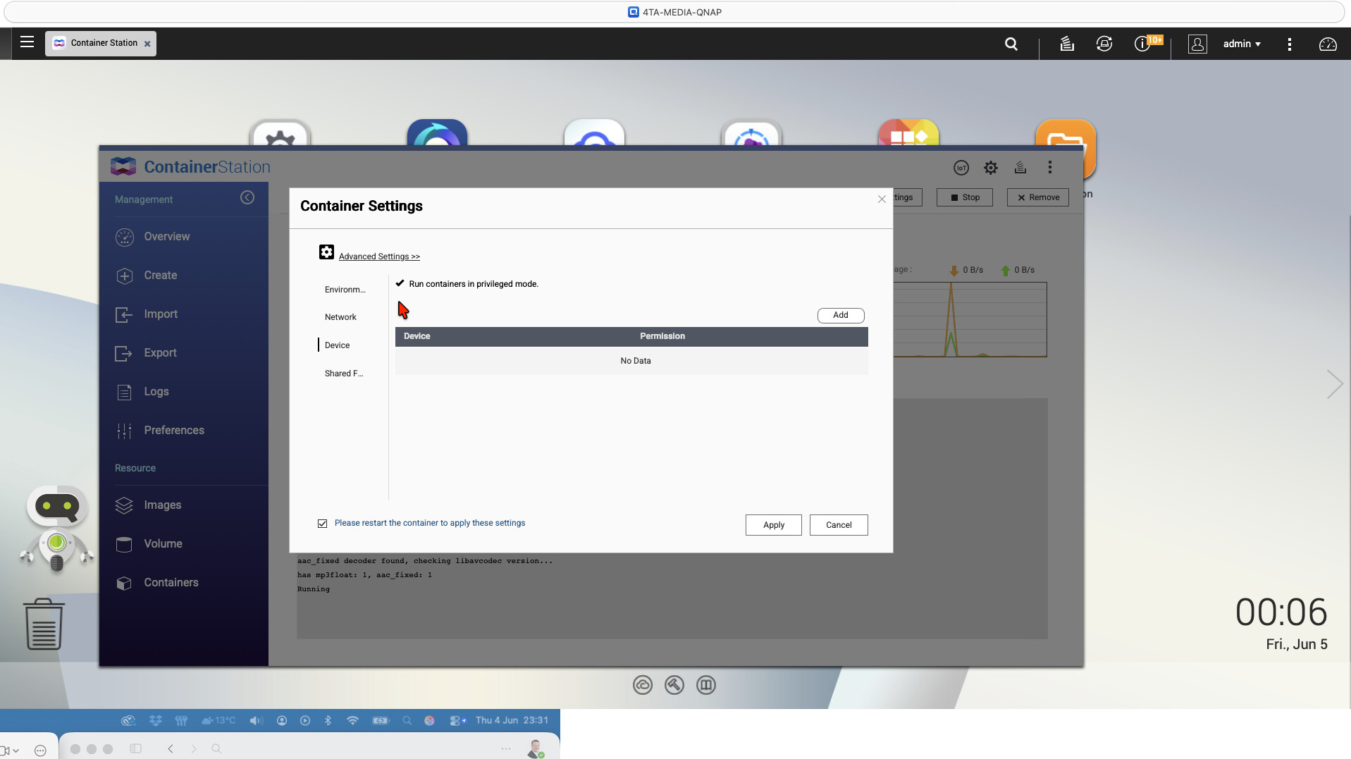

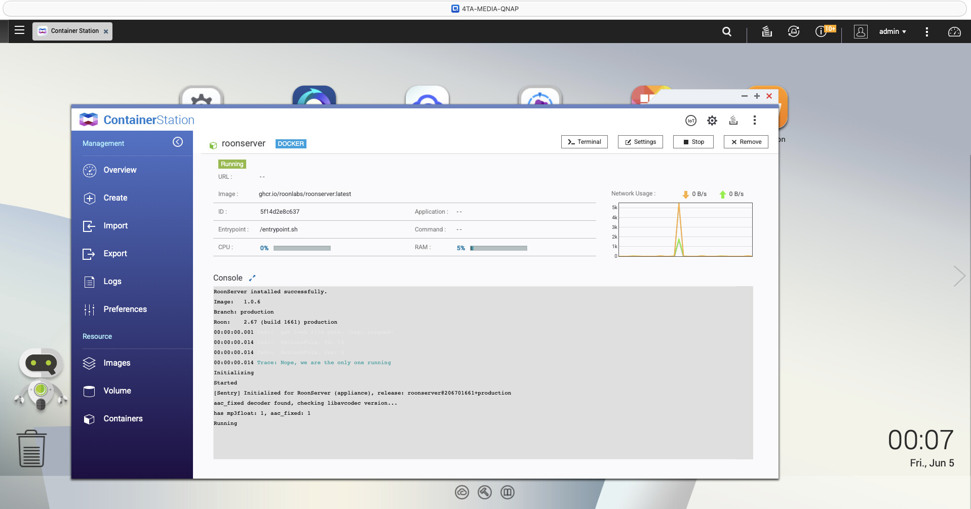

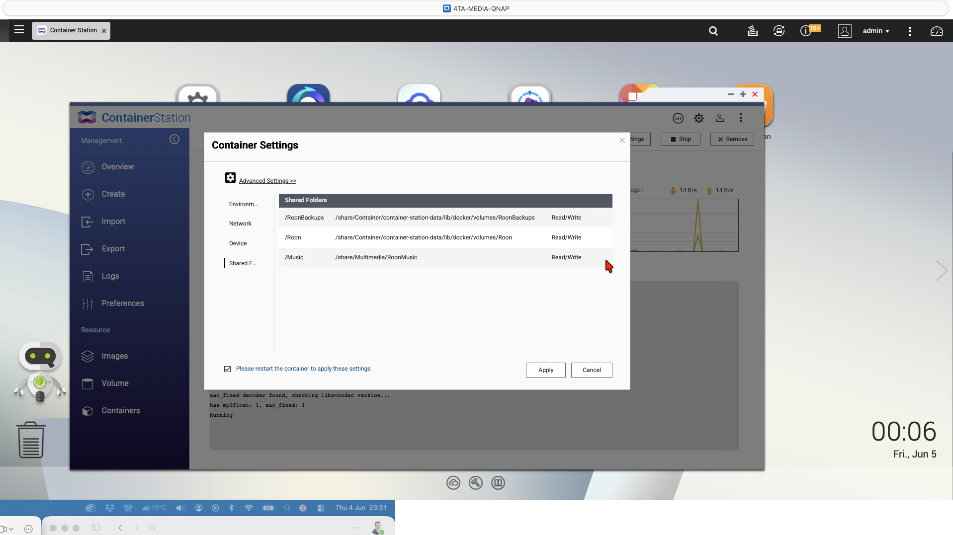

@benjamin Thank you for your encouragement. Still not there - but maybe some progress. See screen shots attached.
I removed the old App and old Docker. In Container Manager I looked under Volume and “Pruned” all the entries.
I then created a new Docker container. In the Container Settings/Advanced Settings/Device I clicked on the checkbox next to “Run containers in privileged mode” but did not add a Device Permission below. Under Advanced Settings/Shared Folders is now populated for /Roon, /RoonBackups and /Music. Each folder is showing Read/Write.
Now the Docker container runs without failing/stopping. Out of curiosity I created another Docker container without checking “Run containers in privileged mode” - it starts and immediately stops.

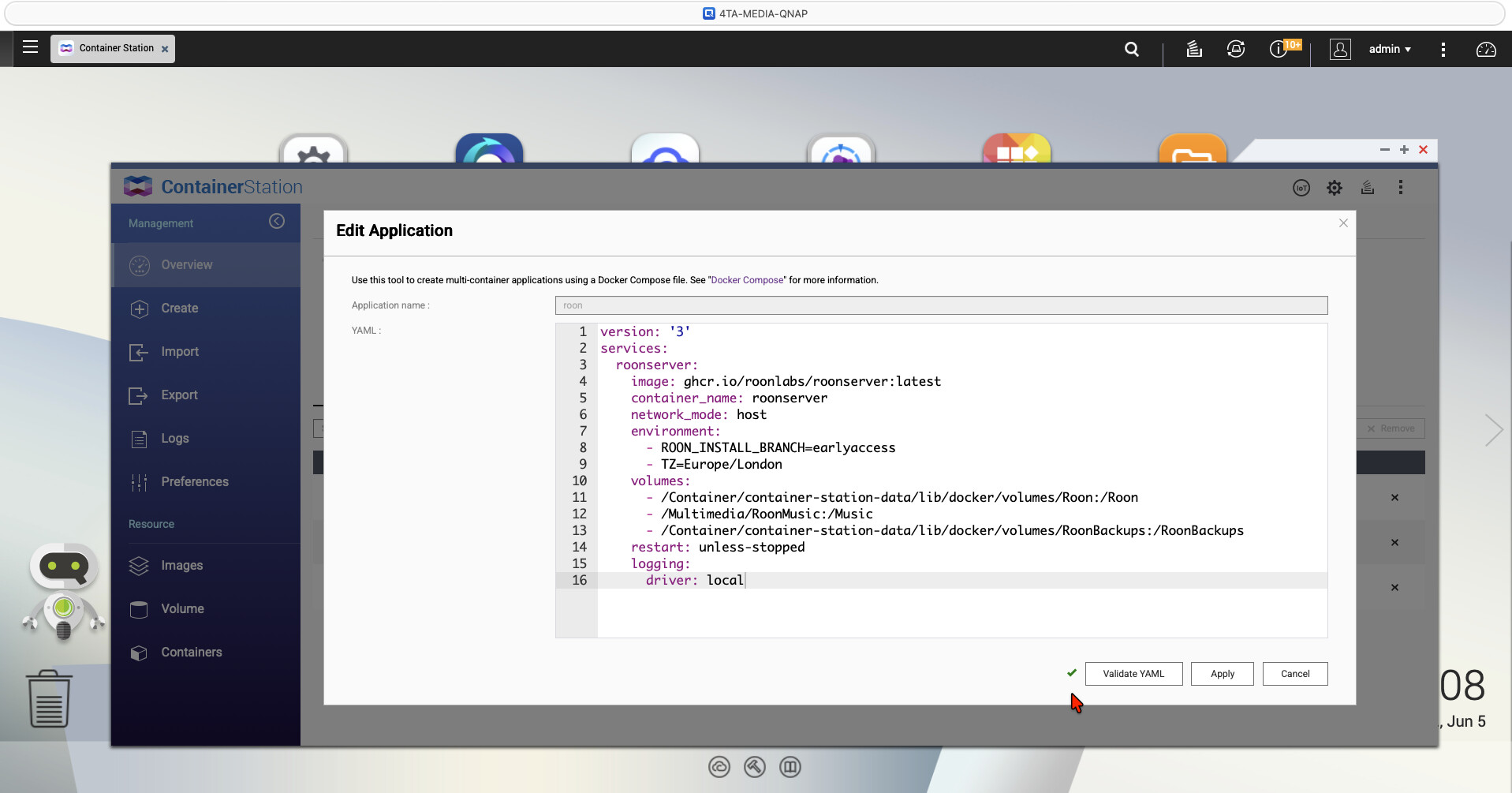

I created a new Roonserver App with the following YAML
version: ‘3’
services:
roonserver:
network_mode: host
environment:
  • TZ=Europe/London
    volumes:
  • /Container/container-station-data/lib/docker/volumes/Roon:/Roon
  • /Multimedia/RoonMusic:/Music
  • /Container/container-station-data/lib/docker/volumes/RoonBackups:/RoonBackups
    logging:
    driver: local
The YAML validates and the App was created.
There are no entries under the Container Manager/Volume tab - seems wrong to me (ie there should be entries for each of /Roon, /Music and /RoonBackups, no?

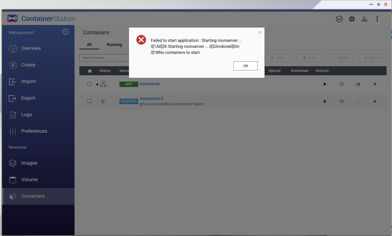

Roonserver Docker is running and I start the Roonserver App. It fails with same error message “No containers to start”. With just the Docker Roonserver running I tried to use a Roon client on my Mac to see whether it worked - it does not.
