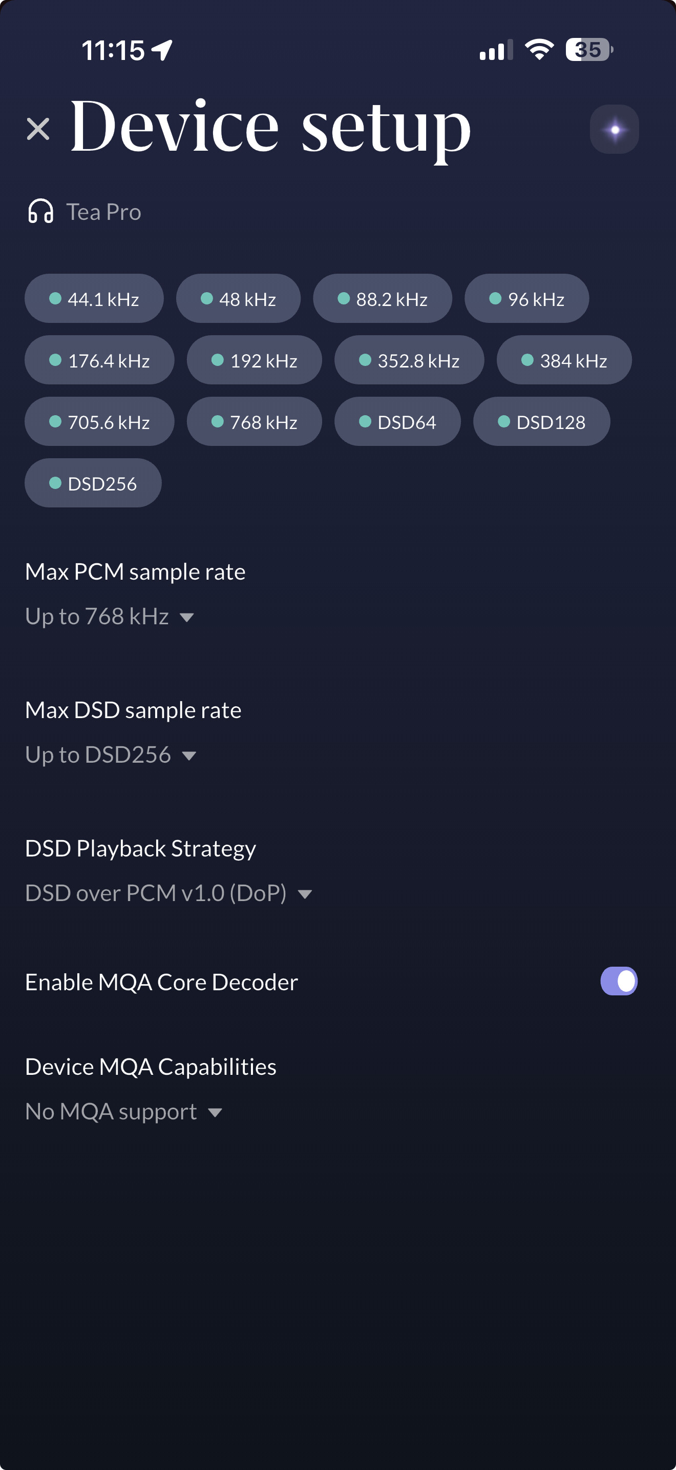

Using ARC in iPhone 17 pro max, iOS 26.1, a loud hissing sound when playing back DSD in DoP mode. If DSD is converted to PCM works perfectly. This issue does not happen in iPad Air M3

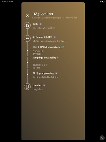

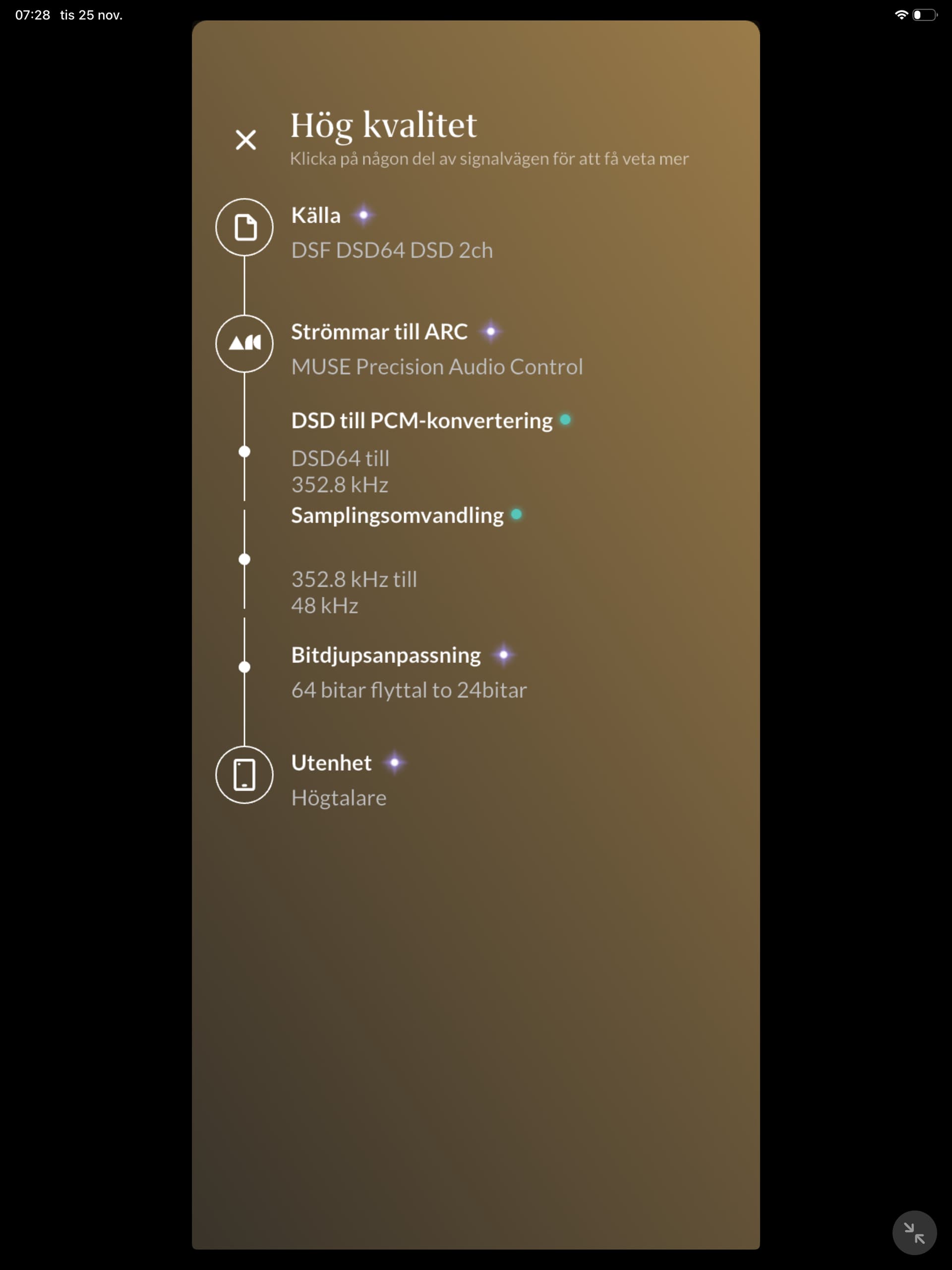

Show your signal path, both when you consider it working and when not:

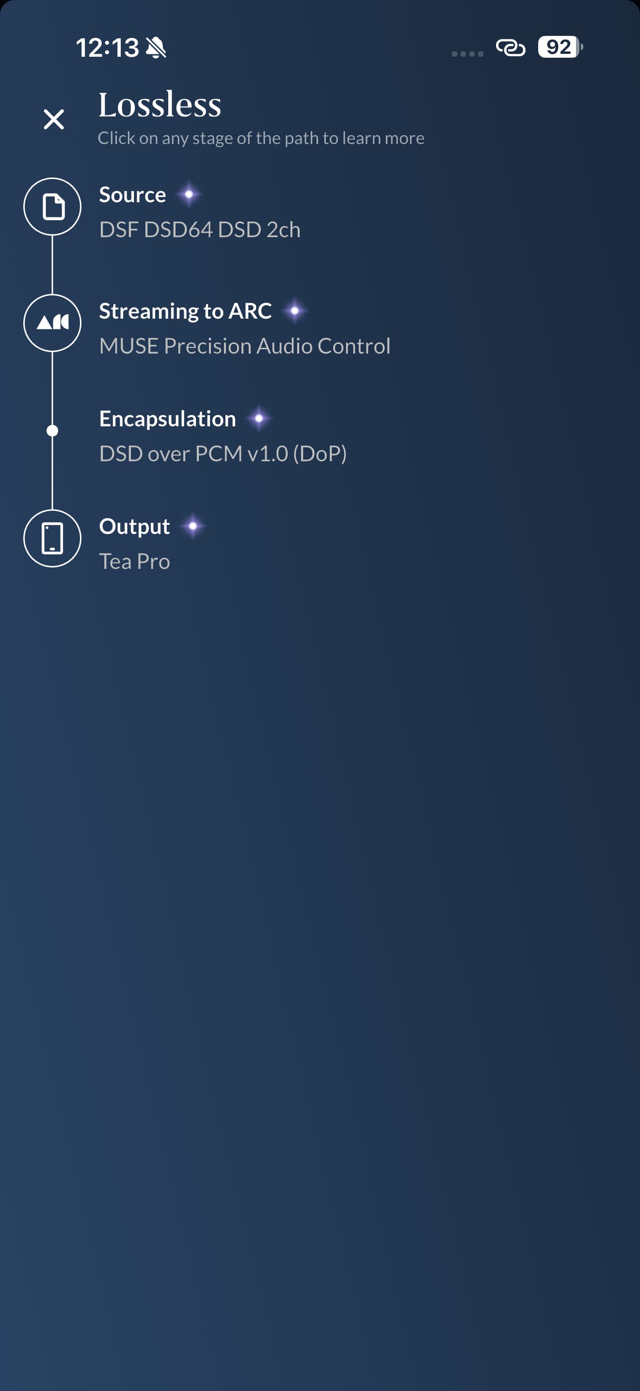

Hi Vadim,
Here is signal path…
I’m using Khadas Tea Pro USB DAC.
There’s no issue on playing back PCM from local storage or Tidal via Nucleus One. However when playing DSD via DoP mode, there’s background hiss with no music. If I convert DSD to PCM it is working fine.

  1. Have you tested enabling Exclusive mode with the DAC?
  2. Have you tested using a different USB cable?
  3. Have you tested using a different audio app on the device other than Roon?
It may also be worth checking Check iOS USB audio routing
Go to:
Settings → Accessibility → Audio/Visual → USB Audio Routing
Turn it ON, then restart the iPhone.
This forces iOS to treat your DAC as primary audio target and reduces resampling glitches.
Thank you! :raising_hands:
Thanks Benjamin, the setting force to ‘Speaker’ instead of Auto works.
