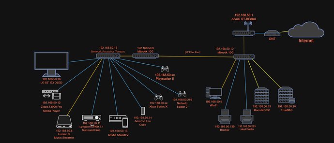

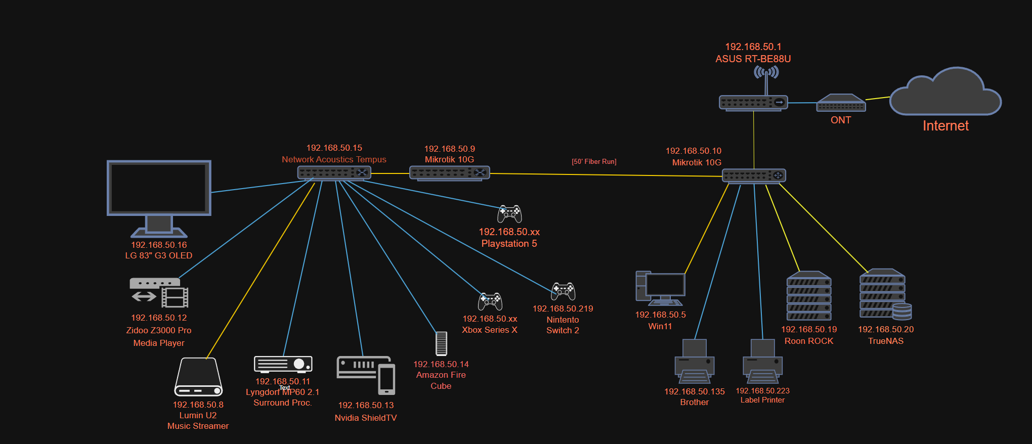

10G Fiber into home; Router = ASUS RT-BE88U; Switch 1 near servers is a Mikrotik CRS309; switch 2 behind A/V gear; Mikrotik CRS309 into an audiophile switch (3rd one, so this is definitely NOT the issue) NA Tempus switch and fiber into Lumin U2. Lumin hands the signal off via Wireworld Platinum USB to an Ayre QX-5 Twenty DAC.
