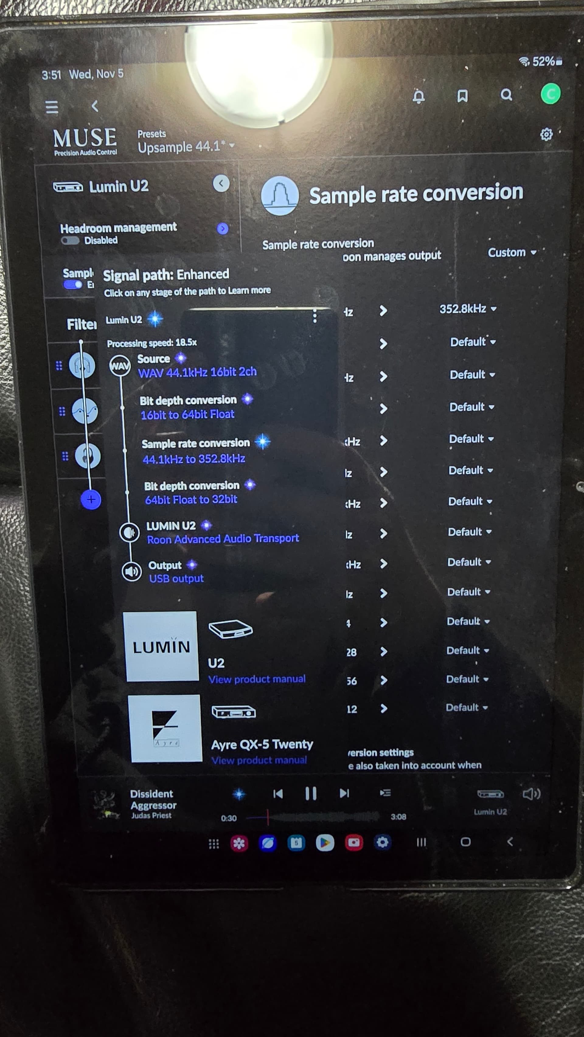

Yes, newest firmware installed in the DAC. Peter, did you upsample a 24/192kHz file to 768kHz? Again, it probably won’t happen immediately but give it time (several tracks).
EDIT: Another thing to try is upsample only 44.1 files to 706.6 and leave all others as-is. I shuffle my entire music collection 99% of the time. In my files are contained 44.1, 96 and 192kHz as well as DSD64. Again, randomly play back these files and only upsample CD rips. Just for the record, I have plenty of space, so I do not use FLAC. Only upcompressed WAV and dsf files.

Hi Peter. Thank you. How about just upsampling 16/44.1 to 705.6? I tested last night and it was great for close to 60 minutes. Then i got static. Looking at my Playlist, it happened after a 24/192 file and maybe three to four 16/44.1 tracks before the issue happened. So as i mentioned, please give it some time.

Ok, thank you Peter. Running 44.1kHz at 352 before I get ready for work. I suspect it will work as expected but you never know…
Played with 3xx upsampling for 3+ hours and no issues. I will try another USB cable this evening.
