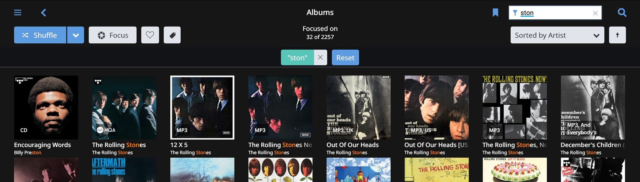

If they are in your library, then try using the filter funnel. In the album browser this will filter on title and album artist, and you can apply the usual browser sorting too.
And you can bookmark the result.

Don’t use the filter with search. Just go straight to the albums browser (Main Menu → Albums) and use the funnel from there.

I’m puzzled by this remark. The sort is explicit

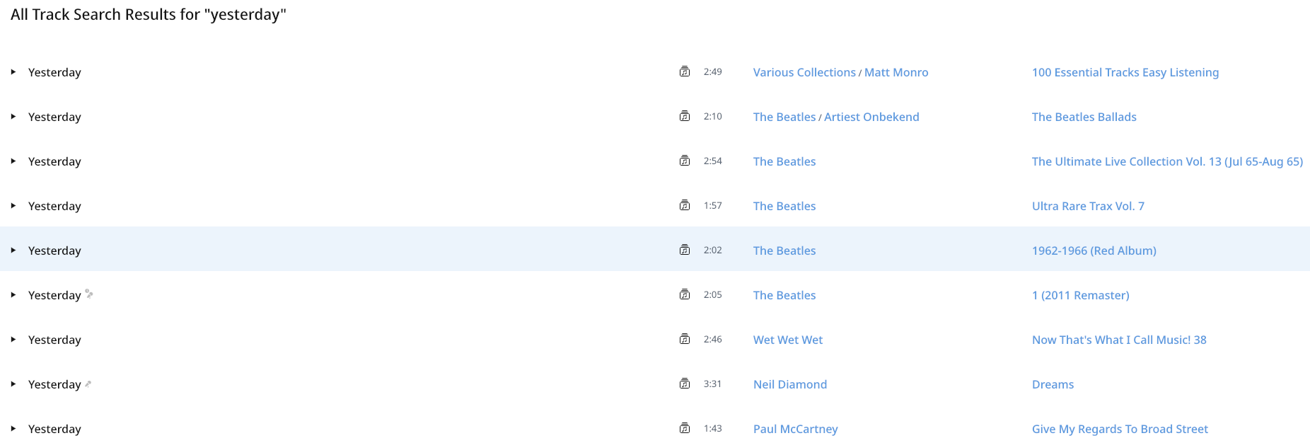

Apologies…forgot about the sort option on the screen (morning blindness!). The filter option is not present on the mobile GUI however so I am forced to use the search function when using my phone. Am I correct in assuming the filter works only for album or artist and not track? So when I filter for “Yesterday”, I only get the album titles so if I want a listing of all the tracks containing “Yesterday” and do a search, I will still only get a subsection of the full listing…and in a totally random sort…

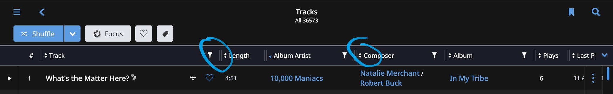

If you go into track view there are filter funnels for track, album artist, album. A filter of tracks with ‘yesterday’ pulls up a bunch of hits.
Oh, and the filters work together. So you can filter Artists for Beatles and Tracks for ‘Yest’ and I get one hit.
Yes, I’m afraid the phone does not have the full range of facilities.
Regarding tracks, there are filter and sort options on the (tablet and above) tracks browser

Thanks Brian…that’s very interesting as the sort columns you show in your screen grab are absent on mine (posted above). Is this an option somewhere??
TIA
DDJ
Ignore that…just realised I need to filter within the tracks browser! Getting to a stage now where I can almost ignore the search utility… :slight_smile:
And on the far right of my screenshot you see a little blue down arrow. This gives you more column fields.

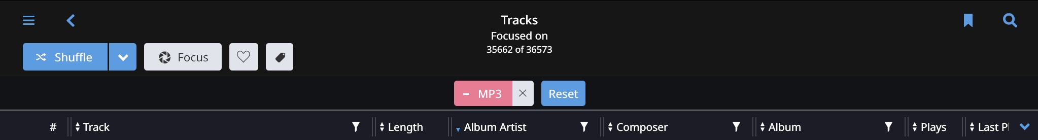

Picky time…is it possible to include BitRate in one of the sort options in the Tracks Browser as my music ranges from low quality MP3s at 128 to high quality FLAC.
DDJ
Hit the focus button and scroll over to format. Click away and remember once you have chosen a quality, you can click the green + to turn it red and make it an exclude.
Ahhh…of course…thanks again Brian…excellent service
