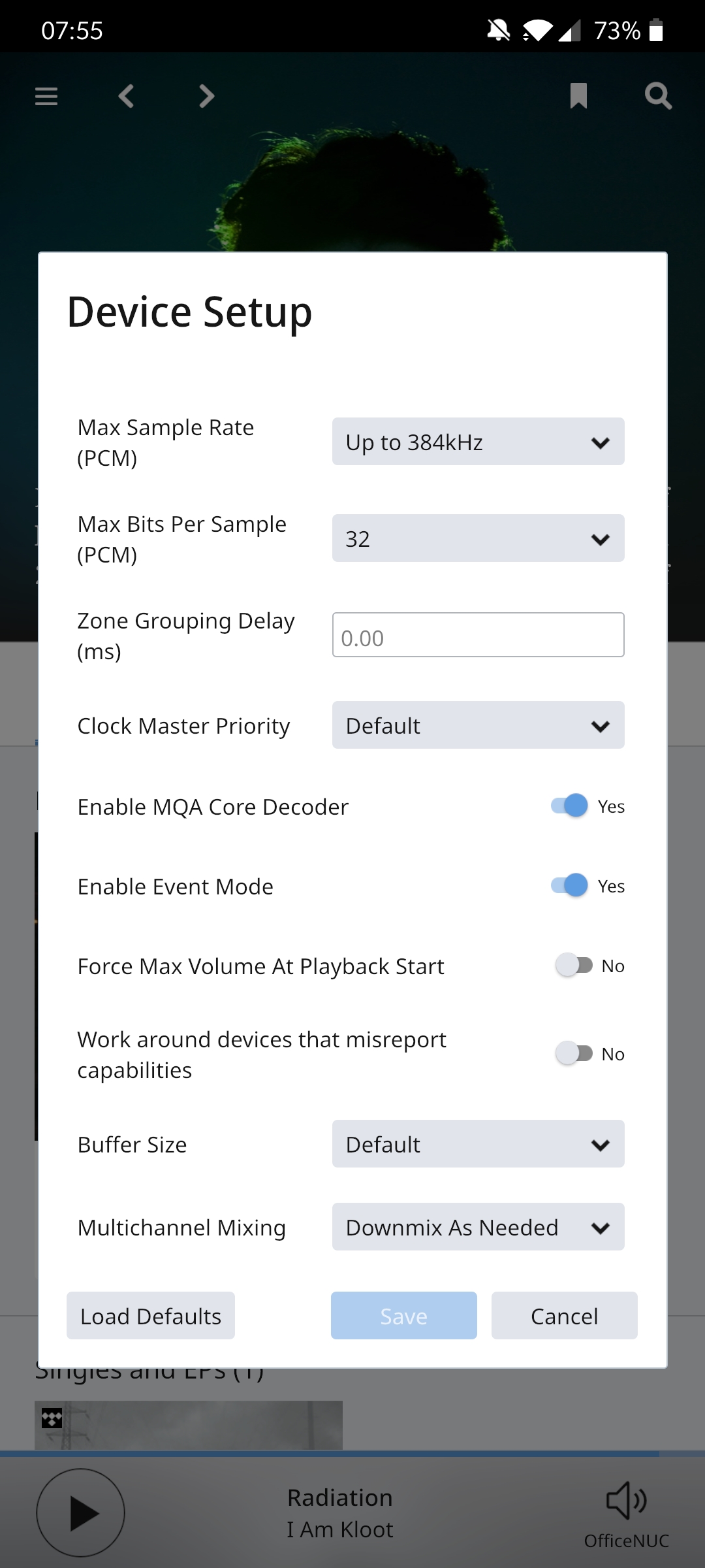

In the DAC setup all the DSP etc options are disabled, and it is set to Exclusive Mode.

Can you post the setup pages for the DAC?
Such as
Hi @Michael_Rowe2,
Please do share the screenshots of device setup when you have a chance, as it would be useful to help us understand this issue better.
You may also want to check the Audio MIDI settings to see if you haven’t accidentally set a max volume there.
My first thought was it was the midi settings on the Mac itself interfering. This is the most likely cause as the DAC won’t care where it gets its USB from and the levels should be identical.
