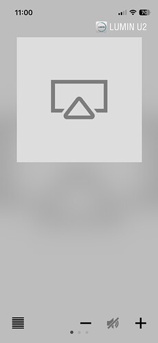

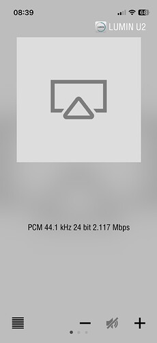

Hi,
Lately the Lumin app on both my iPhone and iPad stopped displaying sample rate and bit rate and also stopped displaying album cover when streaming from Roon to my U2. Sometimes it flashes the sample and bit rate for a tenth of a second. I attach a screenshot I managed to get of the short flash and a screenshot of how it normally looks like. Furthermore, in the Tidal album view on the iPhone, the top left icon (now showing the AirPlay icon) that previously worked as a fast link to the album cover view with controls is now inactive (same in iPad). I am on iOS 26.1 and iPadOS 26.1.

I have done what you suggest. It does not matter if Airplay is on or of. The Lumin App intermittently show (correctly) sample rate and bit rate when streaming Roon. Seems completely random, it shows up and then disappears. In any case, I need to have AirPlay enabled since it is a very convenient (and only) way of getting the TV sound into the U2 from my Apple TV 4K (and also with perfect lip sync).
