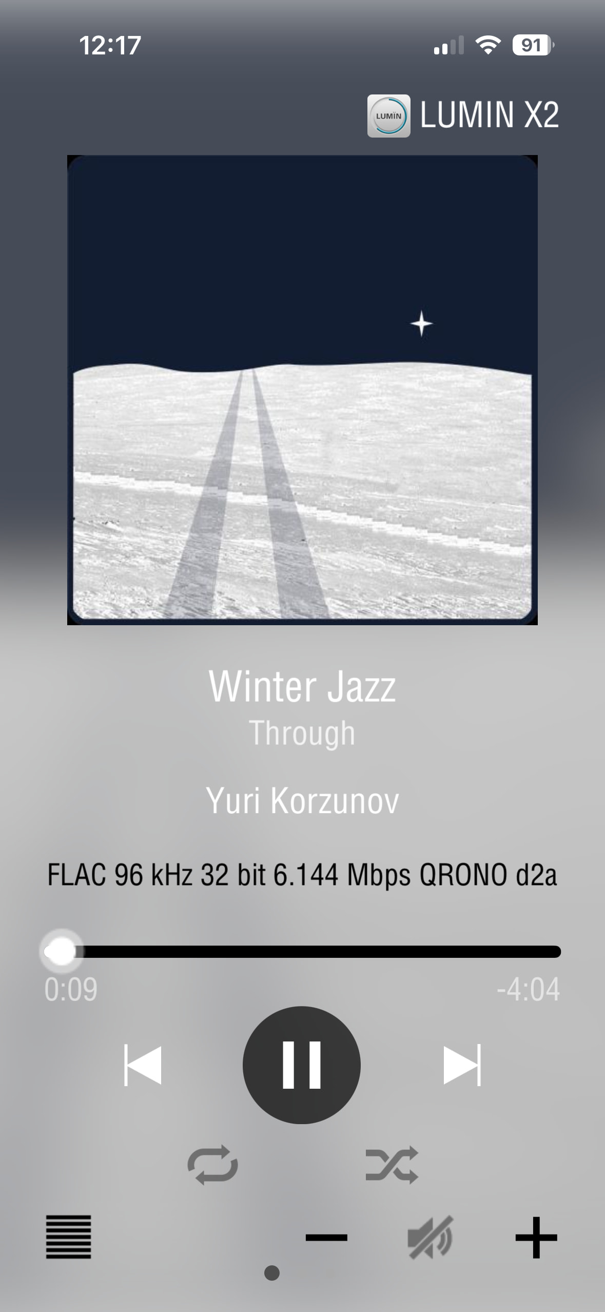

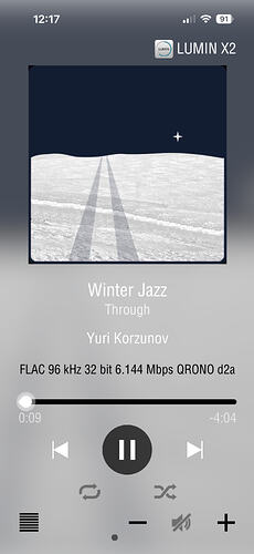

Experimental here means it has gone through minimal testing because I don’t expect any user to have opus files or real world recorded / mastered (not created specifically for testing) 32-bit FLAC.
I found a 32-bit recording and it plays nicely. Thanks @wklie !
My understanding is it was specifically created for testing and advertisement.
