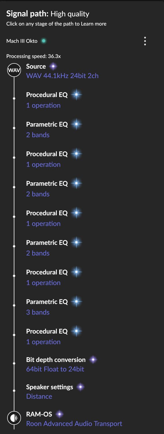

Hi, I’ve just received a new Lumin U1 streamer to try. For some reason, Roon seems to be downmixing 7.1 to 2.0 channels, even when the setting is disabled in Device Setup:
This downmixing does NOT occur with any of the other streamers I have here (Auralic, SOtM and iFi) nor any of the PCs I have setup as RoonBridges:
Strangely, Device Setup for the Lumin does NOT show the Channel Layout option, as it does with my other streamers and RoonBridge PCs.
