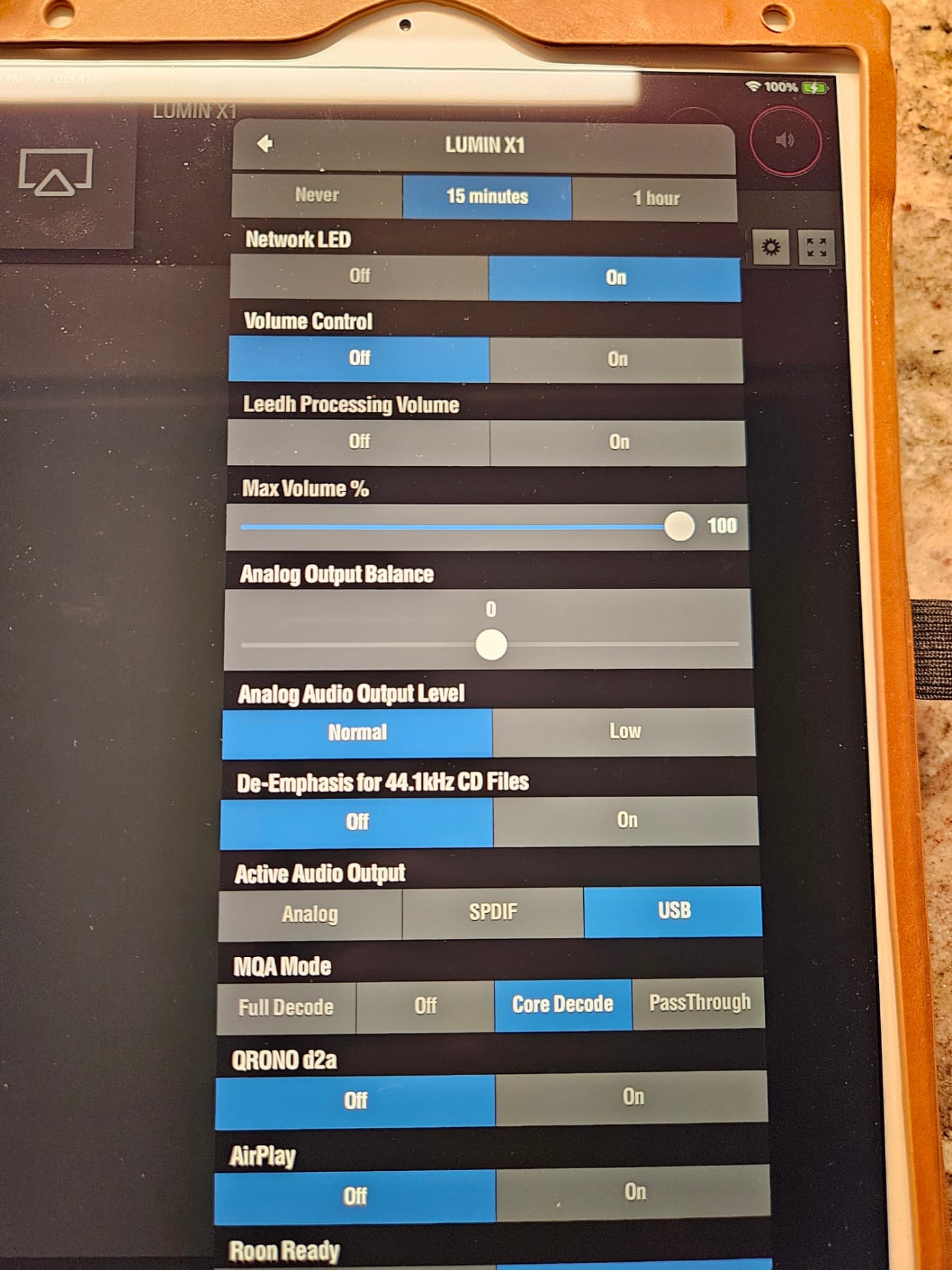

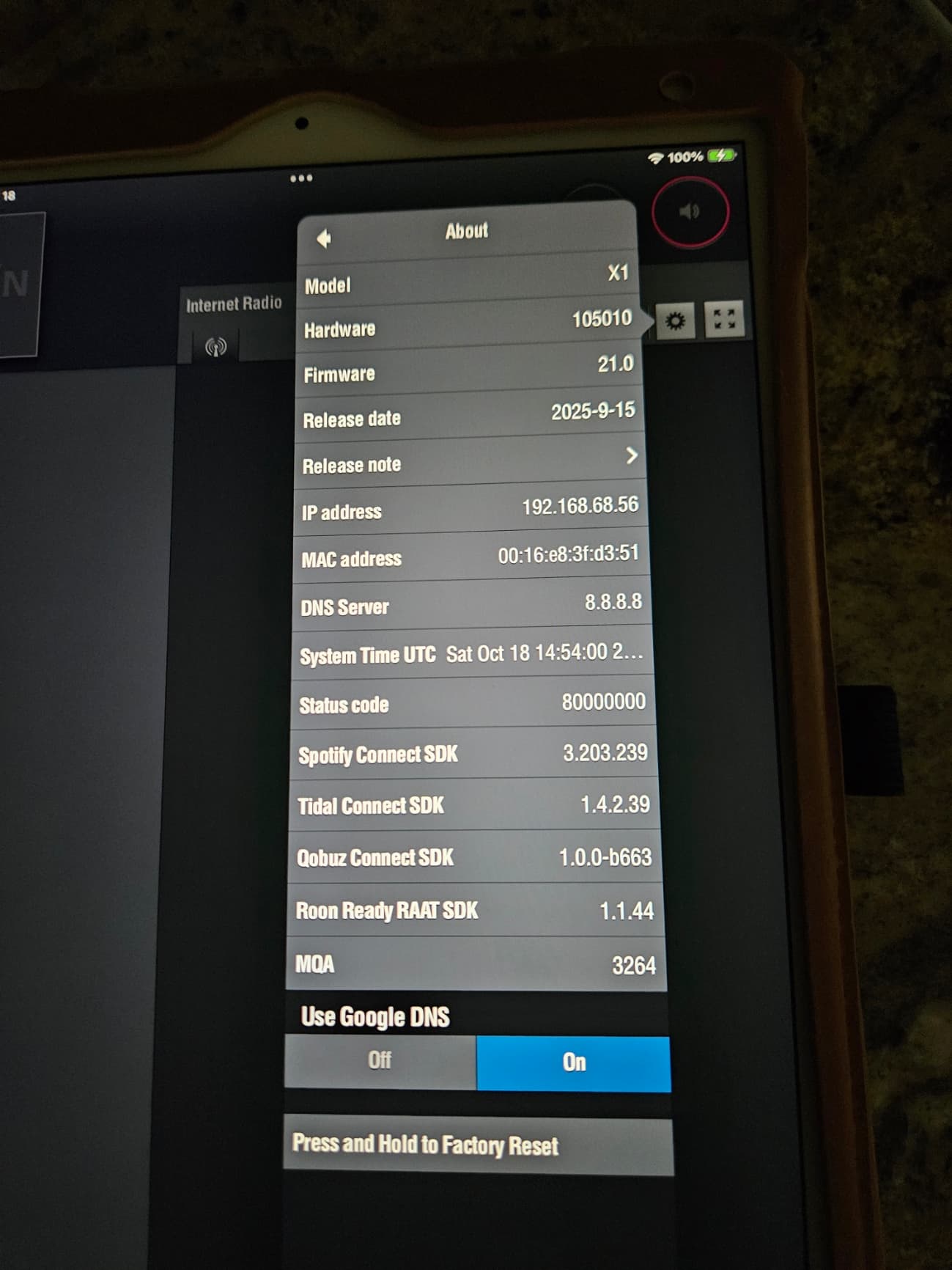

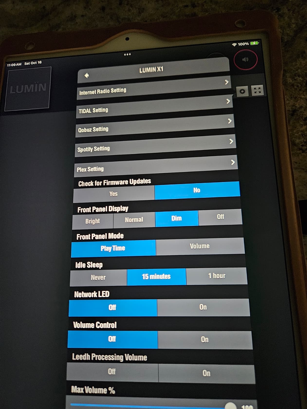

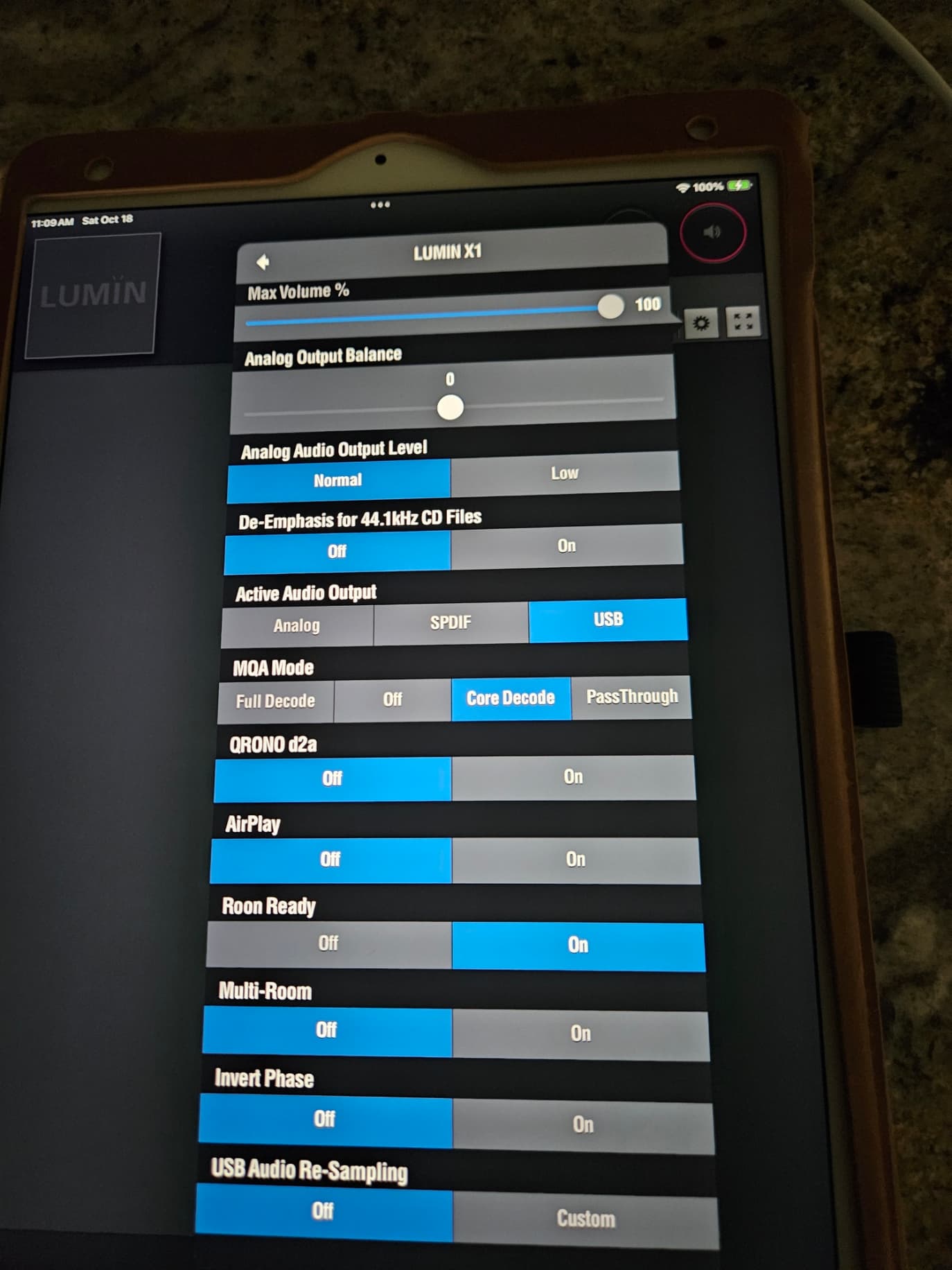

I have a Lumin X1 that I’ve just connected into my main two channel audio system. I’m connecting the X1 to my local music library via LAN and fiber optic connection. I use RoonServer as my player exclusively. Roon recognizes the X1 and is transmitting the music to it. However, in this system, I’m using the X1 as a renderer and then digitally outputting the music to my USB DAC (T+A PDP 3000 HV) which receives the digital signal when I’m using my SOtM renderer instead of the X1 (with the same Transparent Audio USB cable); so I know that the issue has something to do with the X1 not passing the signal to the T+A DAC.

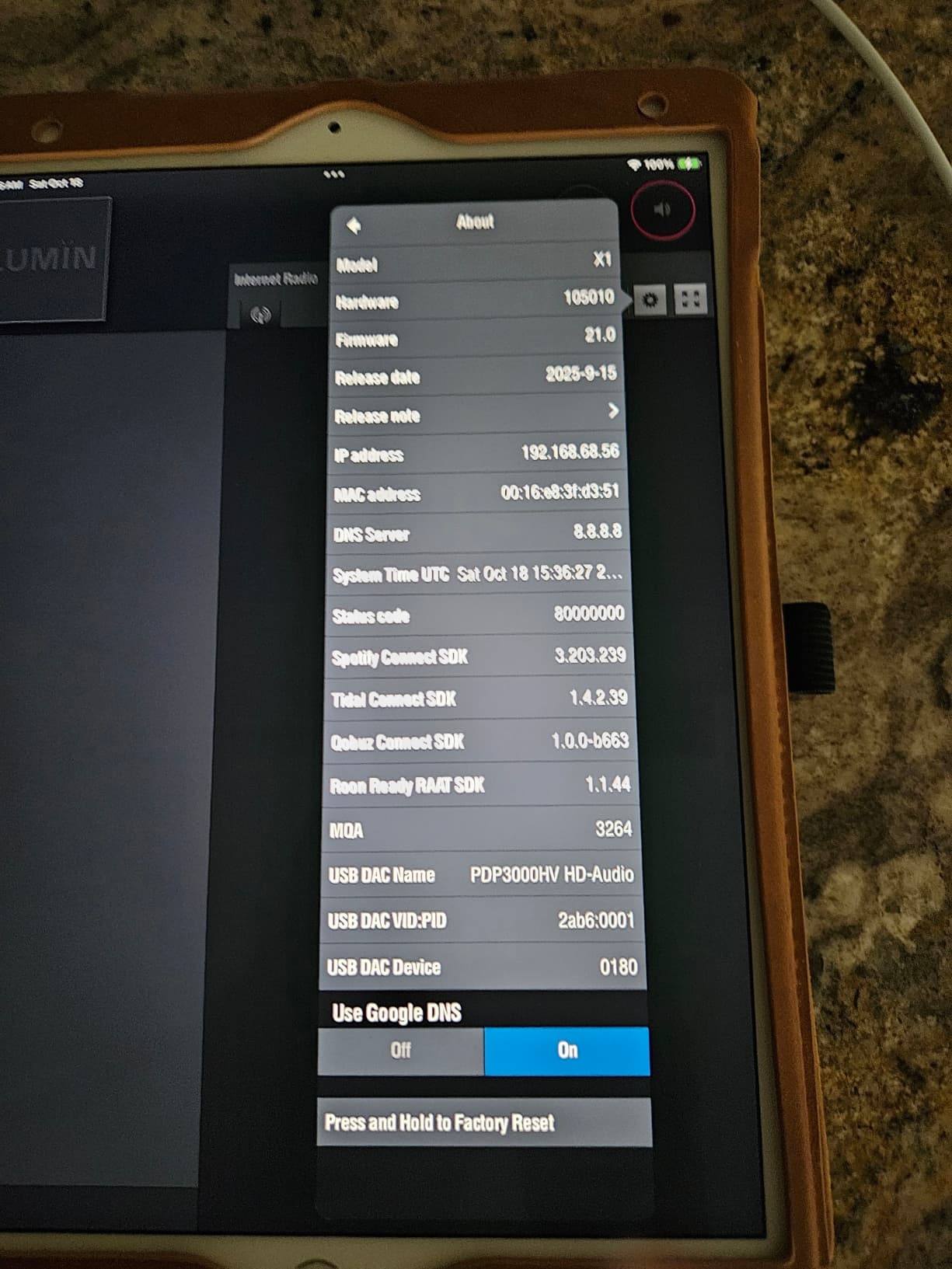

I’ve completed a factory reset through the downloaded Lumin app on my iPad; the Lumin app recognizes the X1 and allows me to configure it for USB output. Further, the settings in the app show that the T+A DAC is recognized on the same network. So I just don’t know how to access some setting so that the X1 will pass the output to the T+A DAC via the connected USB cable. Please see the attached images showing the settings in the Lumin app for the X1. The first image I attached shows the applicable
X1 device settings via the Lumin app; the second image shows the “About” output re: network and notice it recognizes the T+A DAC is in the network awaiting the digital signal from the X1; and the third image shows that Roon is recognizing the X1 (named Main System).

I see that you have set Lumin X1 to output to USB correctly, and the USB DAC information is showing up in About X1 screen. So that’s good.
  1. Make sure Lumin re-sampling is disabled (in order to avoid potential DSD incompatibility)
  2. Make sure Roon DSP Engine is disabled (in order to avoid potential DSD incompatibility)
  3. In Lumin app, set Roon Ready to disable, wait for 10 seconds, then enable it again
  4. Play some PCM music and see if it works

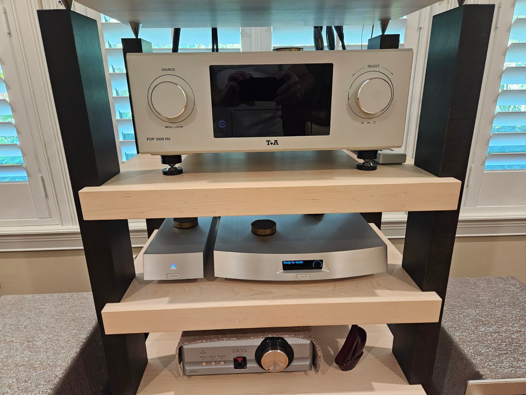

Thank you for your quick response. None of those collateral steps made any difference to the issue - being that the X1 is not passing USB digital output to the T+A DAC even as the X1 is configured correctly to USB output. For the avoidance of doubt, I’m not using the DAC of the Lumin in any way (i.e., no resampling - I play everything Native); ditto with Roon - I never use the DSP. Is there a way to determine why a software setting in the Lumin app would not be acted on by the X1? It seems that the Lumin app may not be adequately communicating with the X1. Alternatively, there’s a hardware issue with the X1.
FYI, I’m including and Image of the X1 and T+A DAC showing how the X1 is displaying the track and the T+A DAC is showing nothing (it normally displays the resolution of the file it’s playing).

Launch Lumin app, check that About X1 shows three lines of USB DAC information.

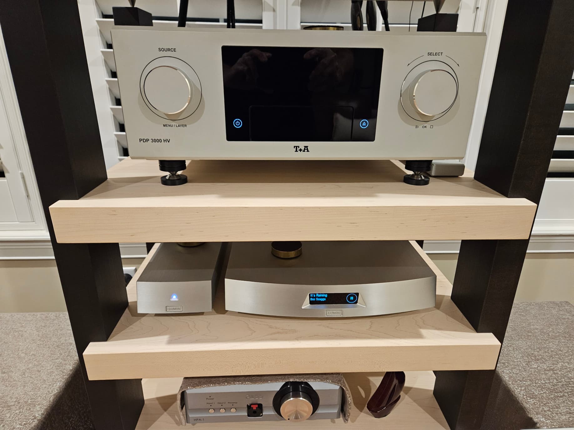

Image 1 shows the T+A DAC receiving power but not on and the USB cable not connected to either device and X1 display just prior to factory reset (awaiting music from Roon) and
Image 2 shows the network information (also reflecting no T+A DAC as there’s no connection between it and the X1 – the USB cable being removed from both)
Now, the X1 factory reset is performed and is successfully completed returning the X1 display so that it’s the same as in image 1

Images 3 & 4 show the post factory reset settings for the X1

I turned off the X1 and cut power to both the X1 and T+A DAC (neither has the USB cable attached)
I powered up the X1 then the T+A DAC (the X1 displays just as with Image 1 and the T+A DAC displays normal startup information)
I first attached the USB cable to the X1 and then the T+A DAC with displays a confirmation that it is ready to receive on the USB connection (incidentally, the T+A DAC utilizes for its USB receiver Amanero based technology and firmware, tweaked by T+A engineers to banish jitter, if that makes any difference to your thinking).

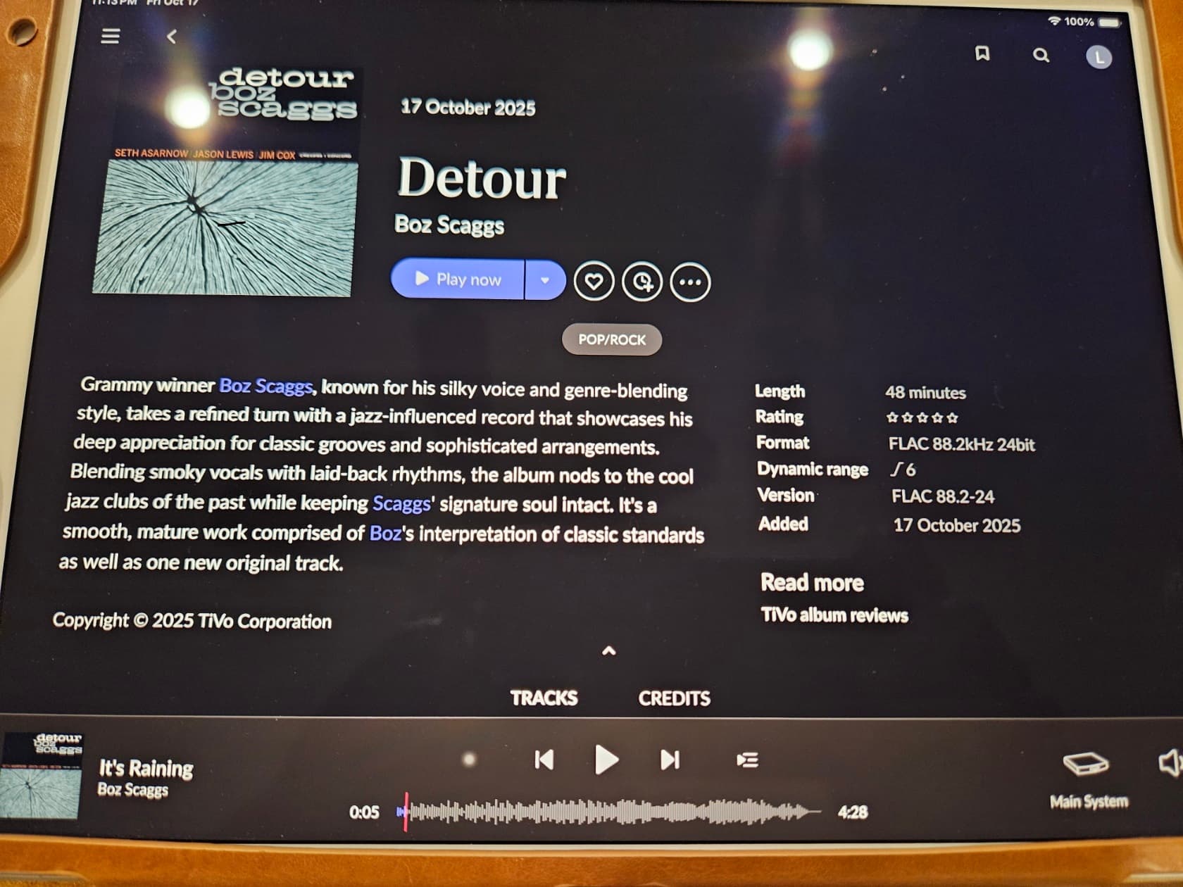

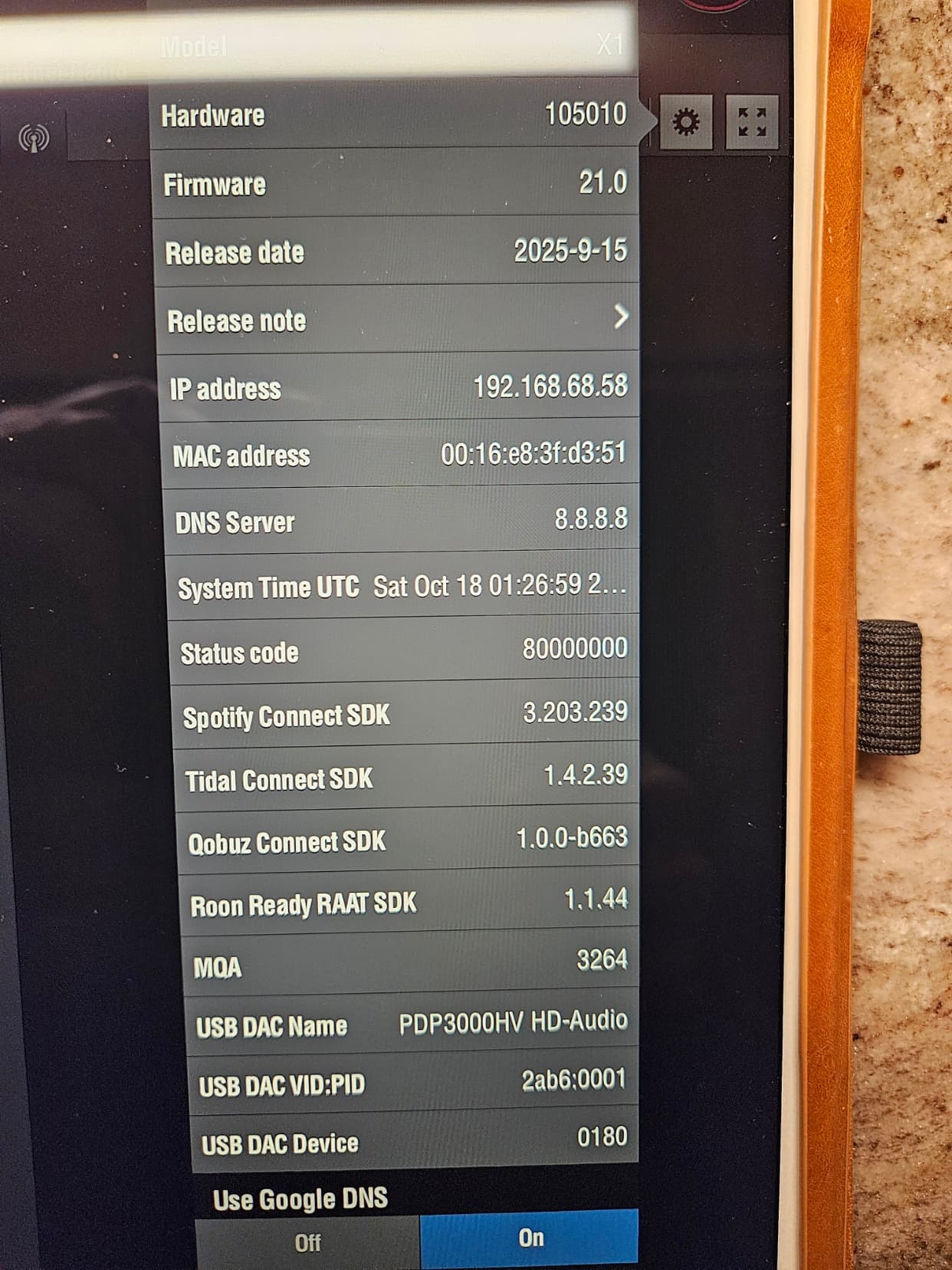

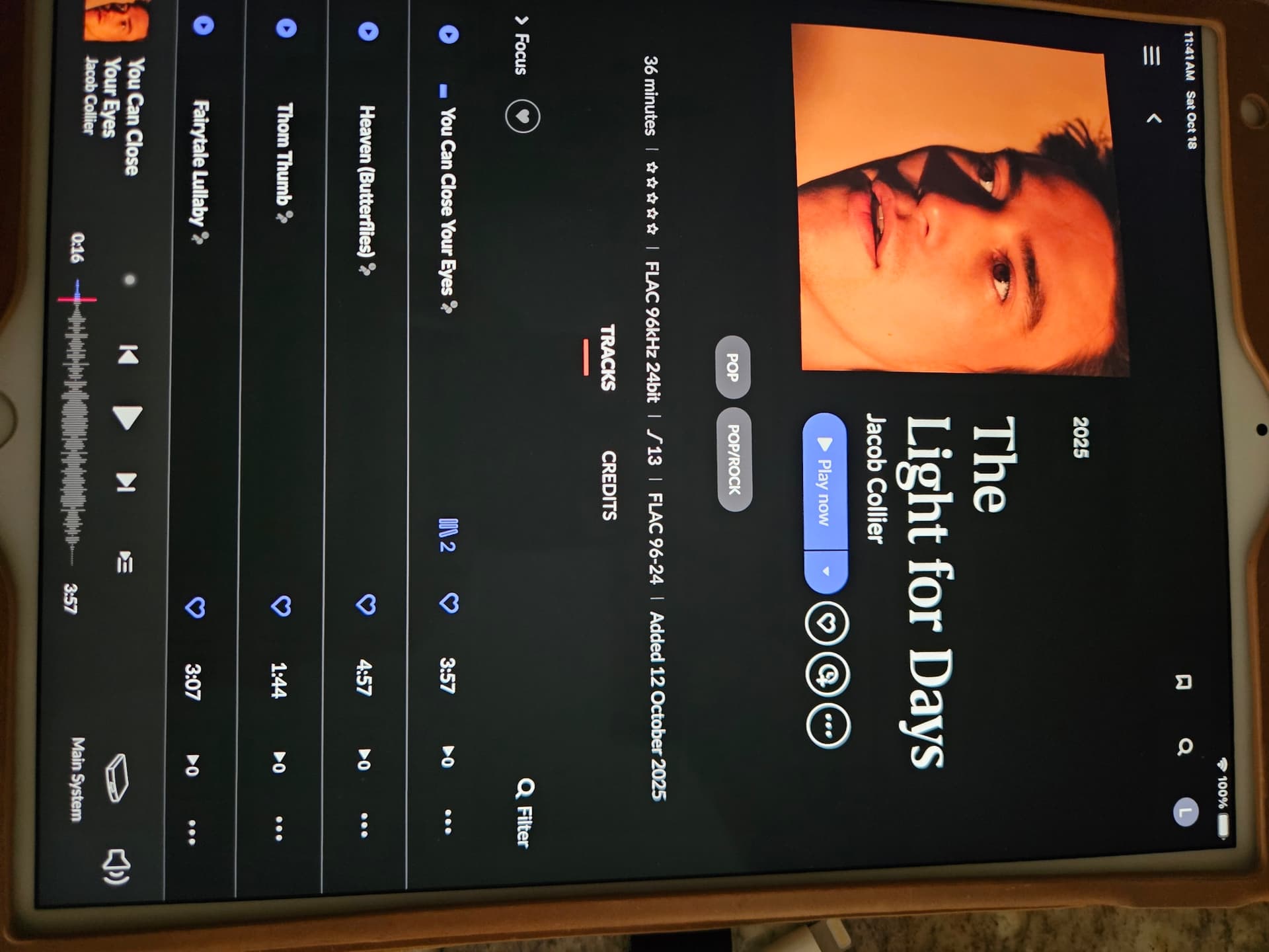

Image 5 shows the recognition by the X1 of the T+A DAC again as it did last night

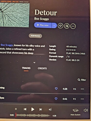

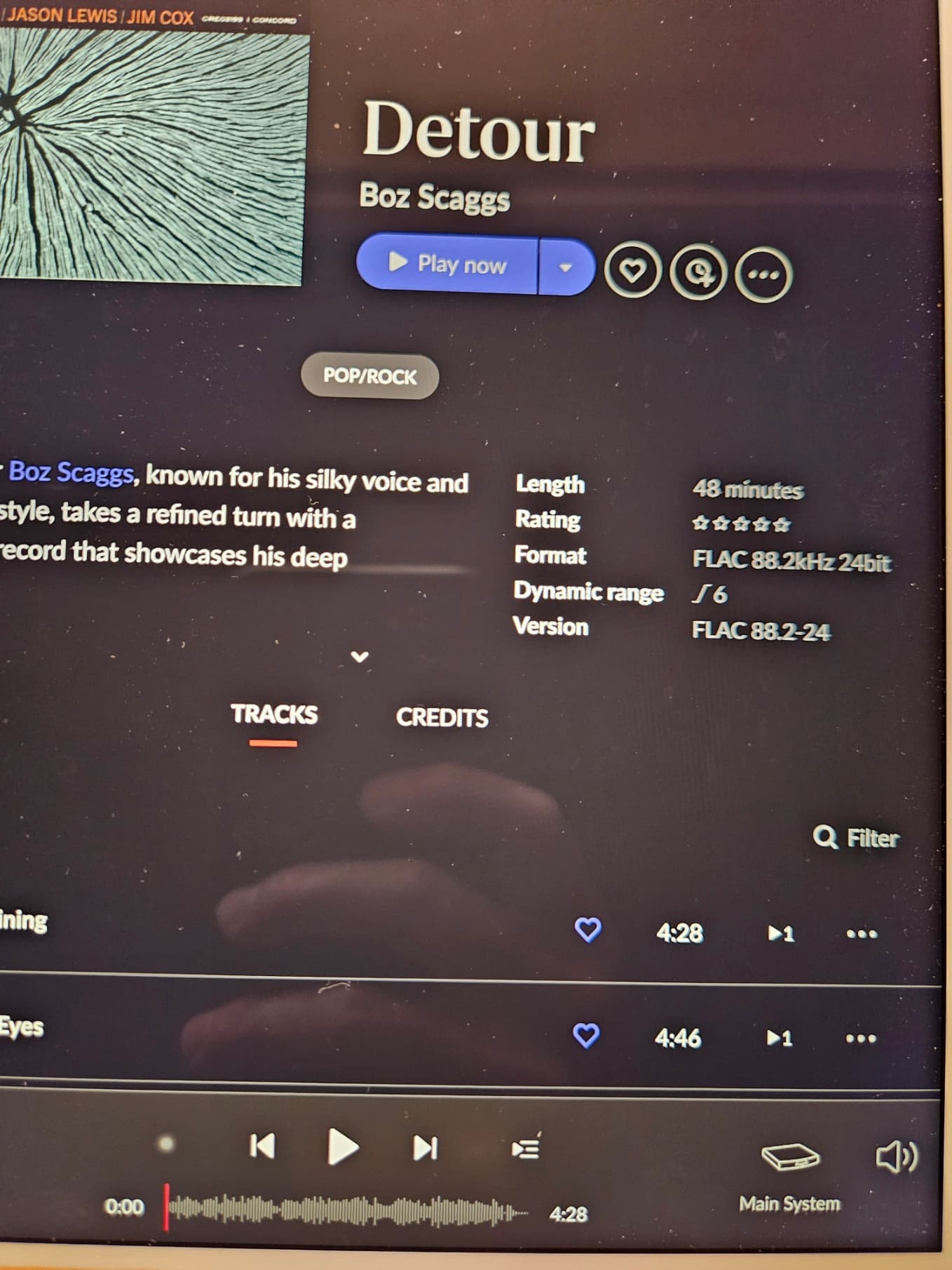

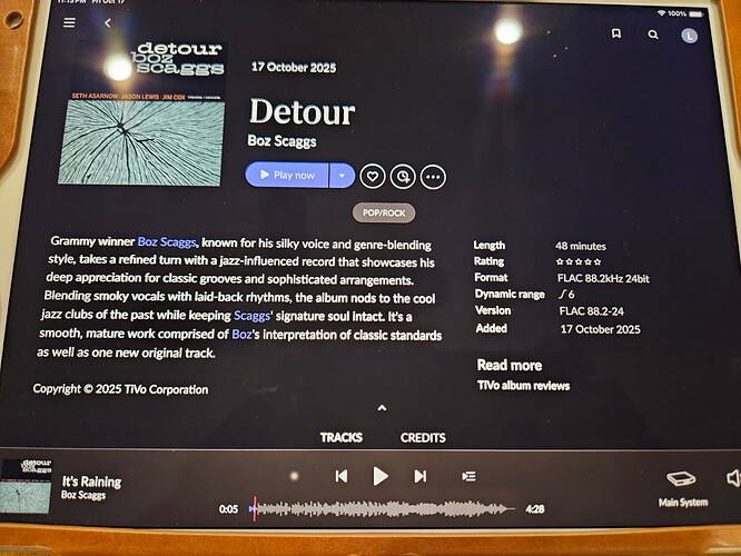

Now, I open RoonServer and Roon Controller to select the X1 “Main System” and select a track and press “Play”
Alas, no change!
Images 6 and 7 show both Roon recognizing and passing the music to the X1 (respectively); the signal however is not passing from the X1 to the T+A DAC

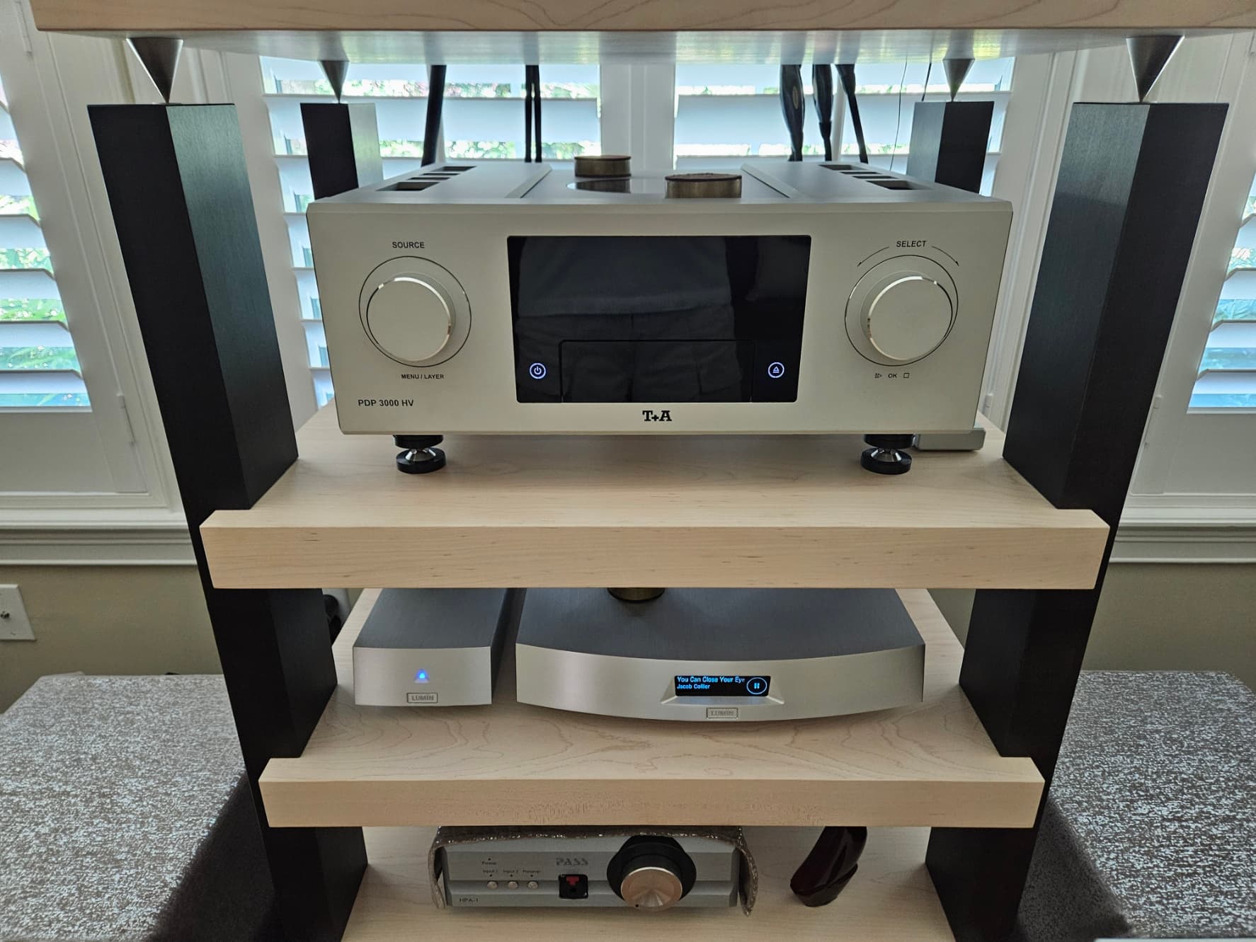

Lon…I hope you get your issues sorted.
If I may ask…who makes that rack of yours in the photos? It’s gorgeous…I was just wondering.

Bob, thank you for your compliment; it really is a beautiful rack! It is bespoke and was built by a former furniture maker here in FL who no longer takes on projects - he now sells globally sourced exotic hardwoods exclusively. Thank you, again!
Thank you for the reply, Lon. Congrats and enjoy!
