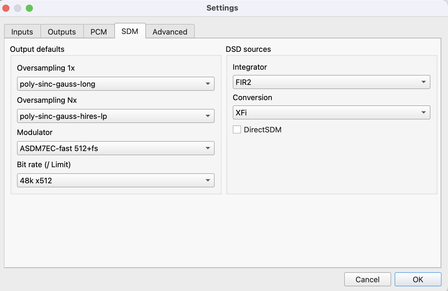

With the cheapest model Mac mini M4 I am now using this setting in HQ Player version 5.11.2

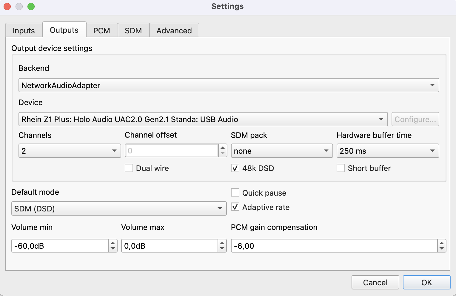

I also have dac correction enabled for the Holo Audio Spring 3 :slightly_smiling_face:
