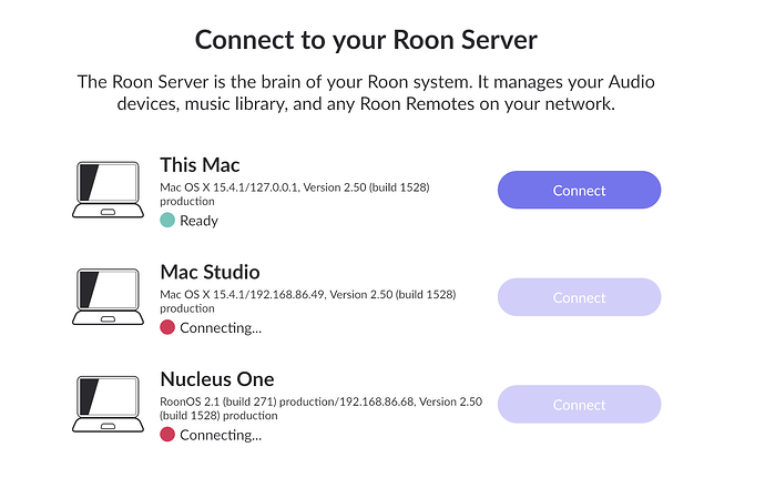

Hi. I use nucleus with my mac desktop. I also connect using my ios devices and a mac laptop. For some reason, I can connect with all devices except for my mac laptop. I have completely uninstall roon and all related components in my laptop, and still will not connect. It shows a build 1496 for the laptop and a build 1528 for Nucleus One and also 1528 for my Desktop Roon Remote. Please HELP!

Hi. Thanks! I did a complete uninstall on the mac laptop, and still loads build 1496 from a fresh install!! I have no idea why?
I finally got the laptop to run build 1528 from a fresh install. But still no joy!
Same netwrok as Nucleus but I will not connect!

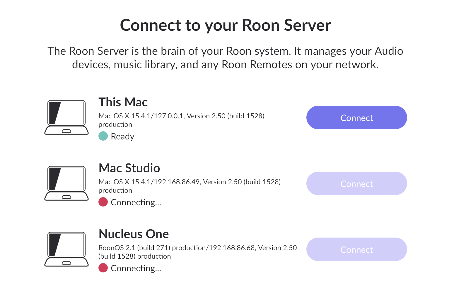

No, same situation. All my ios devices and my mac desktop connect perfectly. But my laptop fails to connect to Nucleus. See below…
Add images
Check firewall there was a user this week whose Roon Server permission was set off by a Mac update
Sounds similar
That did the trick!!! Many many thanks!!!
